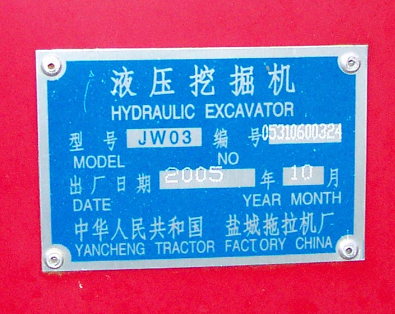

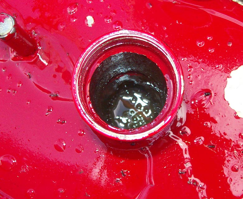

It's a 2005 JW-03 mounted to a 354. The pump is mounted on rear of tractor. I don't have a pressure gauge. I overfilled the tank yesterday afternoon to where the oil level was into the filler neck. I was hoping this would show any bubbles in the oil better and sure enough there are a lot. I have no idea if this is normal or not. It's a little tough getting a good picture inside the filler neck but even in this one you can see the bubbles. BTW, new NAPA hydraulic fluid. And after more checking, all cylinders running off the backhoe pump have reduce power. The outriggers won't lift tractor off the ground now. Thanks for any help. Bill

Well I would say you are not getting to full pressure. Air in the system can partially cause this. But a safety relief with crud in it, or that is set incorrectly can also cause this. One source for air would be the supply line from resovoir to pump. IF this is loose, or has a bad seal/O-ring in one of the O-ring face seals(ORFS), the pump could be sucking air along with fluid. The JW-03 by design will induce it's own air. The return line to the tank probably goes thru a banjo fitting on yours? If you take out the bolt and look at the hole down the center of the bolt, you will probably find that it is around 1/4". Ths causes the fluid to re-enter the tank in a high speed straight stream. This high speed stream shoots into the fluid in the tank at high velocity and mixes in air. It also shoots right across the top of the tank, and this whole air filled mess rolls down to the intake strainer to be drawn into the pump. Go try and fill a water bucket with a high velocity straight stream garden hose nozzle and you will see what I mean. When I was troubleshooting my BH filter installation, I saw pressure spikes as high as perhaps 100PSI on that return line caused by that restriction into the tank, so a garden hose into a bucket will give you a good idea what is happening. A sign of air intrusion is the pump making noise. Does your pump have a squeeling noise to it, that gets louder as you put it under load/work the BH controls? If so, you probably have air in the supply fluid. That pump should be as quiet as the main pump up on the tractor engine. My pump made noise untill I fixed the high velocity return into the tank. I just described that here, and the gentelman I described it to also shows how he did the same thing.
http://www.tractorbynet.com/forums/chinese-tractors/143897-backhoe-first-time-3.html
Probably the easiest way to check the oil pressure and where the safety relief is set is to sample one of the working ports on the valve. Do you have a hydraulic shop around? Most I have seen have metric adapters. The JW-03 hoe uses hoses with ORFS connections. The valve however has straight metric threaded outputs. The manufacturer uses metric to ORFS adapters comming out of the valve body to attach the hoses. I think You need a 18MM X 1.5MM to female NPT adapter and a hydraulic pressure gauge good to at least 3000PSI. Take one of your ORFS adapters along to make sure you get the right size. Put the gauge into the adapters NPT end. On the valve identify a port that feeds a particular cylinder, so you know exactly what lever to move to send fluid to that hose. Disconnect that hose and put the hose end in a bucket(don't loose the O-ring). Remove the metric-ORFS adapter from the valve port, and screw in your adapter and gauge to that port. With safety glasses on in case there is a leak, start up the tractor and engage the PTO/backhoe pump. With everything up to speed, work the lever that will send fluid to the port that you put the gauge into. If you get it backward, the cylinder will move and fluid will flow into the bucket:) If you get it right, nothing will move but the needle on the gauge. The pressure you see on the gauge is the pessure that the safety relief on the BH valve is relieving at...
