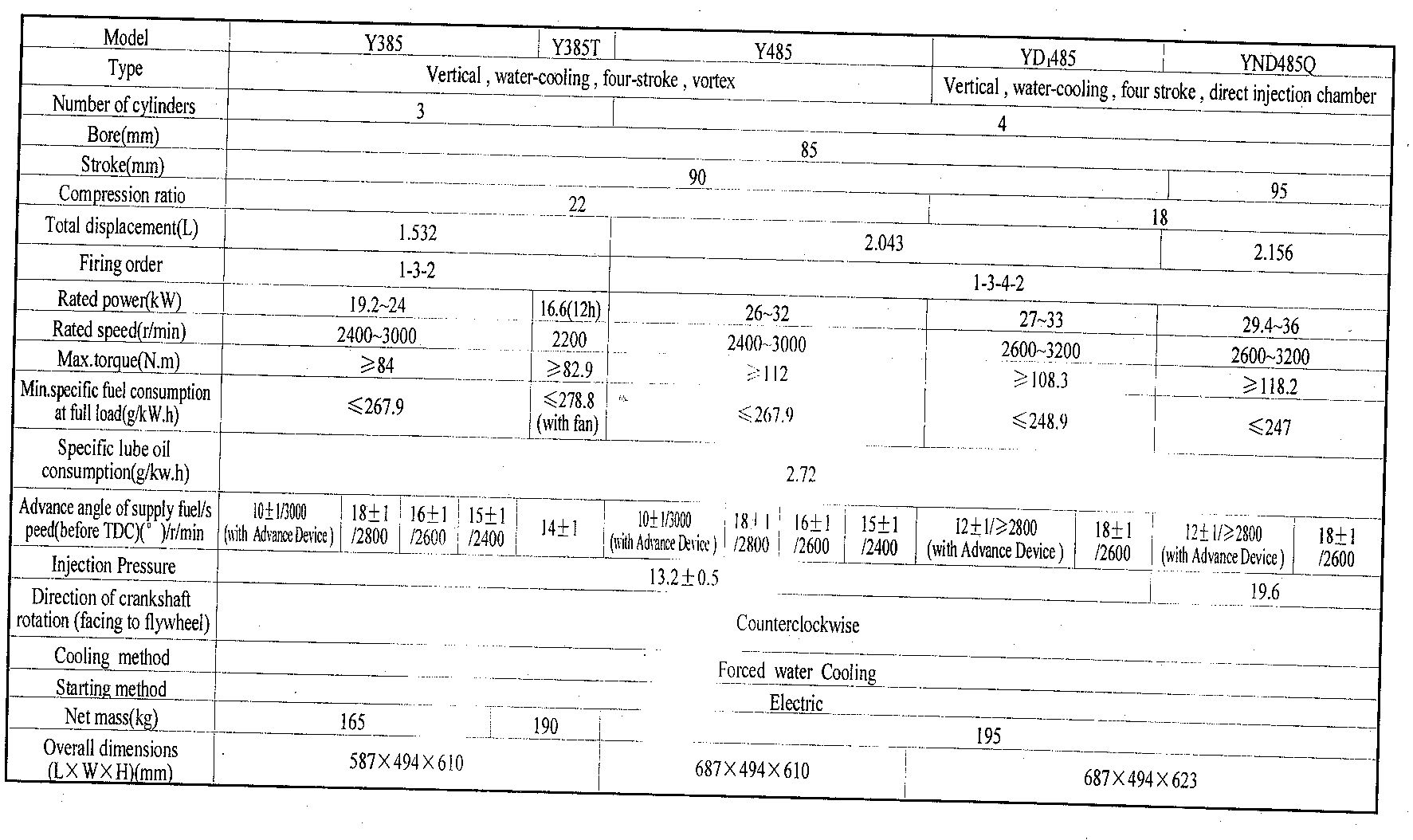

It's best to verify in your own manual first, cuz there are quite a few variants of the Y385 engine (marine, generator, pump, tractor, etc). Injection pump timing varies from 10 to 18 degrees BTDC, and they run between 2200 and 3000 rpm depending upon application. I'm guessing you have the 2200 rpm Y385T (for tractor) variant. If true, my book says pump timing is set at +14 BTDC (+/-1 degree).

This 284 was purchased new in July 2002. Does that mean it is probably set at 14 degrees?
/ Jinma 284 injection pump timing #7
If your book is the same as mine, then yes. I'd use the 14 degree figure.
