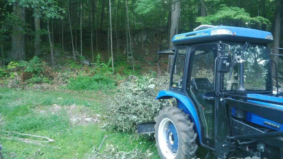

Good day all,
I was wondering if anyone would have suggestions on trying to gain more stability to avoid / decrease the chances of rollover, a wider rear tire? / dual wheel? my Jinma is a 254 with full cab and I find it could be very easy to tip over and I have several places on our property that have angle driveway.
Thank you all for your comments / suggestions

Before you do all that, I would just try widening the stance of the tires and see how you like it. Here's a thread that discusses it in detail:
Rear Wheel Width Positions | CHINESE TRACTOR WORLD FORUMS
There are five possible widths for the rear tires.
That said, I have to say that when I got my Jinma I thought it was incredibly tippy, I still remember driving it the first day and wondering when it was going to capsize. I read about widening the tires and realized I should do it, but somehow never got around to it. Somehow over time I got used to it, and it doesn't seem nearly as tippy any more. It helps that I have a pretty good sense of where the limit is. I was driving it today and went right into a small sideways hill, and I thought to myself that eight years ago I never would have gone there. So they're not as tippy as they feel at first, you might just get used to it.

Thank you Quicksand will review that link, do you have a cab like mine on your tractor? I think this makes a huge difference top heavy feeling and I almost tipped it over on a slope no more then 20% that was a scary moment I'm sure I would not have been injured but the windows would have broken on impact for sure...
/ Jinma 254 to decrease the chances of rollover
Good evening all, just a quick message to say thank you all and Quicksand well i did what was said on the link you provided and wow wow what a difference BIG THANK YOU... Blueberry runs like a champ :)

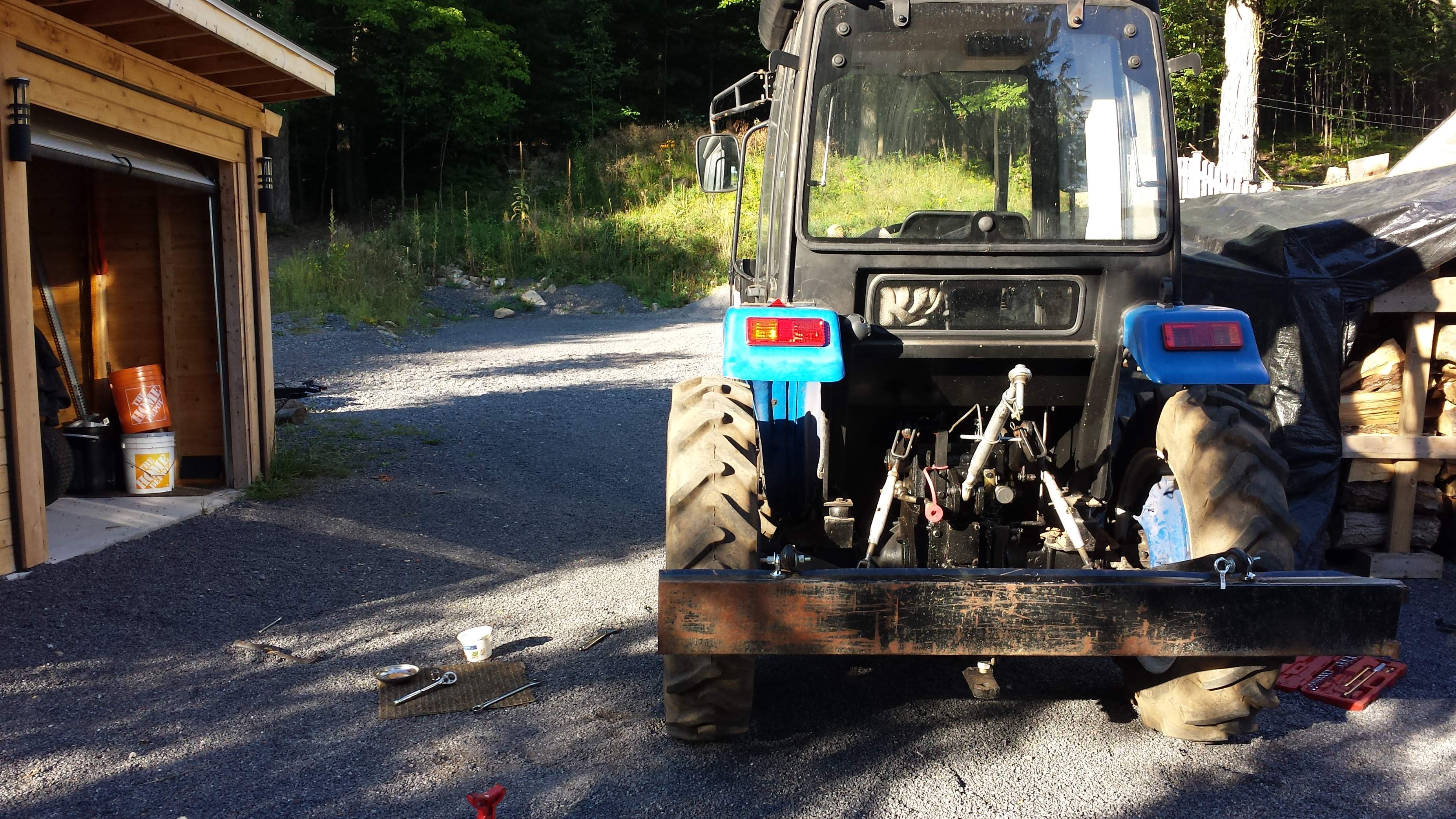

I agree Btown, how would be a good PSI for hose size tires ? rating on the tire is not always perfect one would think with a lower pressure decrease once again tip over right ? updated pic attached 20150827_180710 (2).jpg
/ Jinma 254 to decrease the chances of rollover #11
I agree Btown, how would be a good PSI for hose size tires ? rating on the tire is not always perfect one would think with a lower pressure decrease once again tip over right ? updated pic attached <img src="http://www.tractorbynet.com/forums/files/chinese-tractors/438978-jinma-254-decrease-chances-rollover-20150827_180710-2-jpg"/>
I meant adding a fluid to your tires, mostly the rear ones. Most people are using rim guard (beet juice) since it is non toxic and not corrosive. I assume up there in Canada you will need fluid that does not freeze. Water would not work. Some people also use a water antifreeze mixture and the old time favorite is calcium chloride with water. Calcium chloride will eat your rims, it must go in a inner tube in the tire and watch for leaks. Loading tires will add weight down low and at the back of the tractor making it more stable. Just don't try to move the tire and rims. They will be very heavy.
