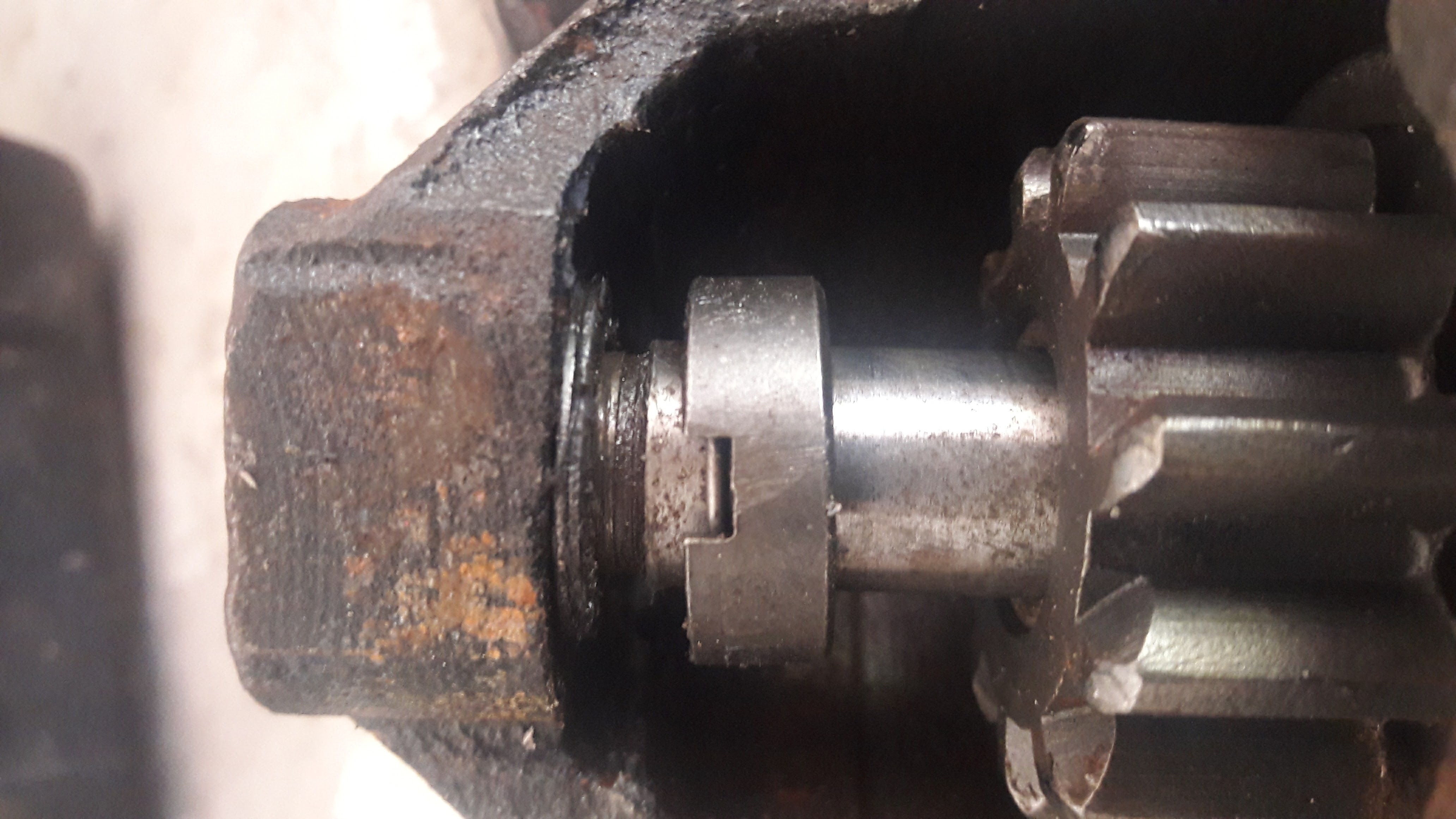

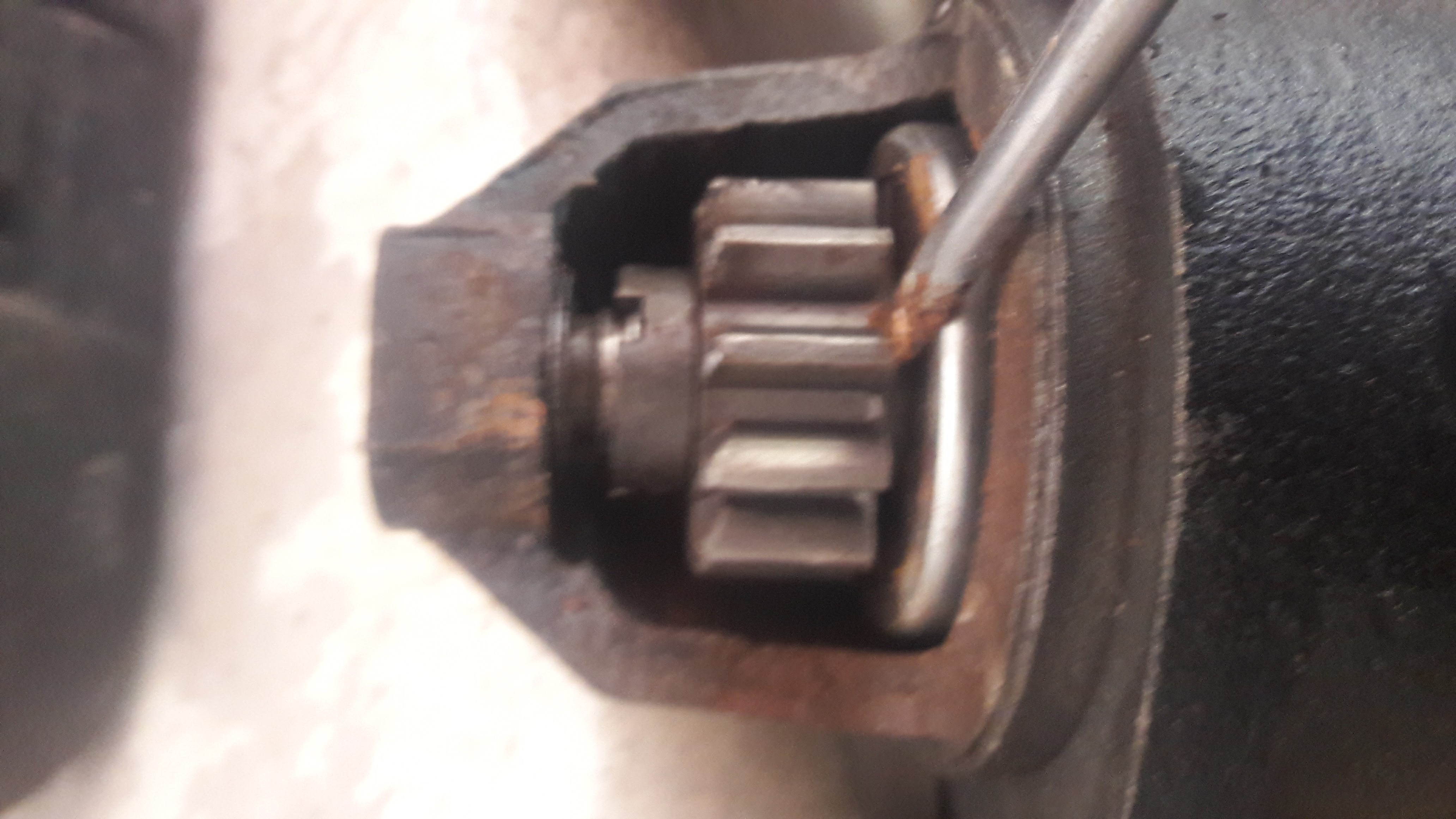

I can't be 100% sure it's the right starter, but I trust the supplier that it is. It's tough to take measurements on it, but it seems like the new starter has about 1/4" less travel than the old one. Is that enough to make a difference?
Here are pictures of the new starter. Should the shoulder of that shaft be pressed flush, or does that not matter? Everything look right?
/ Jinma 254 Starter Troubles #10
IMHO, 1/4" is quite a bit, others may disagree. As well as the travel, check and make sure the nose piece is the same distance in from the mounting surface to make sure the gear is in the same place
/ Jinma 254 Starter Troubles #11
Like Mike said previously, the ring gear have tooth with rush almost all the with of them. We can see only 1/8 in of pignon contact area, add the 1/4 in of missing travel and you get full engagement. If you still use it this way you will need to split the tractor for a new ring gear soon.

Last update here since I got it going. It turned out to be the wrong starter. Got a replacement and she starts right up.
/ Jinma 254 Starter Troubles #13
Glad you got it running.
The wrong starter was starting to spin, just when the pignon was close to engage in the ring gear tooth. The selenoid should energize the starter motor only when the Bendix pignon is mesh in the ring gear.
