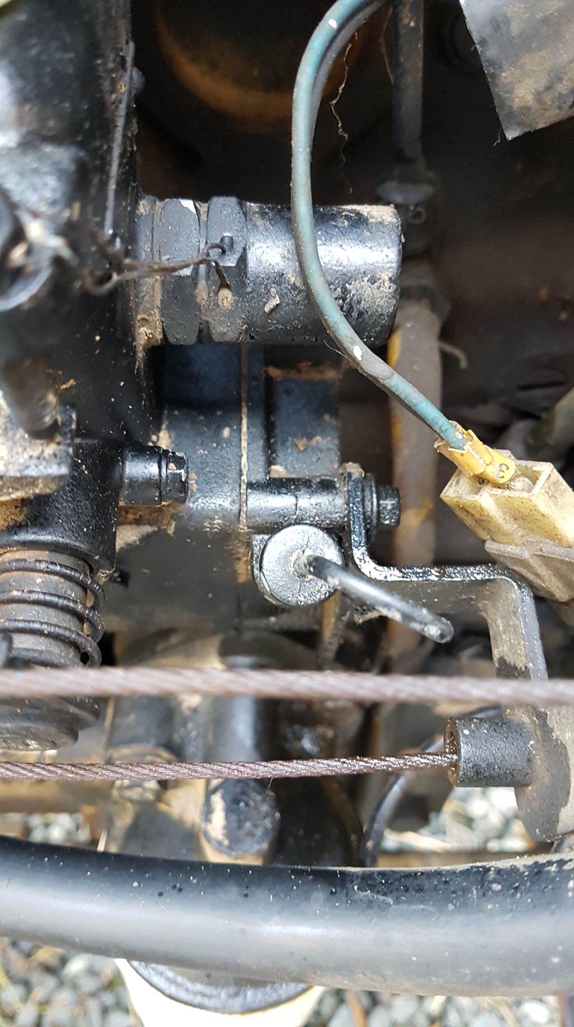

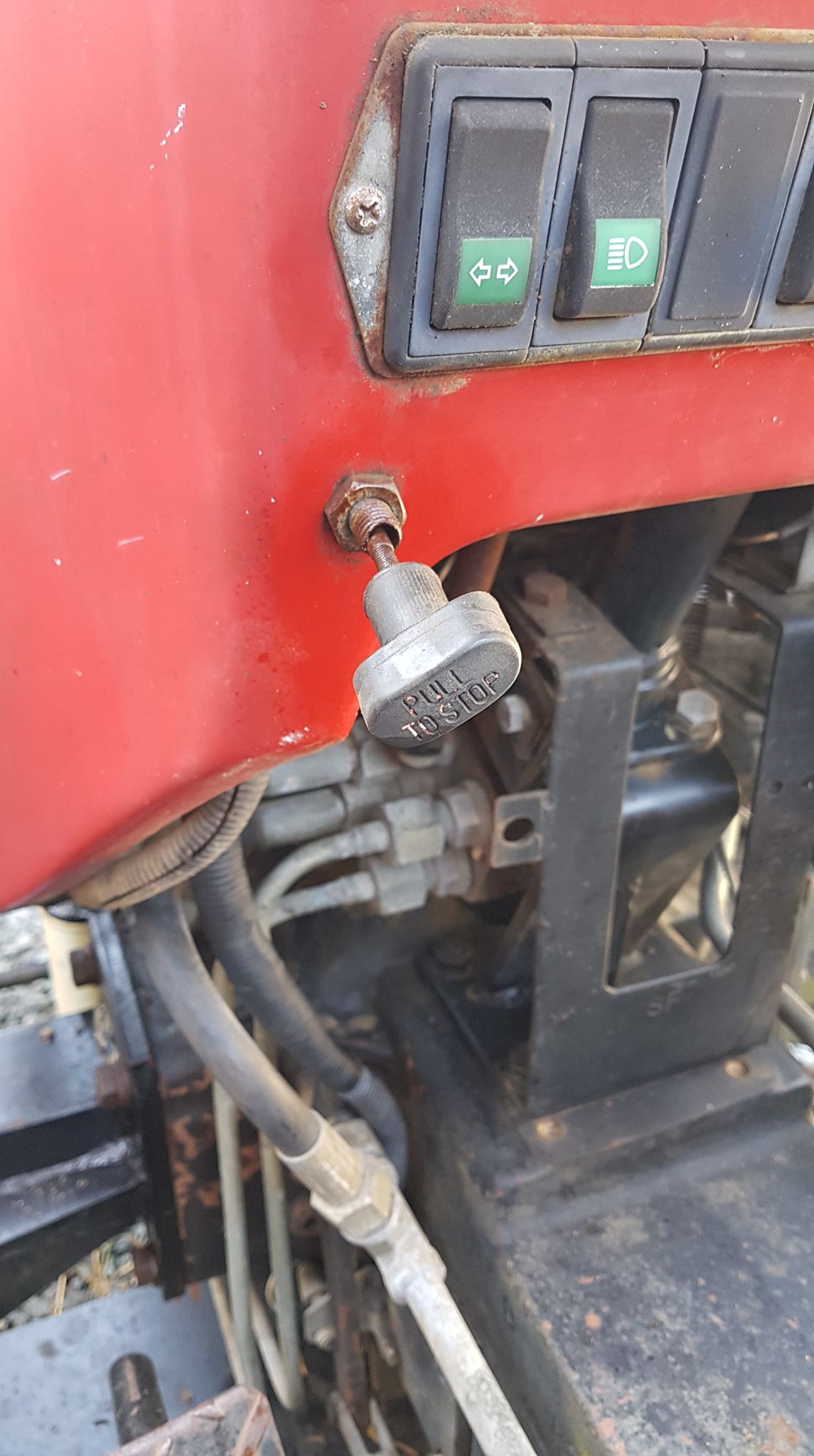

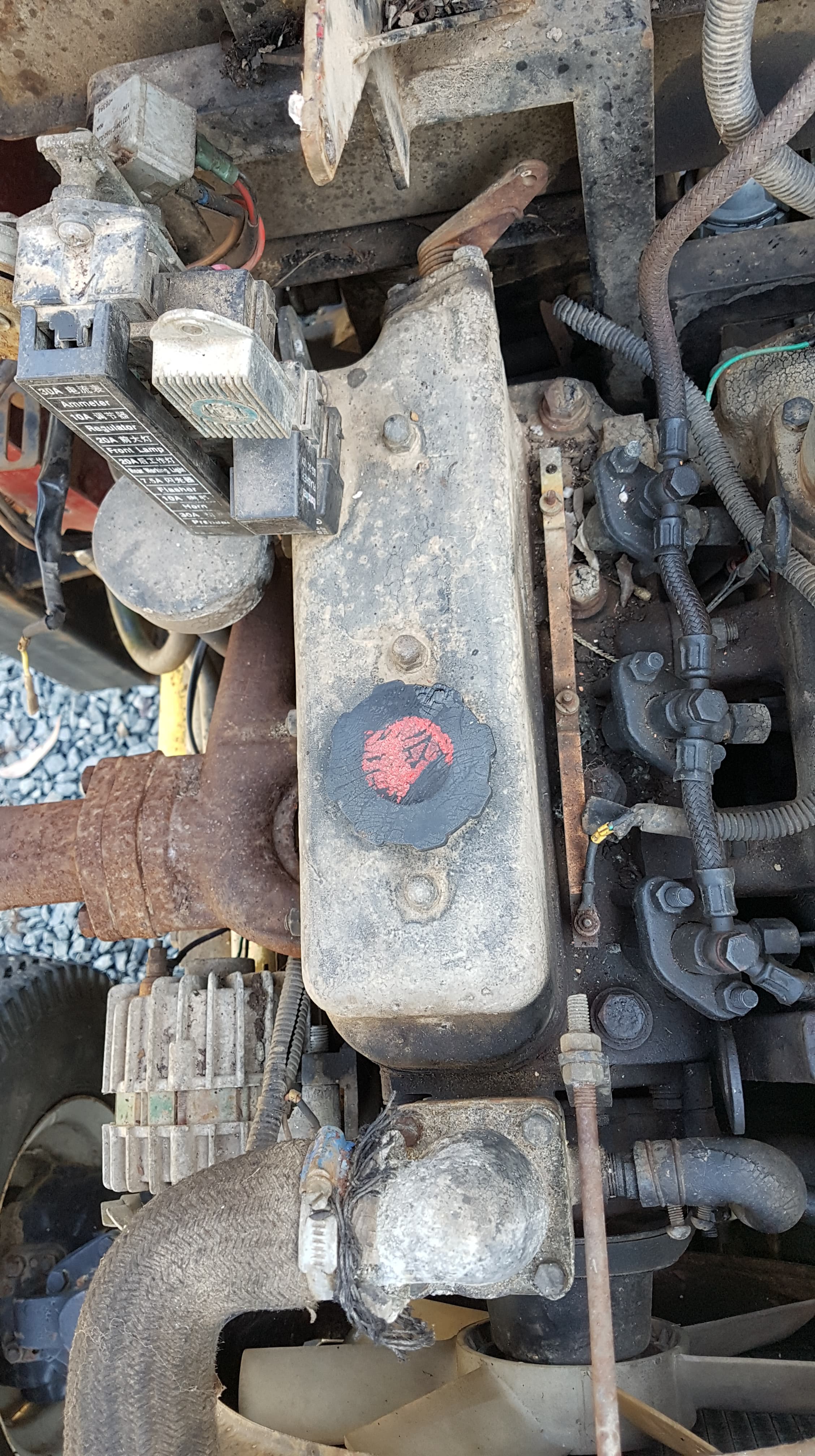

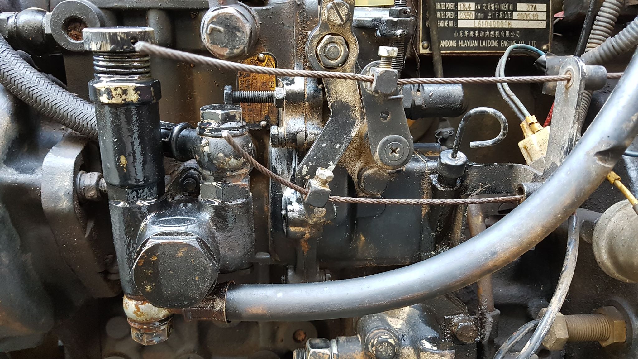

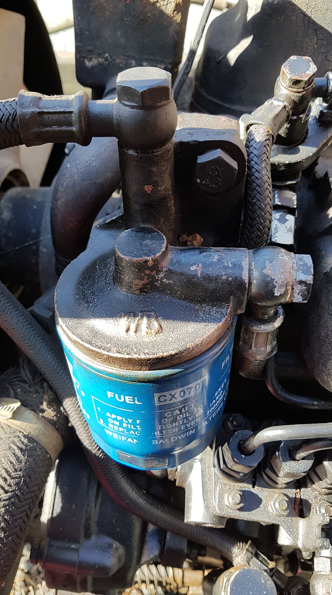

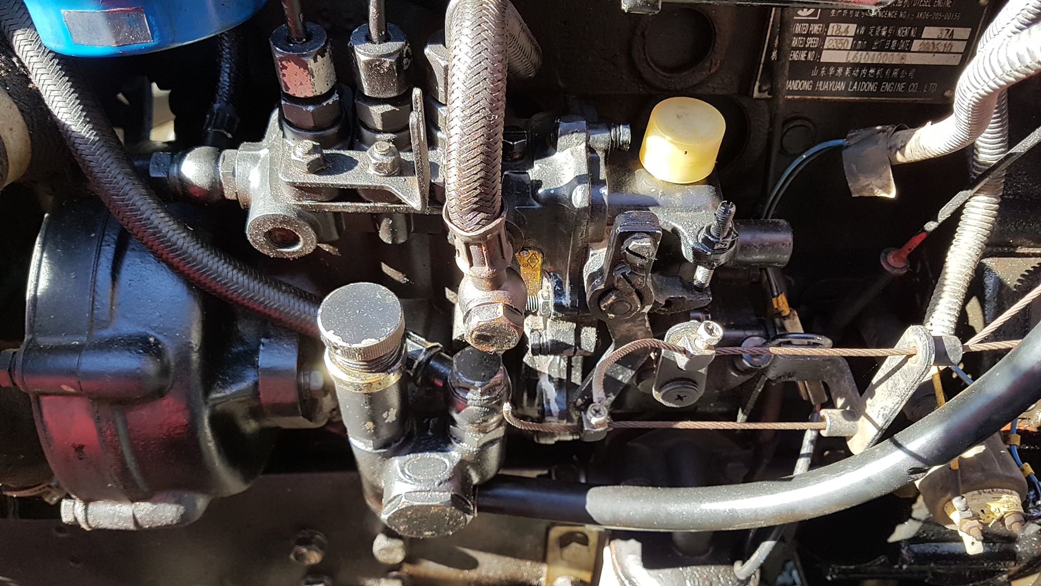

Having trouble getting my Jinma 254 to run properly. It will start but won't idle. Have read quite a few threads and it appears my shut-off lever/rod is stuck. I've attached an image of my IP. Pulling on the "pull to stop" does not do anything and there is little movement on the arm which is on the injector pump. More research indicated that I can remove the cover on the back of the IP and free/clean the rod and then add fresh oil. Is the cover that the dipstick goes into the one that needs to be removed?
And when refilling with fresh oil, how do I know how much to put in or should I just check by using the dipstick?
Lastly, that lever on the back of the motor, should it be connected to anything?
Thanks!

Will the engine shut off by moving the lever BY HAND.?? if yes, the problem is w/ the cable..
Yes, check/add engine oil to the proper amount indicated by the dip stick.. start w/ 2oz & go from there..

Looking at the last pic.. there looks to be a LOW IDLE SCREW.. Just turn the screw..
Have a look at your throttle lever.. move it by hand w/ the engine NOT RUNNING & SEE how it works..
There should be a ledge/bump-out that the screws hit on.. pull it to wide open & see what the screw hits on the lever..
Now do the same for low idle.. & adjust accordingly..
I've personally have never had my hands on 1.. but they're all/most, licenced from another manuf. that I AM familiar with.. & they work the same..

what is the lowest rpm it will run before stalling?
the lever on the engine is you decompression lever , if i am not mistaken , make sure it's not on.
the side of your injector , the long lever is the shut off , I would replace the cable since it's not moving the lever, and the small lever is throttle.
I also noticed you primer is leaking, I not sure if your is the type that has to be locked in place.

you should be able to shut off the fuel by hand, unless you cable so stiff for it to move. cut the cable or undo the screw.

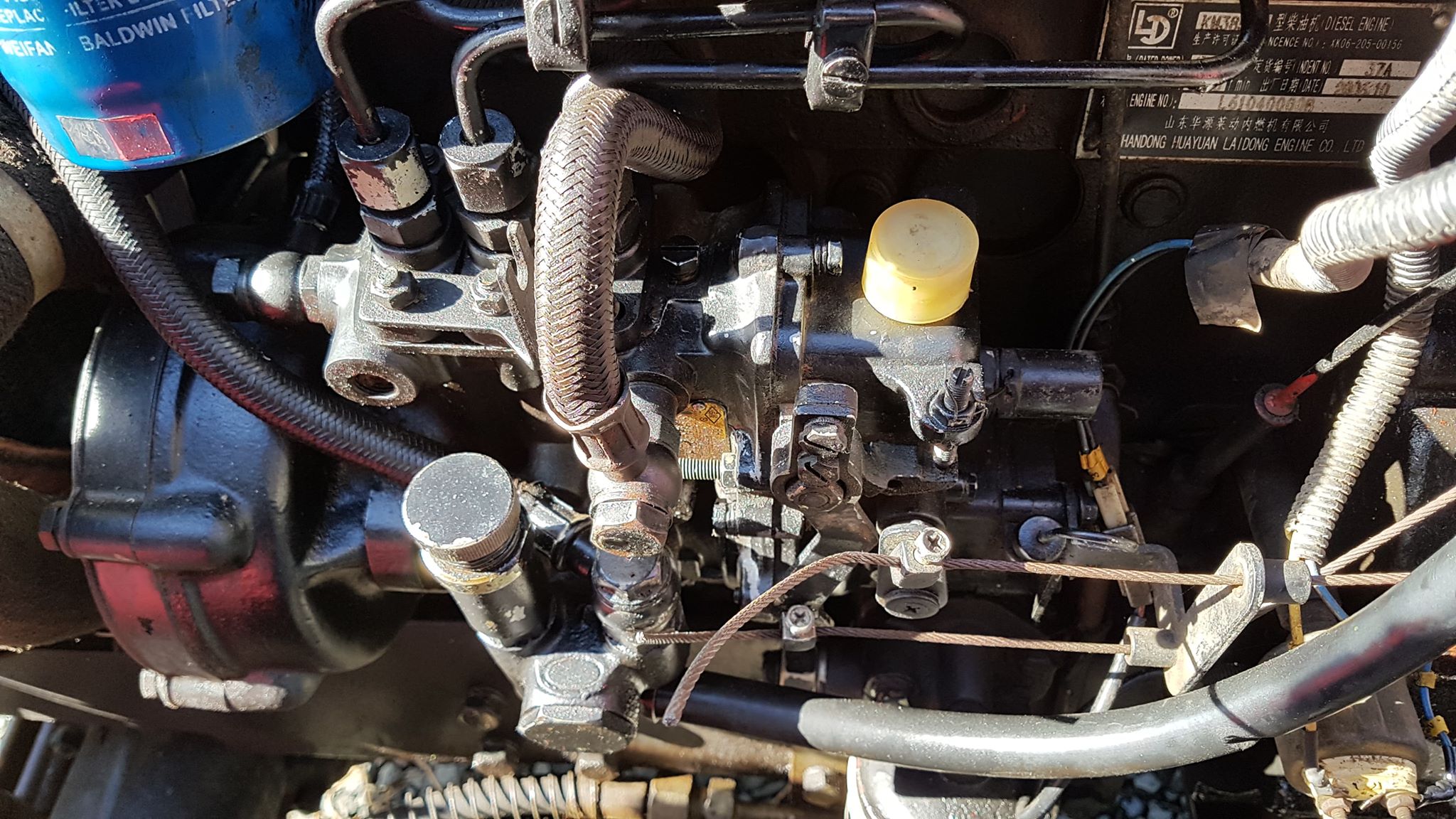

Do you have a fuel bleeder port on the injector pump? I looked at your pics, but they are too close-up. It could be that you have an air pocket in the injector pump and you are basically pushing fuel with the primer around the air pocket and back thru the return line to the tank. If you can post a pic that shows the entire IP, I may be able to point it out to you.
Next, on top of the IP where the hard lines attach, under each fitting is a small check valve. If those check valves are not sealing, the fuel goes back and forth in the line instead of advancing up the line one step for each pump stroke...

Hi Ron,

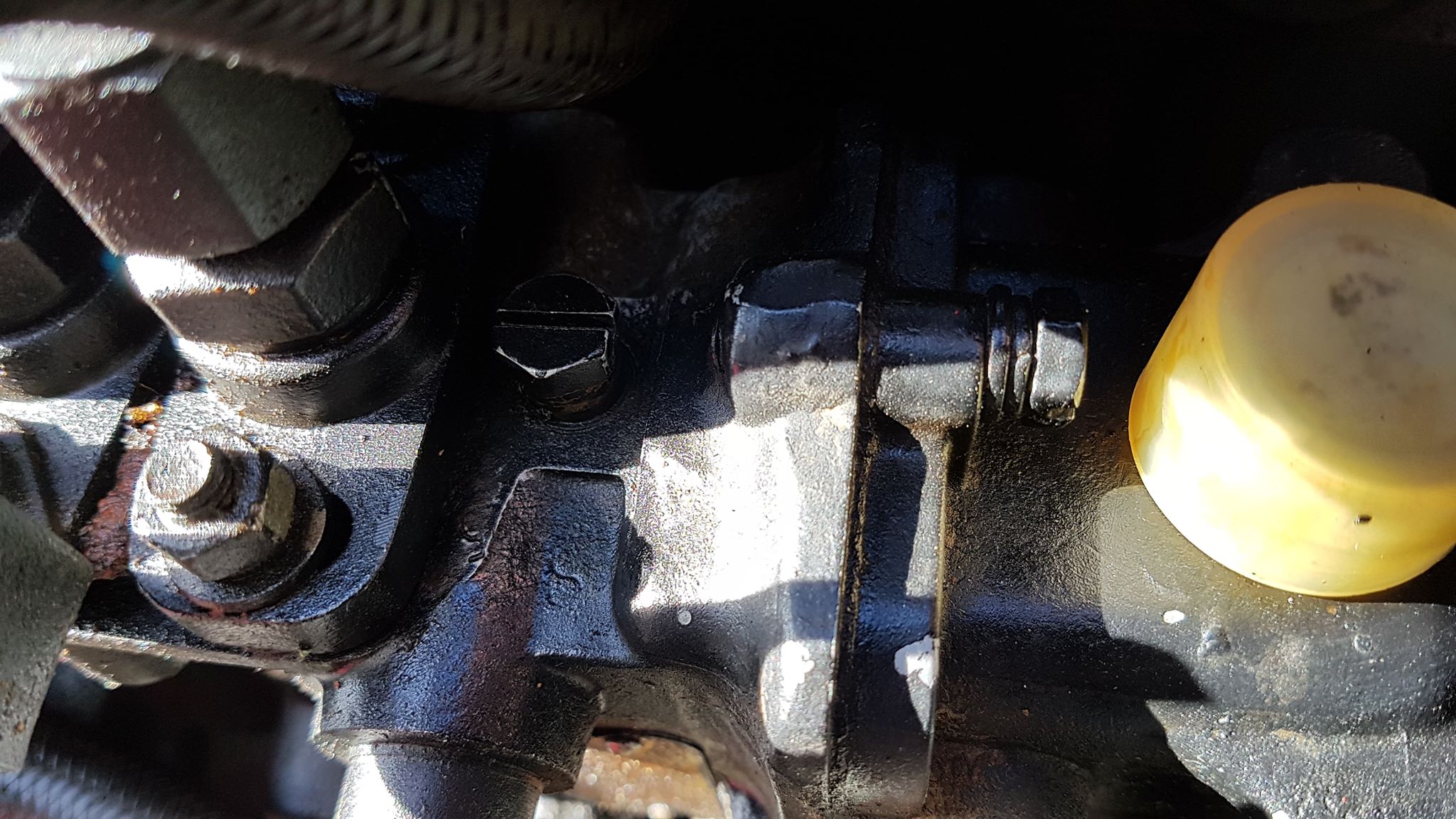

I've attached some pictures of where I assume the bleeder is on the injector pump. Is it the bolt with the groove through it? Can I just bleed the injector pump through that bleeder by opening it up, pumping the primer and then tightening it back up?
And I also read to bleed from the top of the fuel filter but mine doesn't seem to have the 10mm bleed point?
I will check those check valves out. I couldn't see any fuel escaping through them

The bleeder screw IS that 10mm screw in pic #3..
The hose IN FRONT of the inj. pump is the INLET.. The hose that goes across the bleed screw is the RETURN fuel.
I don't recommend tearing into the inj. pump.. those "top nuts" HAVE TO BE TORQUED back down..

yep, that is the bleeder with the slotted head. yes, loosen it and pump the primer to purge air. You can loosen the hose connection banjo fittings/bolts at the fuel filter to purge air from the filter housing.
The fitting I was referring to above is the ferrule nut around the hard injector line that attaches the line to the fitting on the top of the pump... I am sure they have a torque spec(everything does) but I have never torqued one, just re-attach snug, same as the banjo fitting on the other end where it attaches to the injector...
