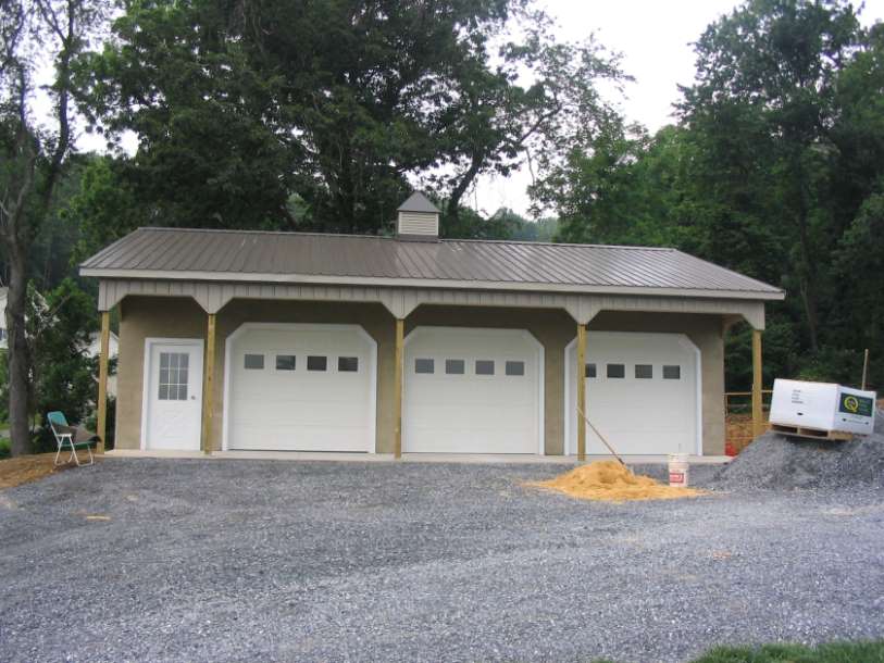

The grass is starting to come in all around the building now.
