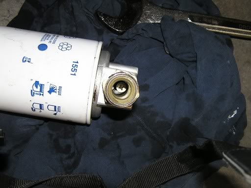

I have just replaced the hydraulic filter housing and outletpipe (broke the housing and bent the pipe with a tree stump impact...whoops). the FEL is working (hesitant but works) but the rear power lift will not operate. The tractor is spewing quite a bit of foamed hydraulic fluid from the resivoir vent when the FEL is lowered (under the seat, has been topped off). The only thing I can think of is the the filter might be in backwards. There is no arrow to show install direction on the new housing...does the philips head screw in the housing go toward the pump or the cotter pin on the opposite side go towards the pump (I have uploaded photos, hopefully they will embed.....new to this site). Do I need to prime the pump/line? I used AW 32 fluid to replenish the resivoir....I am guessing the foam is a funtion off air escape from the system and or reacting with the old fluid. Any ideas? Any and all help will be much appreciated!!! Hydraulic1.jpg

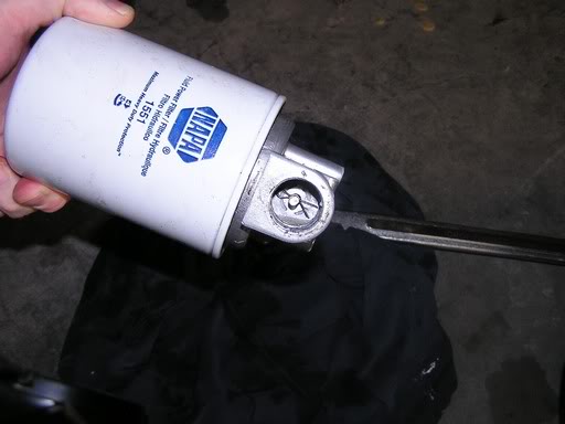

The cotter pin side is the inlet. That is the by-pass relief valve.
The aerated oil is a function of an air leak in the lines on the suction side of the pump. All hydraulic oils are miscible.

Is that spin-on a filter or a mesh strainer cartridge? If it is a filter, it may be too restrictive for a suction application. IE: You cannot put a 10 micron filter on a suction side of the pump. It should be around I think a #100 mesh, which I think works out to be around 150 micron. Strainers on the suction side, filters on the return side...

Thanks for the advice, so....if the cotter pin side is the inlet, then the cotter pin side would go toward / facing the resivoir and not the pump?
I used some thread / gasket sealant I found at the auto parts store, do you think the teflon tape is better?

RonMar posted a good question. Is the filter a suction filter for the pump or a return line filter to the reservoir? If it is a return line filter then it's okay, nominal rating is 10µ (btw. it's a pleated paper media filter). But if it is a suction side filter for the pump it is the wrong filter, should be a Wix #51553 33µ or equivalent.
The OP pictures a NAPA 1551, a google serach shows that to be a 10 micron filter. Furthermore, he asks which end goes towards the pump. If it's on the outlet side, it would explode. So it MUST be on the inlet/suction side.
Your point about the 150 micron is a good one. He has a 10 micron filter on the suction side. I wonder what happens. Does the pump just cavitate? Does the vacuum created overcome the seals and let in air? Does the bypass come into play?

If this filter assembly were used on the suction side of the pump it would only be marginally effective. While it has a nominal flow rate of 12 - 16 gpm, that has a lot to do with the viscosity of the oil at a given temperature. So when the oil is cool the filter by-pass will be open, rendering the filter useless.
I would use it on the return line to the reservoir from the valve block.
But if it were to be used on the pump suction then a different element must be used. However, it's your pump not mine. Your call.

Yep, 10u is the wrong filter for the suction side. Way too restrictive, especially when the fluid is cold. There is no place to put a return line filter on the 284, at least easilly, as the final return from the 3PH valve is back thru the sidewall directly into the reservoir. Everything upstream of that point back to the pump is subject to full system pressure.
The relief/bypass may or may not open under vacume, and any type of weak spot or leak is probably allowing air to reach the pump. Or it is sucking it thru an internal pump seal. Pressure rated seals often are very poor at resisting vacume. It could also be sucking in around the filter cartridge seal...
At any rate, I think that is the wrong filter element for this application... They make coarser mesh or paper cartridges for this type installation.

If the OP had the filter head installed backwards (I'ts not clear to me whether he did or did not) the bypass wouldn't work. It seems to me that that would increase the chance of drawing air into the system.
I've had my Jinma for 5 years, and been all over the Chinese tractor boards. The consensus is to use a 150 micron filter on the suction side, a lot of these originally came with a screen in the tank that doesn't hold up well, and started to be replaced or augmented by the filterheads around the 2005 time frame.
Ron's statement about the three point return being internal is correct, that is why I figured the filter would explode if on the output side, it's NOT designed for the pressure.
What it would do, assuming everything else is air tight, is to draw oil in reverse flow through the filter media (in this case, pleated paper) eventually causing early failure and filling the hydraulic system with paper bits. There is no screen on the outside of the filter media, only the inside. I've looked at several. In addition, it would cause aeration from cavitation because of the relatively low velocity.

Thanks everybody for your input! Much appreciated! I have reached the conclusion that the cotter pin side goes towards the resivoir, it would appear that the only way the bypass would engage is with suction from the pump end (at least that is my best guess). I have found and repaired one obvious leak and that has helped a little but I am still getting heavy foaming. Any advice as to how to trace were the other air leaks are comming from (aside from the obvious dripping of fluid)? What is the consensus / best recomendation for sealing the connections......teflon plumbing style tape or some sort of liquid sealant compound?
