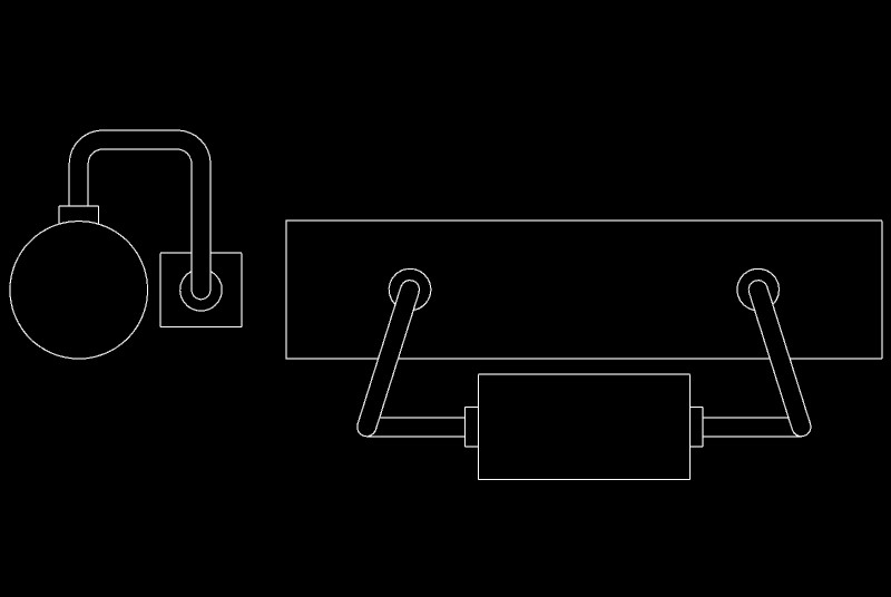

I don't know if you've resolved this issue yet or not, but what about placing the valve off to the side of the cylinder. This would allow you to splay the lines out a bit to make some more room. The attached sketch does not show any fitting for clarity... just shows "tubes" that would be comprised of various fittings, etc.

...Mechanos offered another possibility using tubing (thanks), and I might have to go that route, dunno yet. I do know shoehorning the valve directly between the ports on this short-bodied cylinder using just fittings has not been easy. :)
I didn't necessarily mean or intend for tubing to be used, I just didn't feeling like drawing all the fittings for purposes of a "sketch". Where the "tubing" is shown in my sketch, it was just intended to show the routing of the plumbing. It may be possible to plumb it up with nothing more than orinary fittings and/or some pipe nipples. The main gist of what I was trying to get across is that by offsetting the DPOCV to the side, you are not constrained to distance between ports on the cylinder. Gives you a bit more freedom. Make sense?

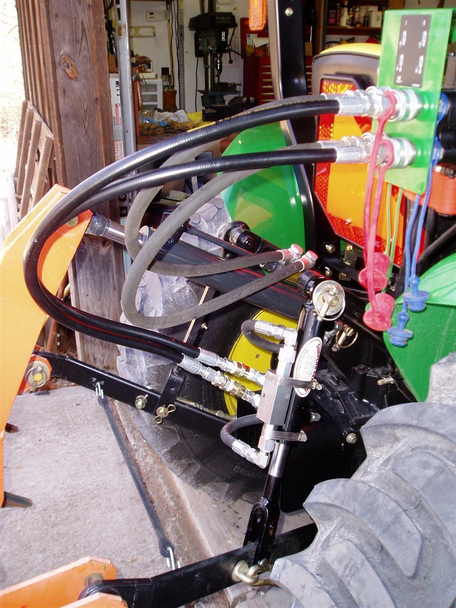

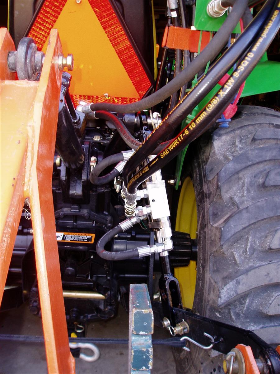

Finally threw in the towel and Rube Goldberged this hydraulic side link. It works great, but isn't pretty. There was just not enough cylinder length between ports to do it neatly like I wanted.
Are they (the little short ones) 3/8" hoses? All you needed was 1/4" for everything, cheaper and easier to route, and less bend-radius.

Good idea, that would have worked too. Never dawned on me to cross them at the cylinder and simply reverse the QC's. Duh... However, these will be ok as is, I think. Although I have exceeded the recommended minimum bend radius a tad on the two short hoses, they are permanently in place and don't need to twist or flex in use.
Kenny, the hoses are 3/8". I've standardized the entire tractor to 3/8" fittings and hoses, since that size hoses and fittings are so readily available off the shelf just about everywhere.
