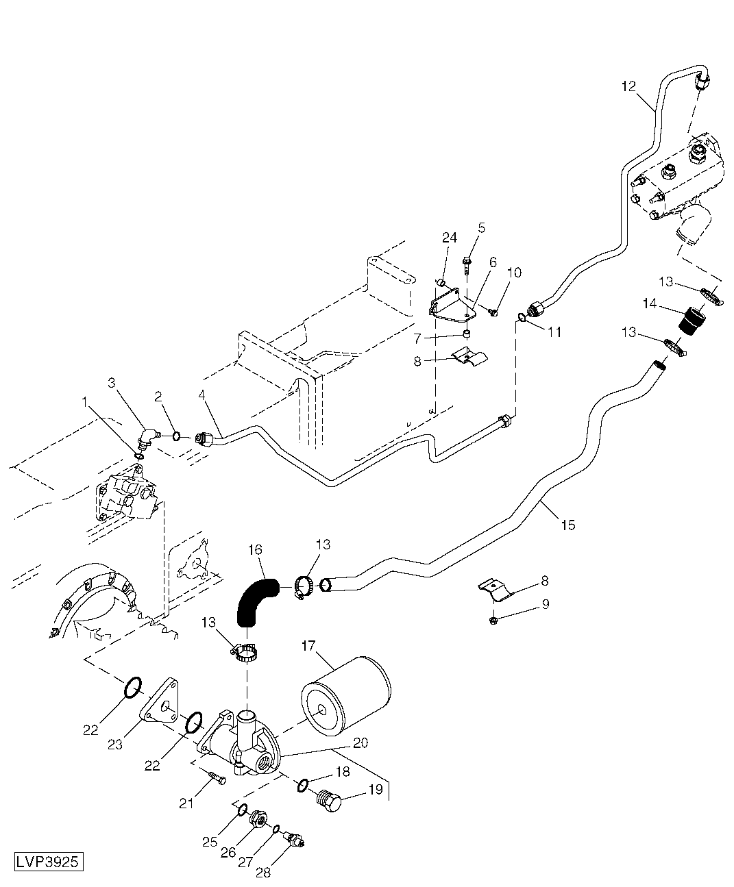

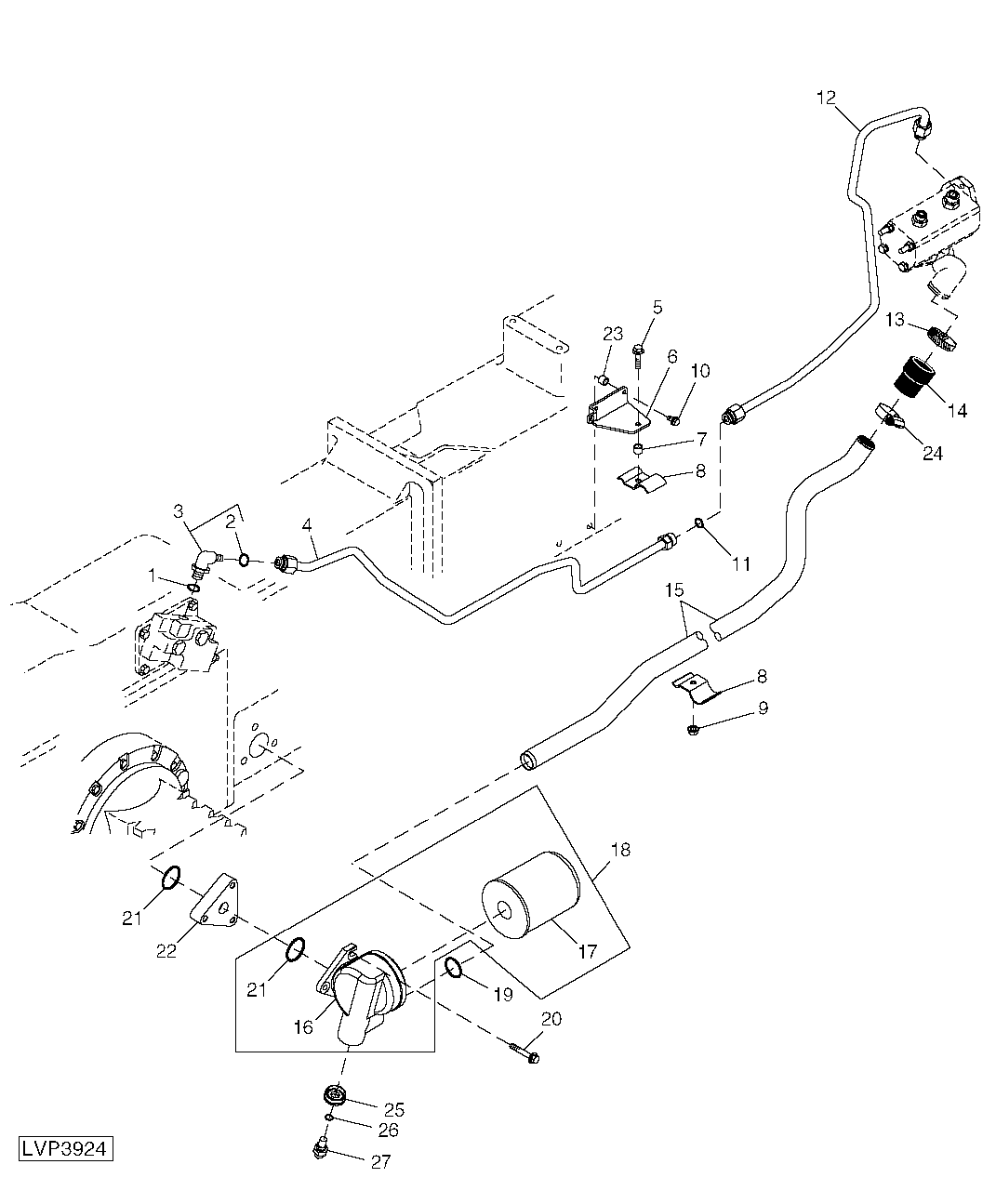

There are several possibilities, but I think you need to check out the suction side of the circuit first. Depending on you serial number, the suction line can be two different styles. On both types there is a piece of hose that connects to the pump. That is the suction line hose. It is attached to a steel tube that connects to the filter housing. At the filter housing, the tube might be connected to another hose or it might fit into the housing with an oring seal. Also the filter housing is connected to the transmission case with a spacer and an oring between each joint. If the hose(s) or orings are not sealing properly, it can allow the pump to suck in air instead of oil. This causes severe hydraulic output deficiency.
I have attached images of both setups. Another place air can be sucked in is around the pump shaft seal. Since the pump is bolted to the engine, when air is sucked in around the seal, small amounts of engine oil can be sucked in also. If your transmssion oil is turning black like engine oil, that would be the place to check.

/ Jerky hydraulics on JD 5310 #16
Hose is #14. Orings #19 and #21 could also leak air into the suction line.
