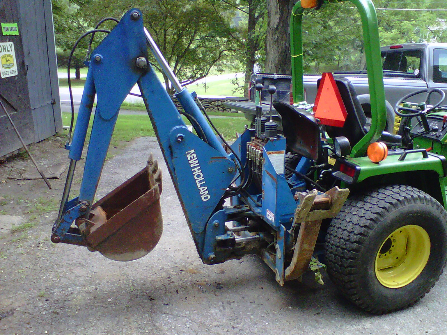

A New Holland 757 frame mount can be very easily modified to fit. IMG_0330.JPG

/ JD855 - What Backhoe other than #7? #8
Yes I ran off the power beyond, it was within 100 pounds of the #7 John Deere hoe
/ JD855 - What Backhoe other than #7? #9
I do have stickers and green paint so it will be a green number 7 hoe eventually
