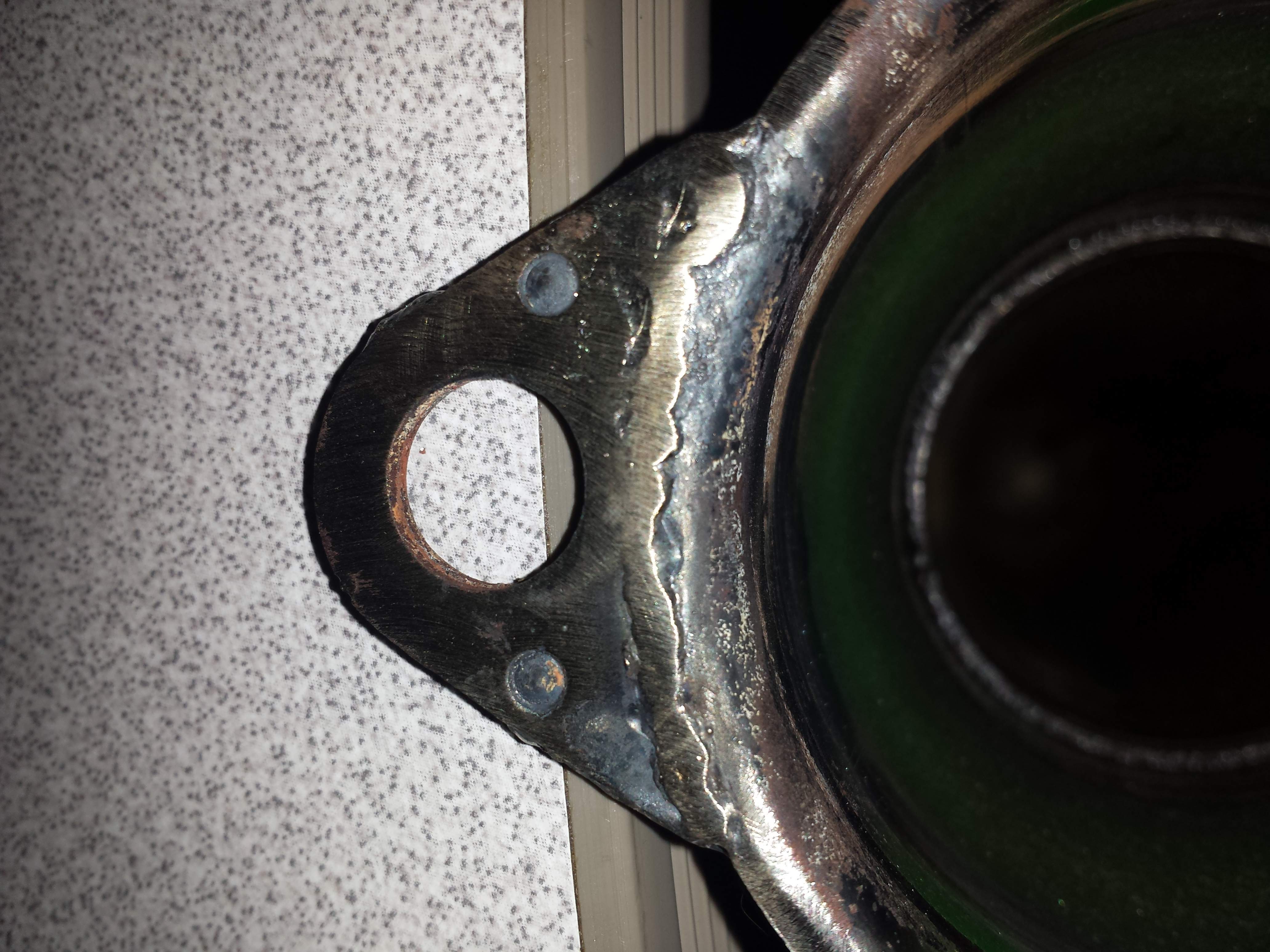

Spent some more time on the tractor today, once you get into things you typically find more issues.
Two of the bearings are suspect, one had metal flakes around the snap ring and the other one is sticky, those to be replaced.
The lands on the pinion gear look great, I was suspecting to see noticeable wear marks but to my surprise nothing.
The tang that holds one of the driveshaft covers had snapped off, that part will be fab'd and TIG welded.
The seal was bad and will be replaced as well, which leads me to placing another order for bearings and a few more seals/packings.

Driveshaft cover finally patch welded.

I apologize that I did not take snap any pics of the completion, but all went well with the repair.
The driveshaft is kinda a pin in the *** to install with the loss ball bearings, but finally got it together.
Did a few tests and and my 4-wheel drive works now and I can drag a box blade up the hill no problem.
