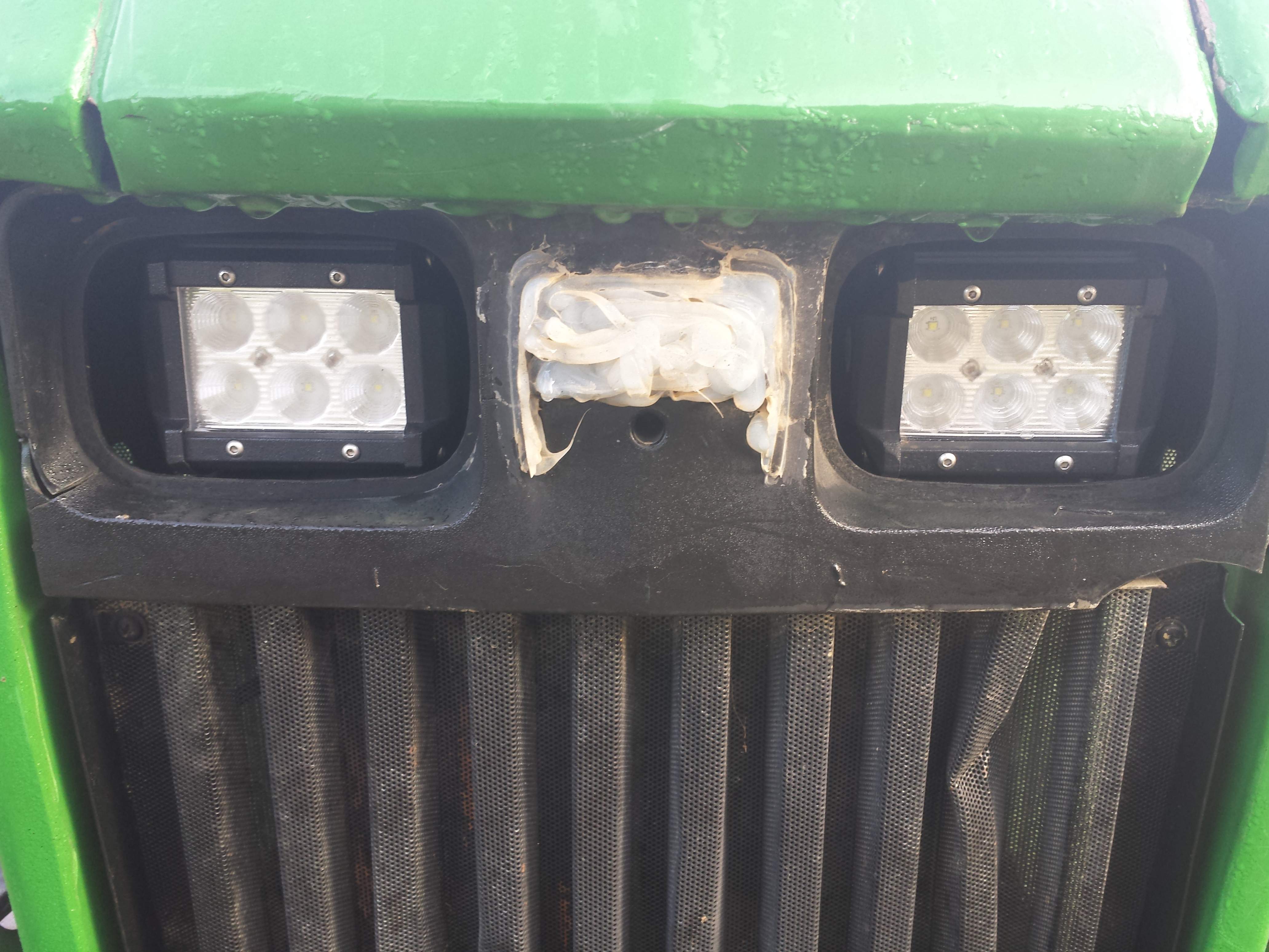

I grafted a set onto my 750 a couple of years back. It wasn't pretty, but it sure improved the situation!
I removed the original lights and housings, and cut out a set of aluminum blanks to fill the holes in the grille. The blanks were screwed into place and drilled for the brackets that came with the LED lights.
Looking at the picture, it would have helped appearance-wise if I'd painted the aluminum black.

Removed the existing headlamps and used these.
I used a slip-roller to curl some sheet metal to hold the lamp and attached said piece to the existing holes.
