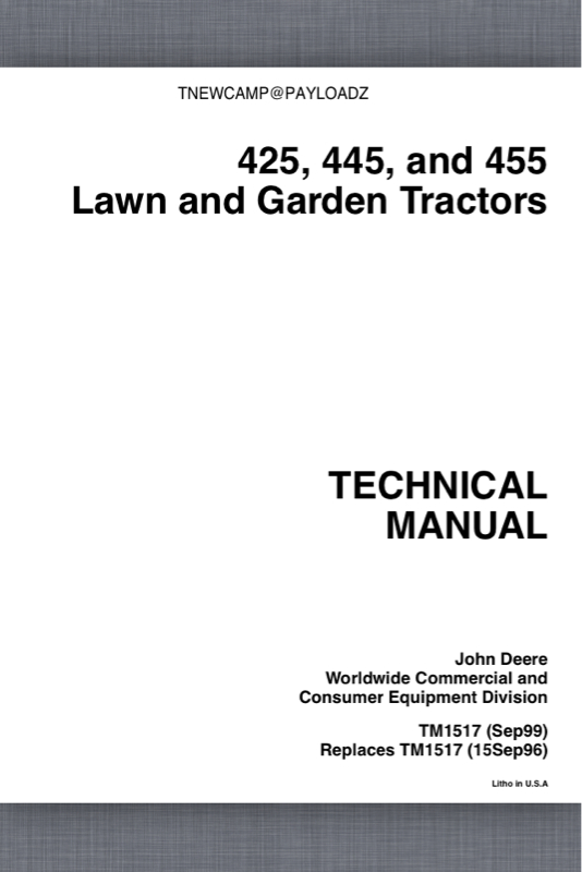

The service manual is out there in cyber space somewhere for free. I got it on my phone a couple of years ago, but don't know how to get it out.
   / JD455 lockout from seat/cab #13
It's too hard to search a 957 page manual on a 3" screen....

I'll have to look closer at that.... will let you all know result.
I found TM... works great on iPad :D
Can't find OM yet though :)
