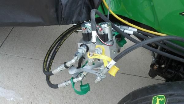

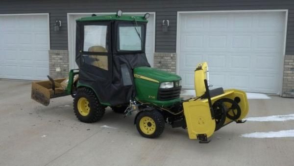

After reading your post more carefully I see that I'm not giving you the answer that you are looking for. I already had the 3pt but needed three hydraulic circuits to do all that I wanted.
The 3pt control only does the box blade.
The other circuit handles the blower through the Fasse valve which has two positions. Position one lifts the blower and is running off the circuit that has float. Position two runs the chute rotation cylinder.
The kit from Sloan is pretty easy to hook up. The valve plugged right into the quick connects and the switch hooks to a 12v source and you are good to go.
The toughest part was getting the right hydraulic fittings.
I used it last winter and it worked very well. There might be cheaper ways to accomplish the same thing but I had other things that I needed to do and this saved me a bunch of time.
Here are a couple pictures.
