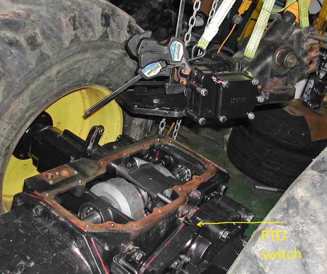

Rear pto lock indicator light will not go out. Tractor won't start. PTO wasn't locked when problem first popped up. Was told to jiggle the lever so I did. Now it IS locked. Been told the safety switch might be bad. Where is it located in relation to pro lever linkage? Can it be tested for continuity?

I have a PDF of the Deere Tech manual you're welcome to, has troubleshooting for the switches in it
shoot me your email if wanted

on the way
