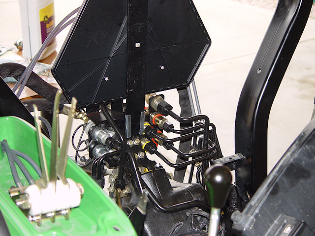

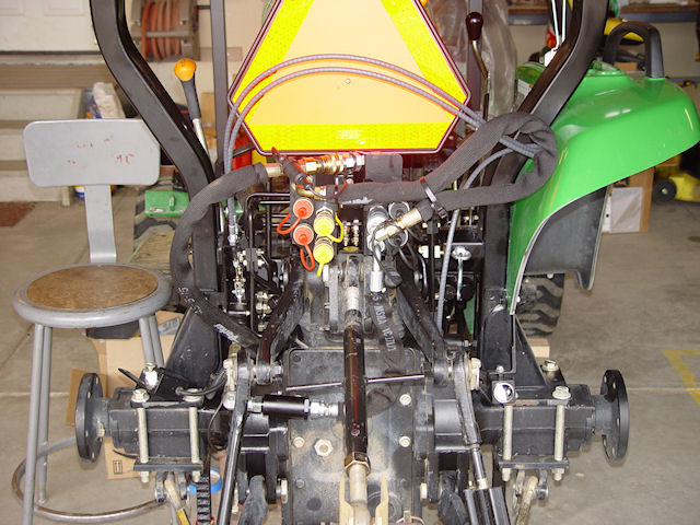

Well, it’s DONE! If you don’t count the tractor on jack-stands, rear tire removed, no right rear fender, no cover plates, no seat,……Sounds done to me! But seriously, I got the control body out, retrofitted with linkage bracket, bell crank etc. etc. etc. Got it all mounted back on top of the transmission, and all the ‘blessed’ lines reconnected! Kind of a funny start. After stripping the tractor seat, tire, fender, etc., the first thing it says is “Loosen the four hydro lines from the QD’s under your right foot plate.” I guess, for tube movement. Well with the FEL on, I couldn’t get in there to loosen them! What to do? Like any good (?) mechanic, skip to the next step!!! Actually I think it worked out better, ’cause it held all the lines right in place! The kit gave me more hydro-bushings than I needed! Do they put extra parts in just so you ’quadruple’ read the instructions? Good to have the extras though, one of the “O” rings had a big nick out of it, that would have me doing the whole job over had I not seen it! I had PB previously installed, Mjncad, so that saved me the rear bracket work. Dare I ask where the 4th and 5th valves go? Thanks, guys! ~Scotty
/ JD4200 Third SCV Kit........(again)...!!!! #5
The 4th & 5th spools are in a single valve body just above left axle. Follow the control cable in the picture. The QD's are to the left of the PB and 3rd SCV QD's. Notice it is a snakepit with all the stuff installed.

Yeah it does, which is why I want to eventually do some rework with hard lines to get rid of the space robbing hoses, because the 4th & 5th SCV's are a kludge powered by the PB kit. Since the rockshaft control valve doesn't have a PB port, I can't pipe it up simple as it should have been done by Deere.
Let us know how adjusting the lever friction block works out.

All of the QD's back there are too close in my opinion, and yes I do have trouble connecting items because of the limited space. I have the same issue with the loader QD's too.
Since I helped the economy by buying lots of crowfoot wrenches to install my kits, I managed to torque all my lines to spec and knock on wood I haven't had a leak. If your leak is at a fitting, I'd try tightening it down a bit. I don't see how changing to hoses will help the leak issue, and all it will do is make a cramped space even tighter. If I understand what your planning, it could make the seat rub against the hoses too.
