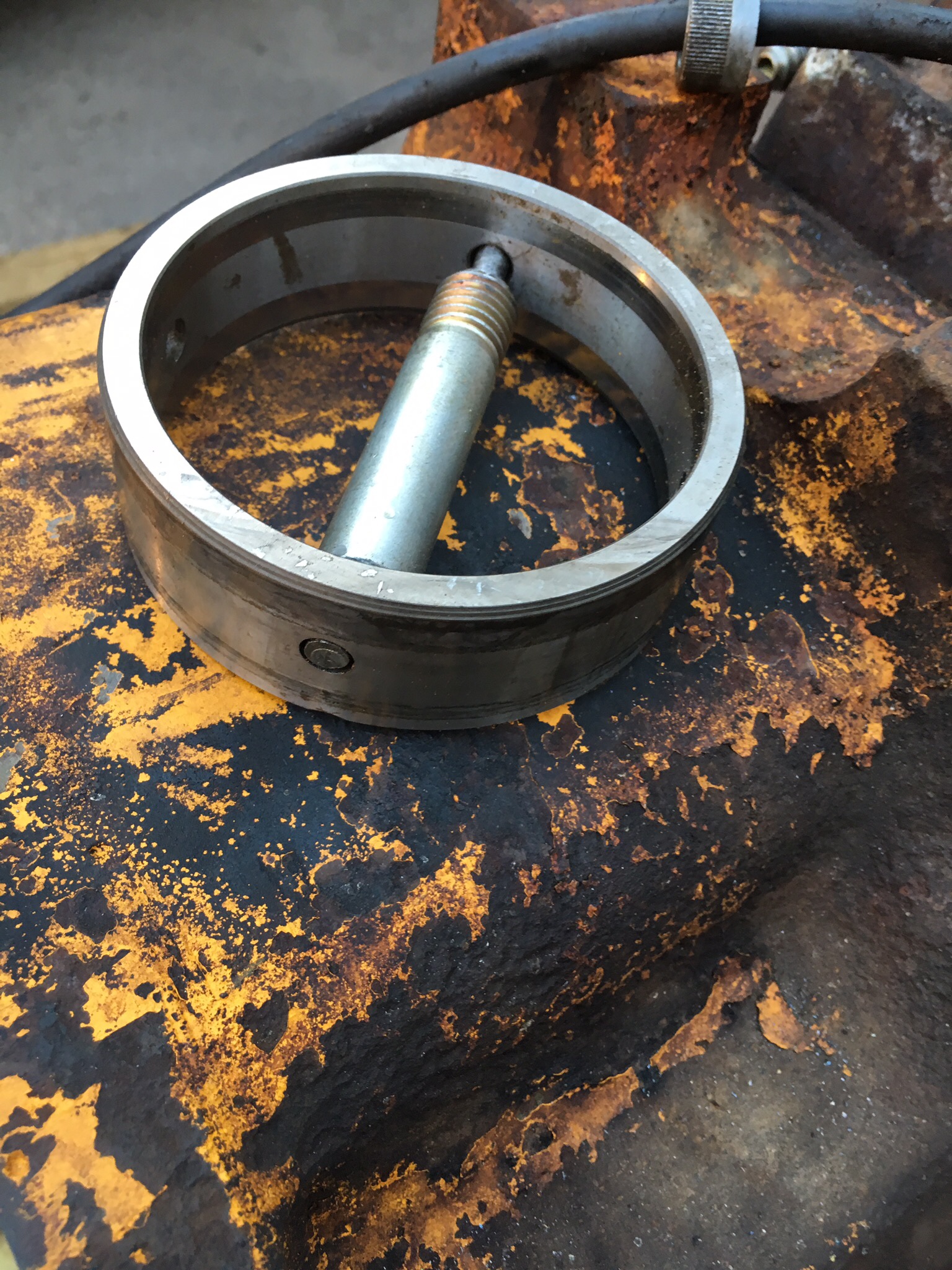

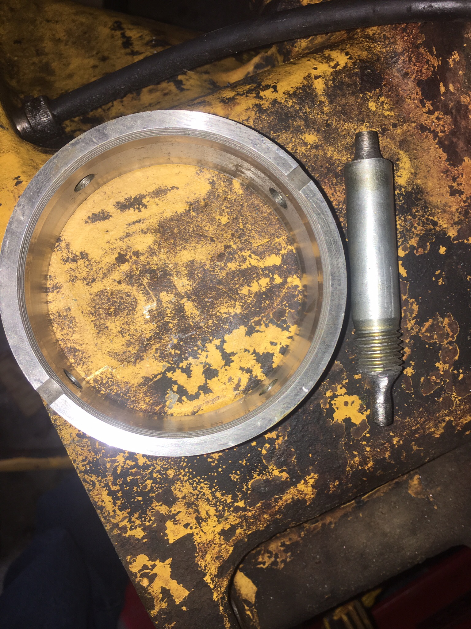

Update: split tractor and as JB suspected forward tube didn't hold any compressed air pressure. I was thinking it would be just the O ring where forward tube goes into housing but I also suspect two rings and oil sleeve with the 4 holes which has a slight grove on it may be the issue. I think I should change them as well as the copper shaft bushing. Not sure of best way to get oil sleeve out? Anything else I should be considering? Thanks! IMG_3173.JPG

I would also disassemble the clutch packs and inspect them. Replace seals on the piston inside also. The oil sleeve is tricky to replace. I have seen some guys run a bead of weld around the inside of the sleeve to "shrink" it. That works but I don't like all the dirt/weld slag going everywhere. I have had good luck with a lady slipper bar. Stick a bolt or pin in the oil holes in the sleeve and pry against the bolt to get it started. work you way around to keep it coming out evenly. Once it starts moving, you can get a pry point on the sleeve itself rather that using the bolt or pin. Use care to avoid damaging the bore in the housing. When installing the new one, apply some Loctite to outside diameter.

To get oil sleeve out I ground down a grade 8 5/16 bolt. The long narrow side I slid up into the top hole and let short stubby side lay in bottom hole. Then a pipe with sledgehammer from back side. Came out straight. Almost done putting tractor back together. Will give update in a few days when done.

View attachment 501567View attachment 501568
I like your special tool for removing the sleeve. You need to get a patent on that! Definitely easier to remove if you have clutch housing removed. I usually am working from one side from front side. If forward is only problem, usually no need to split between trans housing and clutch housing. Seems that since heaviest work is done pushing forward, don't have much problem with reverse.
