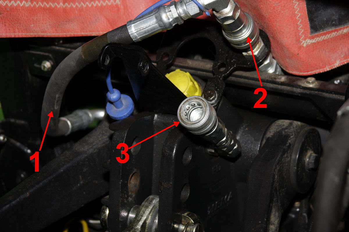

In the spring I want to add a top link hydraulic valve to my 3320 and I need to ask a few questions. I apoligize ahead of time for using incorrect technical terms. I bought the tractor with a backhoe so it has live hydraulics already plumbed and I also bought it with the factory installed 3rd scv that I am using for the angle on my snowplow. I want to leave the 3rd scv available for a potential grapple bucket so is there any reason that I cannot plumb in a new valve for the top link using the backhoe circuit ? I have included a pic of my tractor hydraulics and I have a question about a connection. If you look at the picture, #1 & #2 are my live backhoe connections. Can anyone tell me what connection #3 is for?

#3 is a direct return to the tank-bypassing the 3PH. It is used when the backhoe is mounted.
You can plumb a valve into the couplers like you want...or you could use a diverter to basically split the 3rd SCV into two controls.

Sure...How many spools (functions) do you want/need?
The other option, and probably cheaper option is to add a diverter to the loaders dump/curl circuit to operate the plow and 4n1. It would be a cleaner install also and leave your 3rd SCV for the HTL.

The basic Diverter valve that is used is the 5117A from the Surplus Center. Basically, when a momentary switch is held, the left/right movement of the joystick would operate the "new" circuit on the loader. I have been using one for years (formally a FEL snowplow and now a Markham grapple)...and it will look a lot better than a big valve added on hanging off the back somewhere.
I you don't want to build this "kit" yourself, you can get one ready to bolt on from WR Long.
