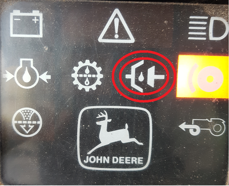

Every now and then this indicator light comes on usually when going downhill. Don't have a service manual so you guys are my best bet. Warning Light in attach pic circled in red.

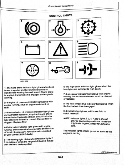

Looks like might be transmission oil..
Edit:
Found this that states "add brake fluid to clutch reservoir" as #9 on the list of control lights

I presume your 2555 has a factory cab? Cab models are the only ones with hyd operated clutch(master/slave cylinders)

Figured it was transmission. Once I have a manual all this will be alot easier. Yes, factory cab 4x4 with loader.

Thx Beenthere. Very helpful. Now to find filler location and level. Searches tell me to look under dash cowling lol.
/ JD2555 Indicator Light #6
Yes you're correct clutch master cylinder reservoir is accessed by removing upholstered cowling in frt of dash.
