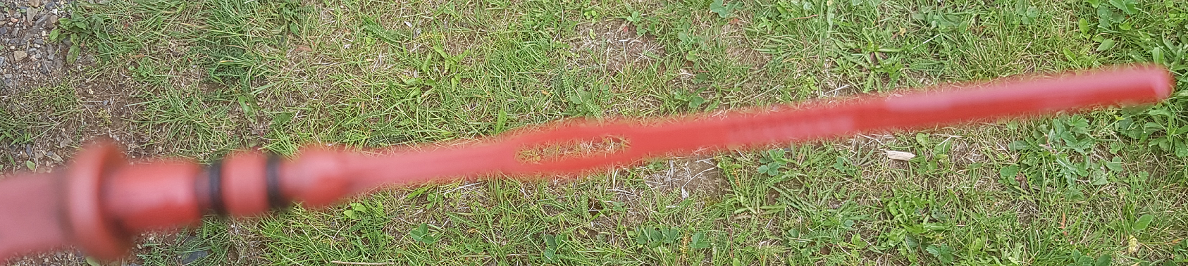

The oil level on the dip stick is not entirely clear. There is a checkered section plus an eye. Since this JD2555 is new to me and I don't have a service manual I'm not sure if the level should be at the top of the checkered section or just in the eye. Anyone know?
Pic of the dip stick attached. Of course its blurry. Can never take a decent pic lol.

I think as long as hyd oil level is above the eye on dipstick you'll be fine. I don't have access to a 2555 operators manual but I think one should check hyd oil with engine idling.

I don't want to overfill since I don't know if this would have a negative effect. Again no service manual to verify. No idea if you check level with engine idle, hot, cold or upside down :) If someone does have a manual if you could please check that would be great. Was looking to ask JD but you cannot contact them for basic support but you can get a quote haha. Next time I am near a dealer I will drop in an ask.

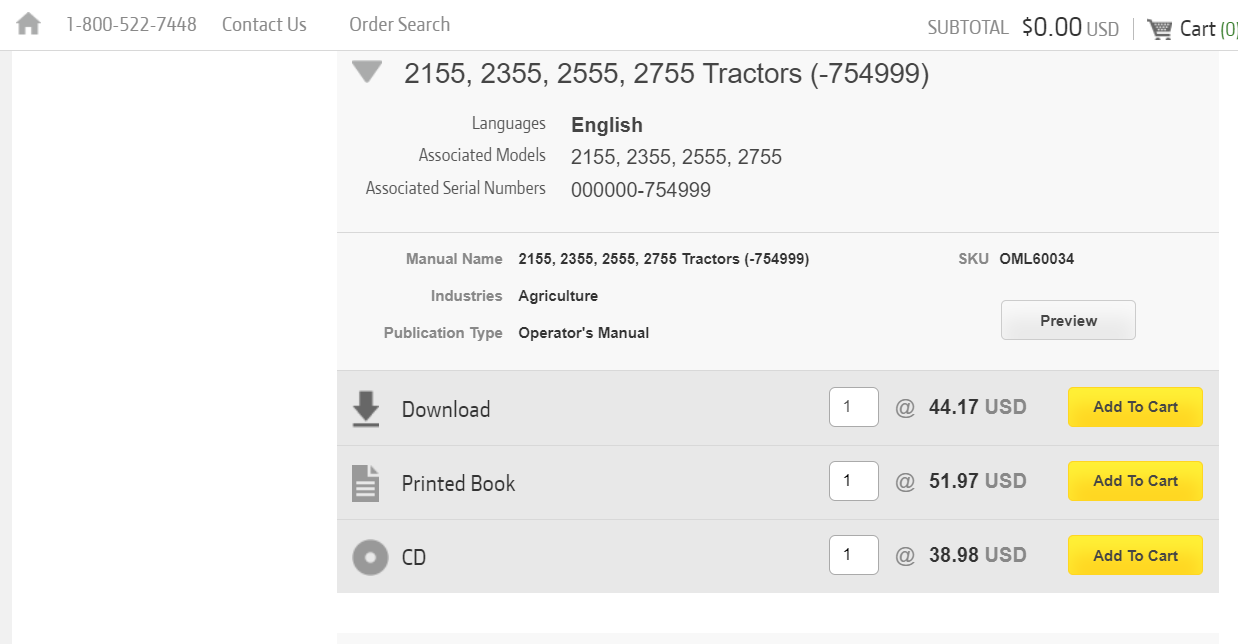

Wouldn't it be simpler just to order an operator's manual? I just randomly picked 1st serial number range. There's also several 2555 operators manuals listed on Ebay.
Operating 2555 hyd system a little over full will not do any harm.

Neighbor has a 2555. Manual says check cold, prefer morning after sitting over night. Should be between upper and lower marks on dipstick. No mention of running engine like earlier JDs.
/ JD2555 Hyd Oil level
Thx zebrafive. The info I was looking for. Will be checking tomorrow morning.
