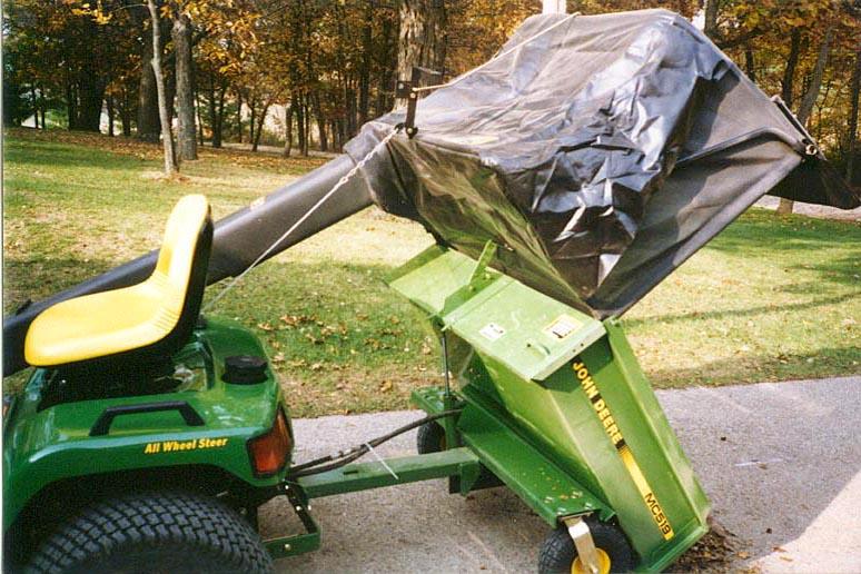

The rig I use with hyd. dump.

I have thought of getting the powerflow blower for my 62D and then making a large plywood or sheet metal box with imatch compatable hitch. I would then make a power opening rear gate/dump on it. Maybe one day
