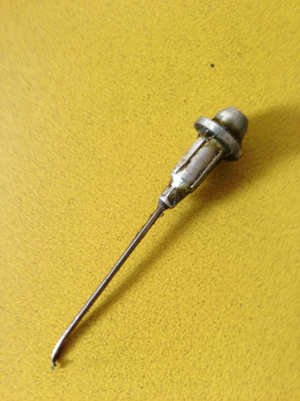

Okay gents, have to admit stupidly here. I took my mower deck off, climbed underneath to grease the two drive joints. Both are easy to see but impossible to get a gun on the zerks. Seen someone posted about a needle.... I have one from who knows where. Someone please tell me how to use it. Thanks, Bill. 2010 - jd2305

Yes, that is pretty much what I use. Snap your grease gun on the zerk of the needle first and push your needle on the tip of the joint zerk where the grease goes in. Push hard enough to hold the needle in place and give it a few pump. I have put a picture if you look on post 9. Sorry if the pic is somewhat blurry.

I would recommend stopping in at an auto suppy house, O'Rileys, Auto-Zone, etc and purchase one of the newer "Needles". The new ones have a slip collar that slides down and locks somewhat the needle injector to the grease gun fitting. The one shown by you will require three hands with a air powered greased gun and four or more hands with a manual grease gun.
Sticker shock may get you. I think I paid somewhere in the neighborhood of twenty bucks for the last one I purchased. But then you know what they say about old people and memory.
