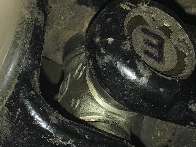

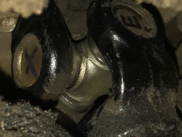

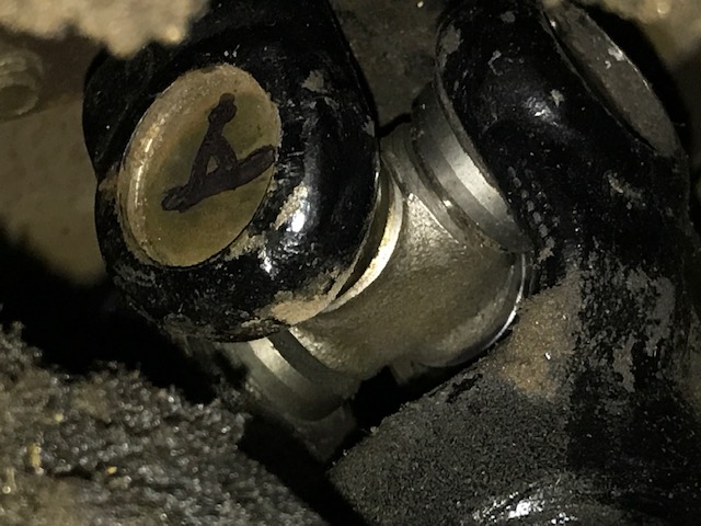

JD 2210 Main axle front u joint -- trying to locate grease fittings. I attached a few pics after cleaning up the front u joint.
Pics are showing side away from engine except image 2127 (the 2nd pic). Can anyone identify where the grease fittings should be?
See attachments for photos please.

Spoke to previous owner and he replaced them about 50 hours before I bought the tractor. He said no zerk fittings on the u joints.
   / JD2210 upper driveshaft service/grease
#73
They'll run 400hrs or so that way. If you ever replace them get Precision brand joints with zerk in a cap.

Just looking at parts online and JD wants $86.00 each and Kubota wants $38.00 each. I want to get some with a zerk fitting. Still looking.
Steve
