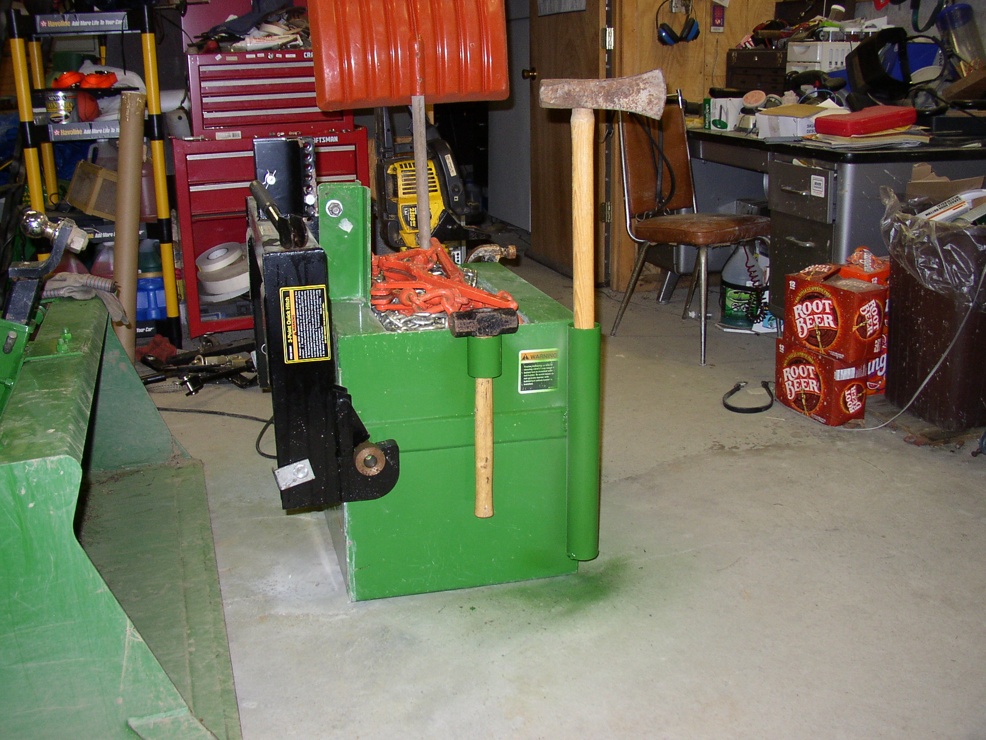

   / JD Rear Ballast Box #53
Just an update on getting my BB ready for snow, woodcutting chores...or whatever? I have at least found a permanent home for some of the scrap pieces of metal that have been cluttering up the shop.
Maybe some day I will actually hook it to the tractor....:)

That's a good idea having the ability to secure tools on the weight box.
I filled mine with 1/2 inch landscaping stone that I had as surplus but I'm debating on emptying it and adding some tubing etc for tools.
I figure it weighs about 600+ lbs now. I keep mine stored on two small moving dollies that I purchased from Harbor Freight for about $10 each on sale. That way I can move it to an out of the way place in my garage.
