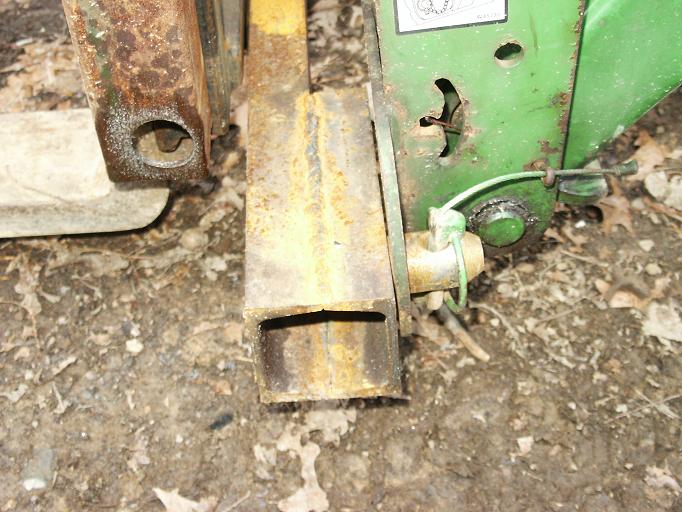

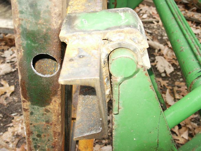

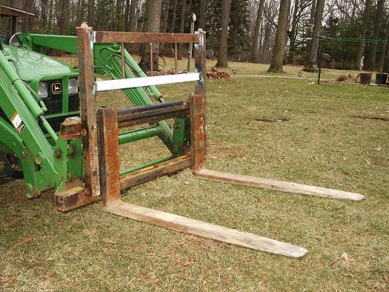

I was going to buy a set of frontier forks, but i just got an adjustable set for free. They were off a skidsteer. can i get the quick hitch adapters from JD for my 200cx loader? causeif not, looks like i'm gonna have to get welden!
/ JD Quik Attach Forks #10
You can to buy the hooks and pins from JD. I did the same thing with a set of forklift forks and some channel iron.
M.D.

I have about $250 in these. Purchased the hooks and pins from JD and the forks from a salvage yard.
