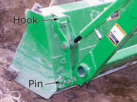

This is JDQA for those not familiar with it:

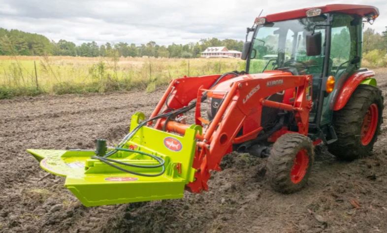

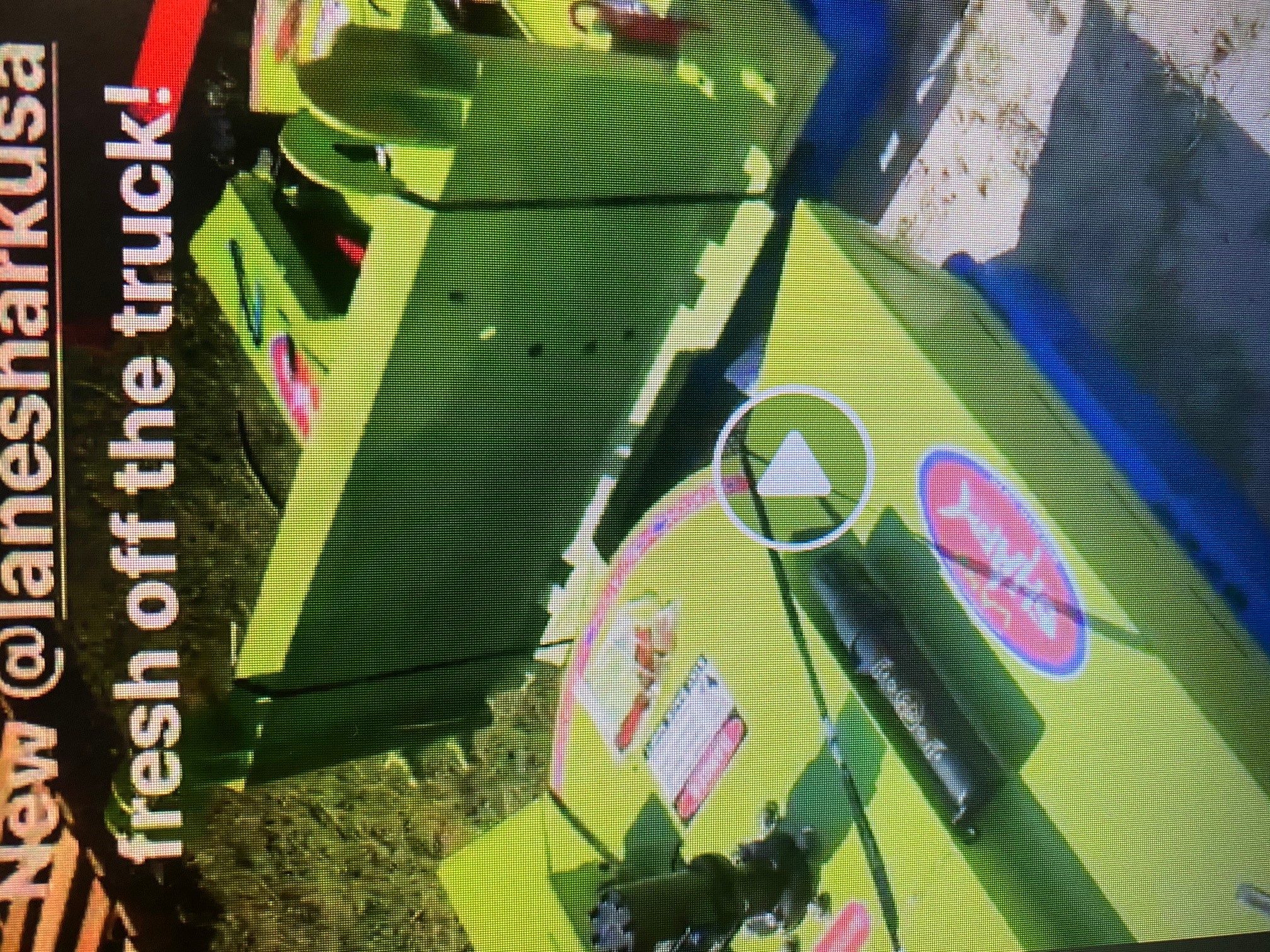

here is a picture i found on the internet, I'm not around the lane shark to take a better picture but I will this weekend. the modern ag path slayer is built the same way.
they do fit both tractors, I have used it on both my JD and also a Mihindra.

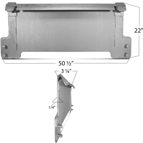

I found a picture on the Lane Shark Website that shows the combination mounting plate from the front:
