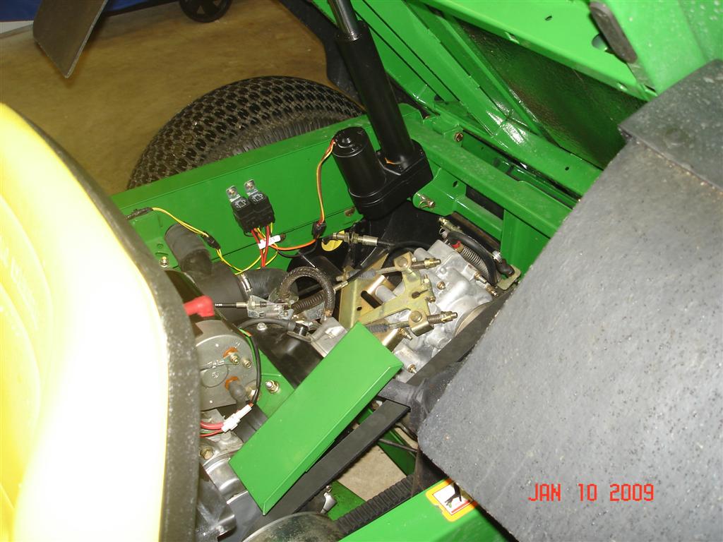

Here is a picture of the actuator in my Gator.

Is that the factory linear actuator or another one. Do you have any idea on the specs. for it?
Sorry, I should have wrote that it was the factory one...there is no label or specs on it-I just went and checked.
