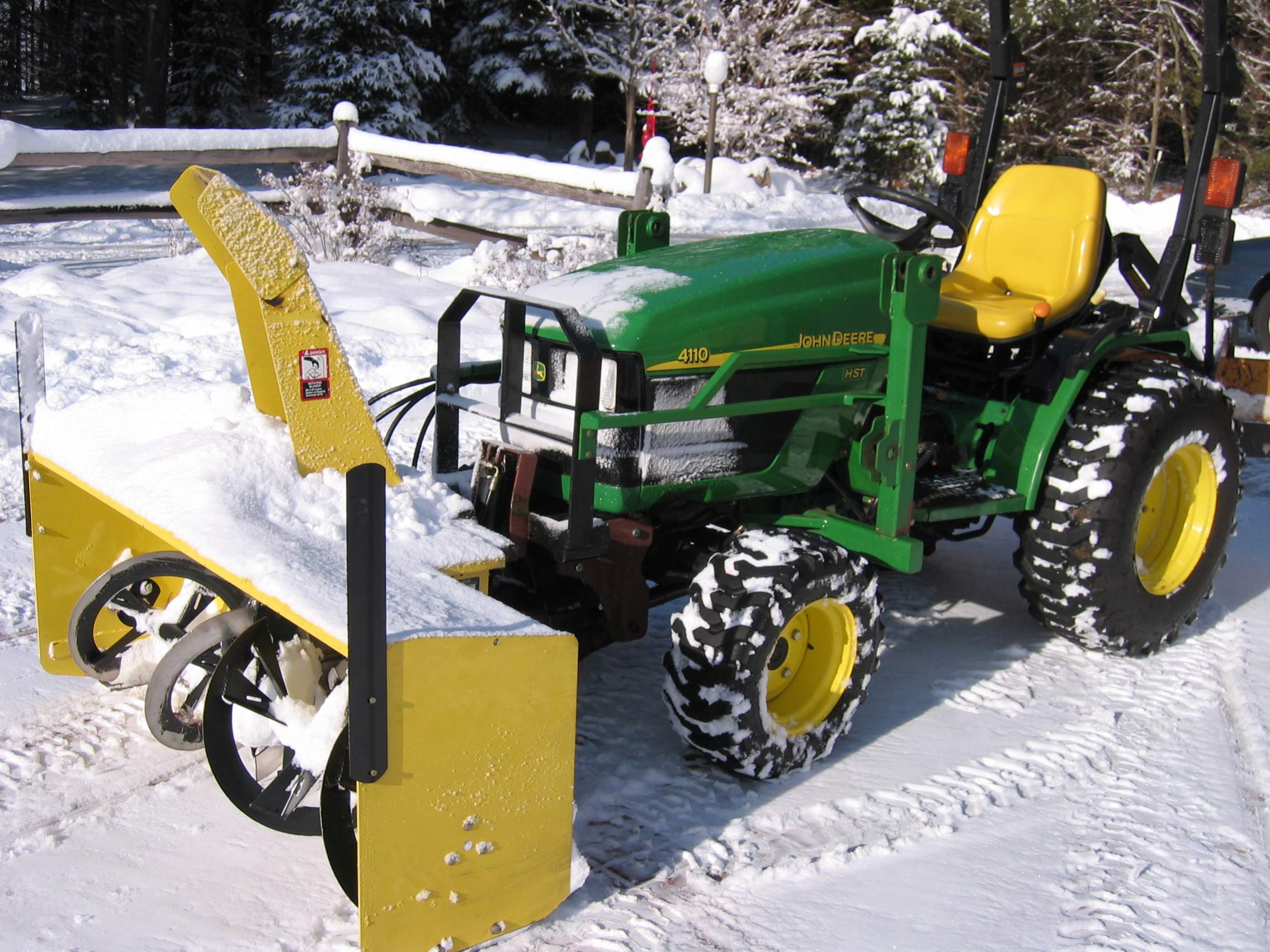

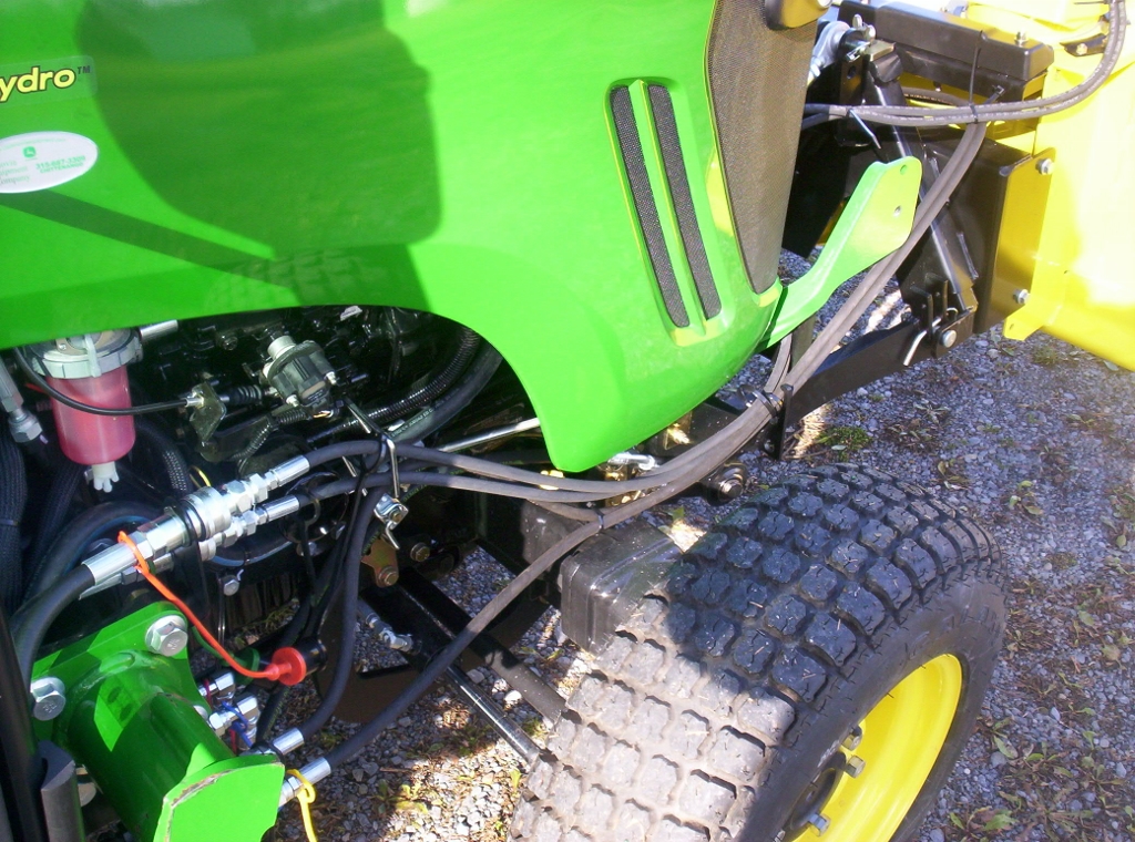

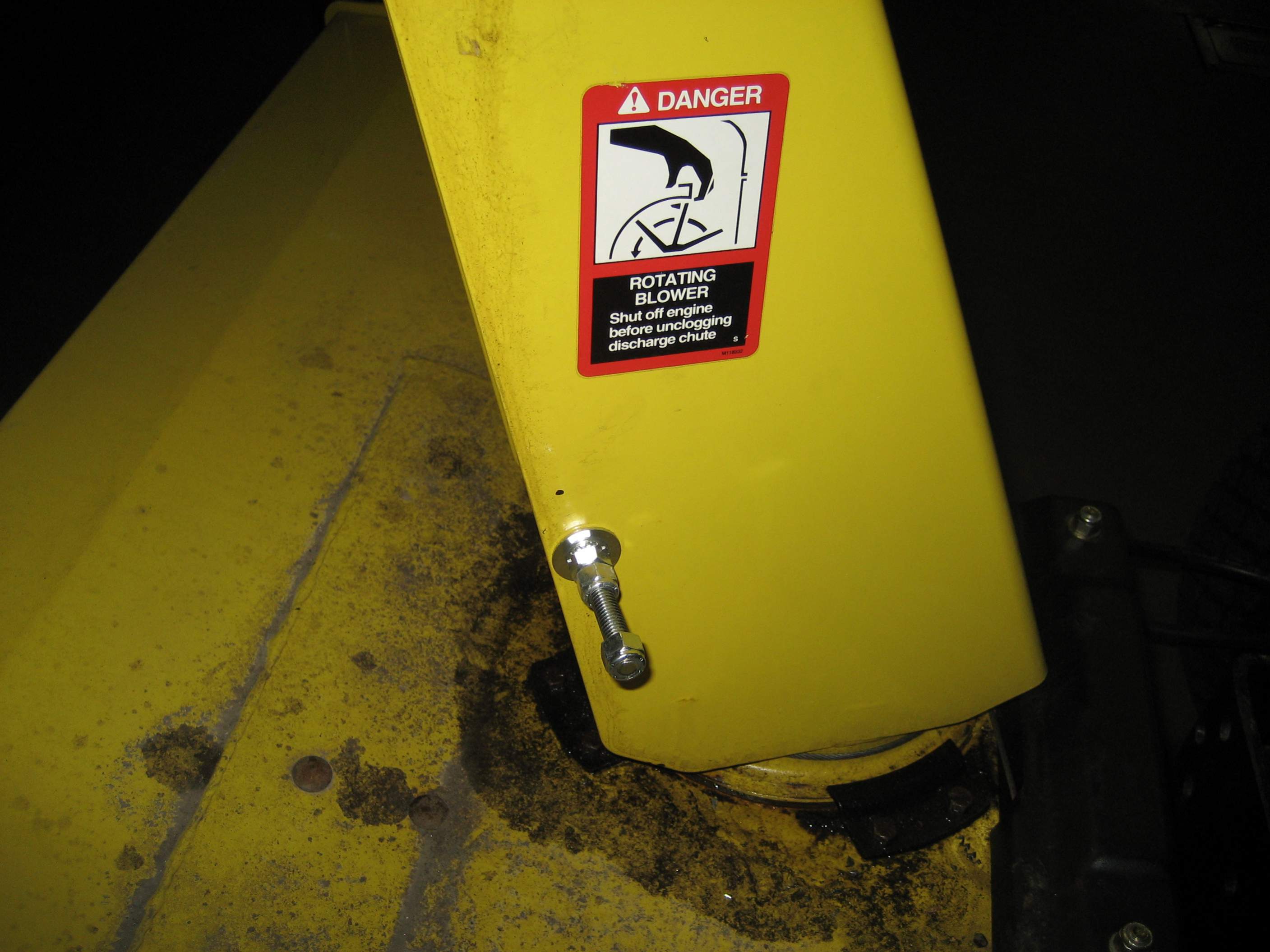

We went the cheap route with a chute deflector control. We had tried electric but it would ice up and not control the chute. We then went to a boat dealer that had old junk boats in the back and bought (free actually but gave the dealer a tip) a used hydraulic ram off a I/O unit. We used a couple bolts on the top and bottom of the chute with hydraulic cables to the third hydraulic hookup in the back. We have used this for 4 years with out any problem. Not as pretty as the frontier but works great.View attachment 289190
As long as it works right?
BTW- my 10 yr old son says you need to clean that blower off! :D

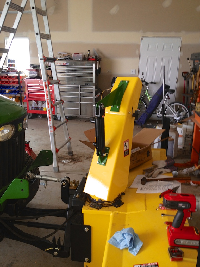

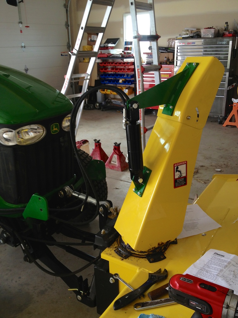

Thanks to Rockgod and his find on the Frontier hydraulic chute control I now have one on my machine. I ordered it from my John Deere dealer and it came in yesterday. I put it on this morning. Very simple, very quick install, and it works much better than I anticipated. I have it attached to my 3rd SCV and use the buttons on my joystick to control it. Life is good.....

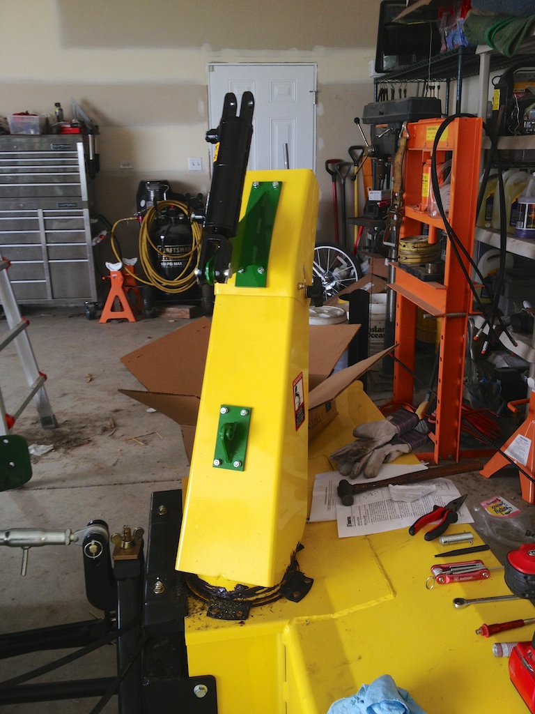

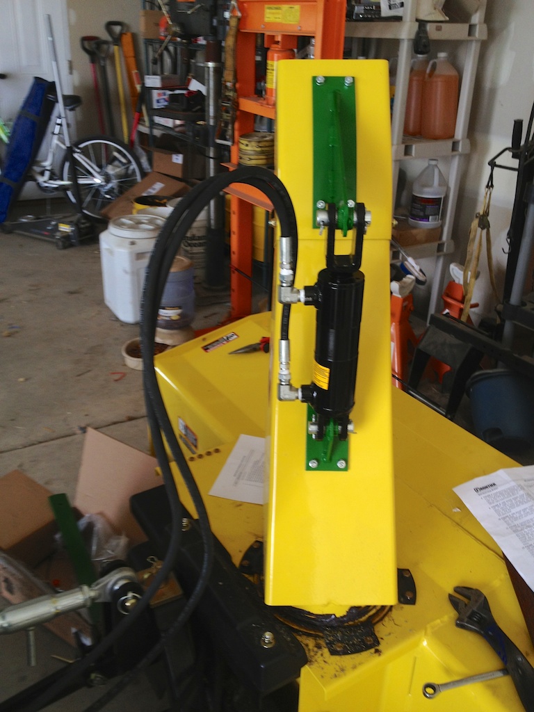

Rockgod and dschuffert,
What is the travel length on the hydraulic cylinders in the Frontier deflector kits, and is all the travel needed? Looking to build my own deflector control. Thanks
/ JD Front mount 59" blower
#72
5"
You could use a longer stroke at 6" for sure, maybe even 7 I don't know. Just be sure it's not too long or you'll have a bent-up deflector cute.

Well, my ordeal is over, the place in Concord managed to type in the correct number and press order. Was easy to install, only issue I had was the pipe threads on the 90 degree hose fittings was rough, I had to wire wheel them to smooth the burrs off and get a good seal.
