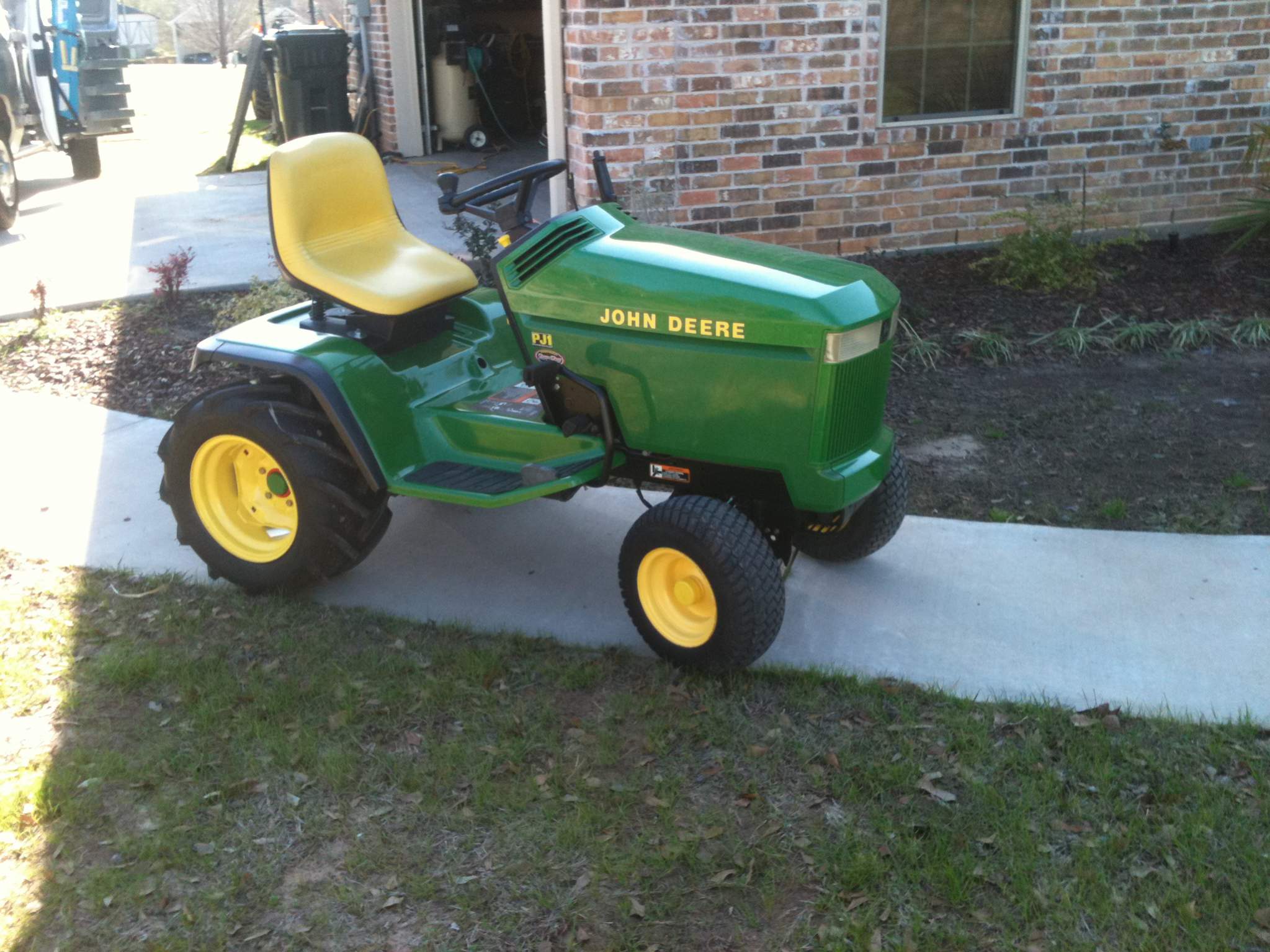

I love my GT 275....bought it new ,restored it recently and replaced the hood,new paint and tires as well
