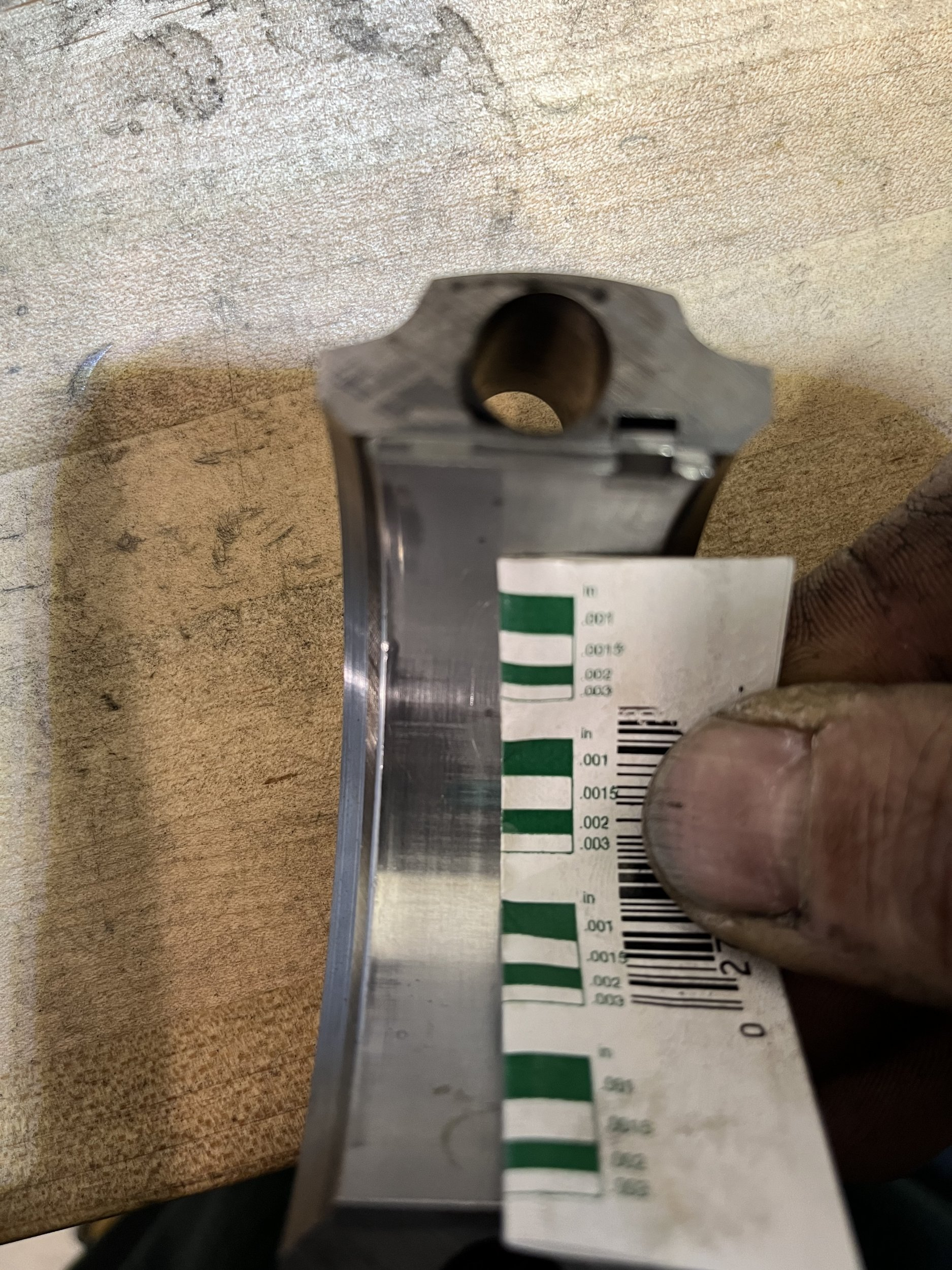

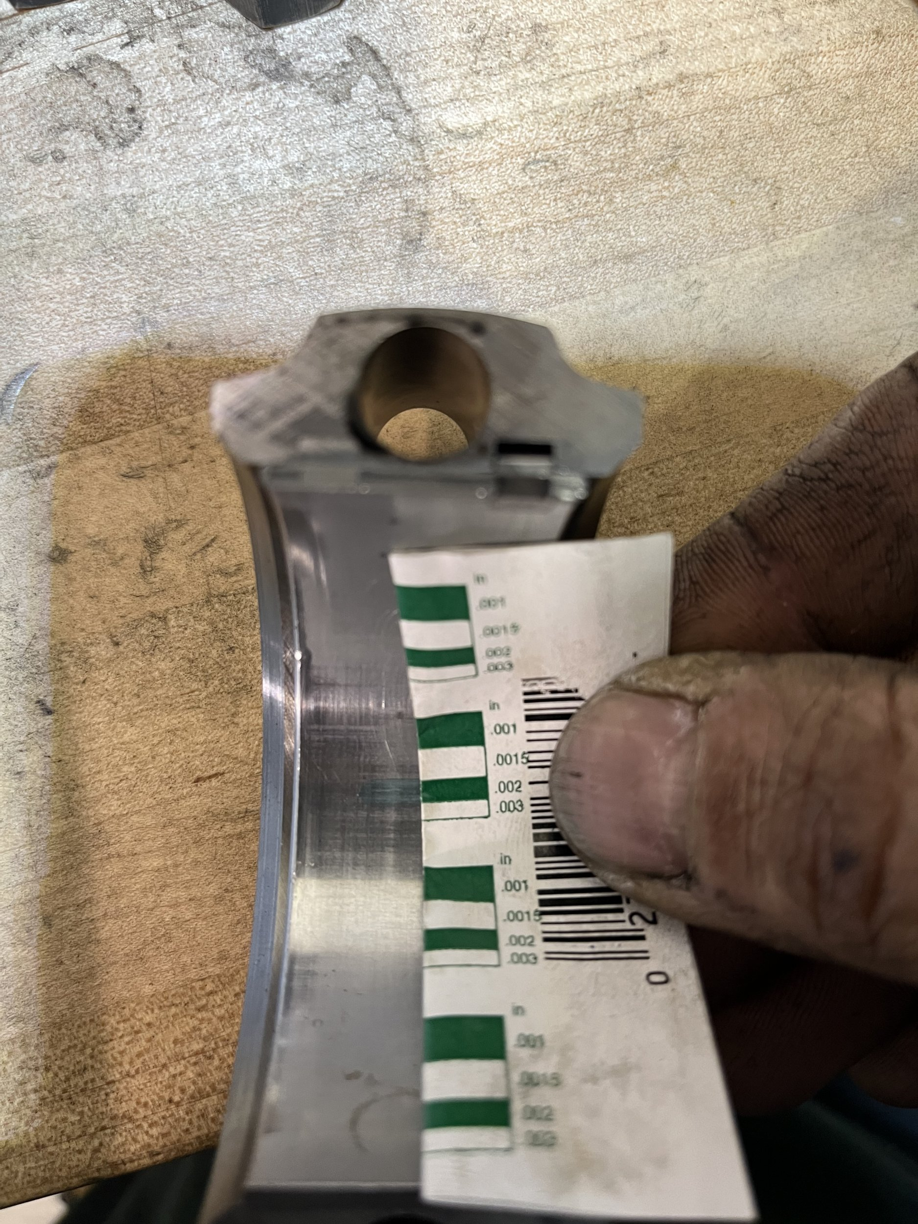

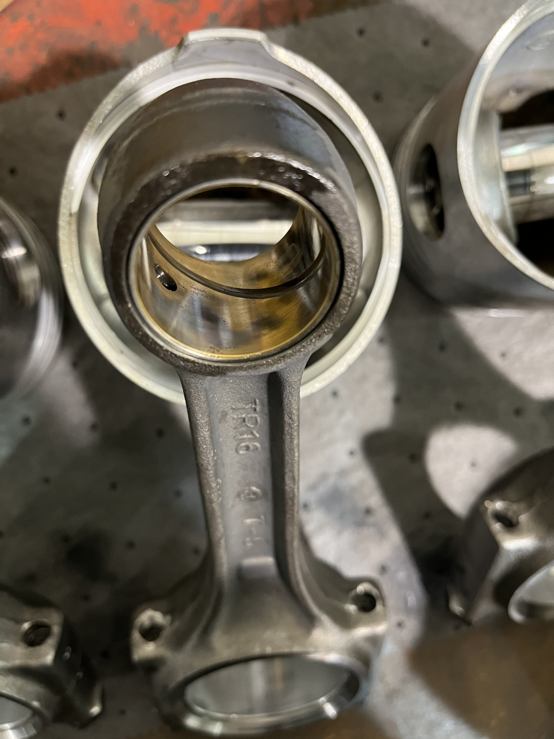

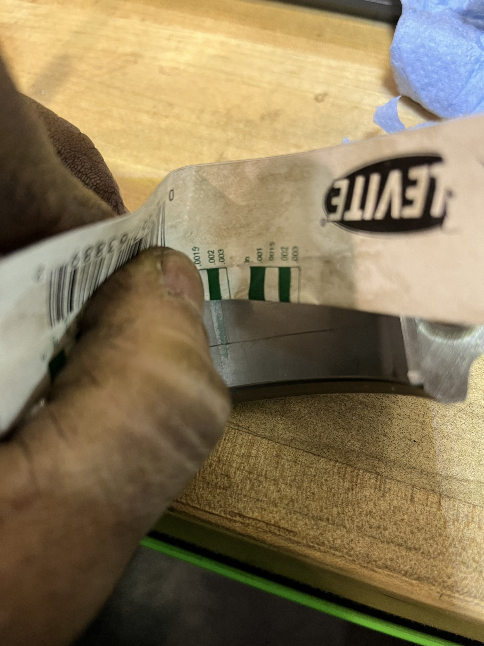

Got the rods back from the machine shop and started putting everything back together. New bearings showed perfect tolerances. Gapped the rings and got the bottom end buttoned up.

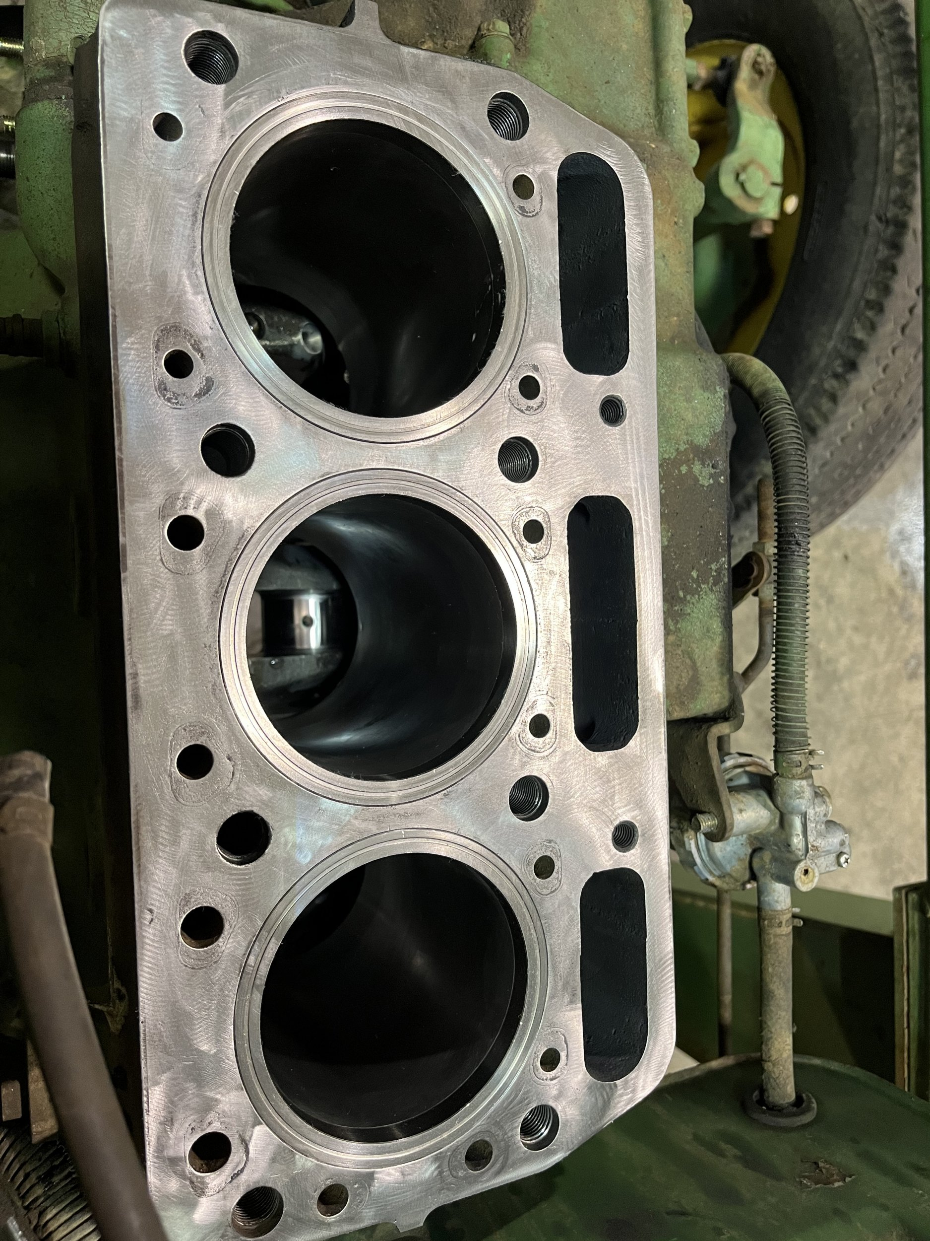

After I got the new head on everything was going well until it came to the intake manifold. It just wouldn’t tighten, tried several times until I took it back off and noticed it was cracked and spreading apart as I was torquing the nuts. Cleaned it up, welded the crack and resurfaced the gasket surface. I’ll put it back on in the morning and see how it goes. That’s all for tonight

/ JD 950 engine rebuild #27

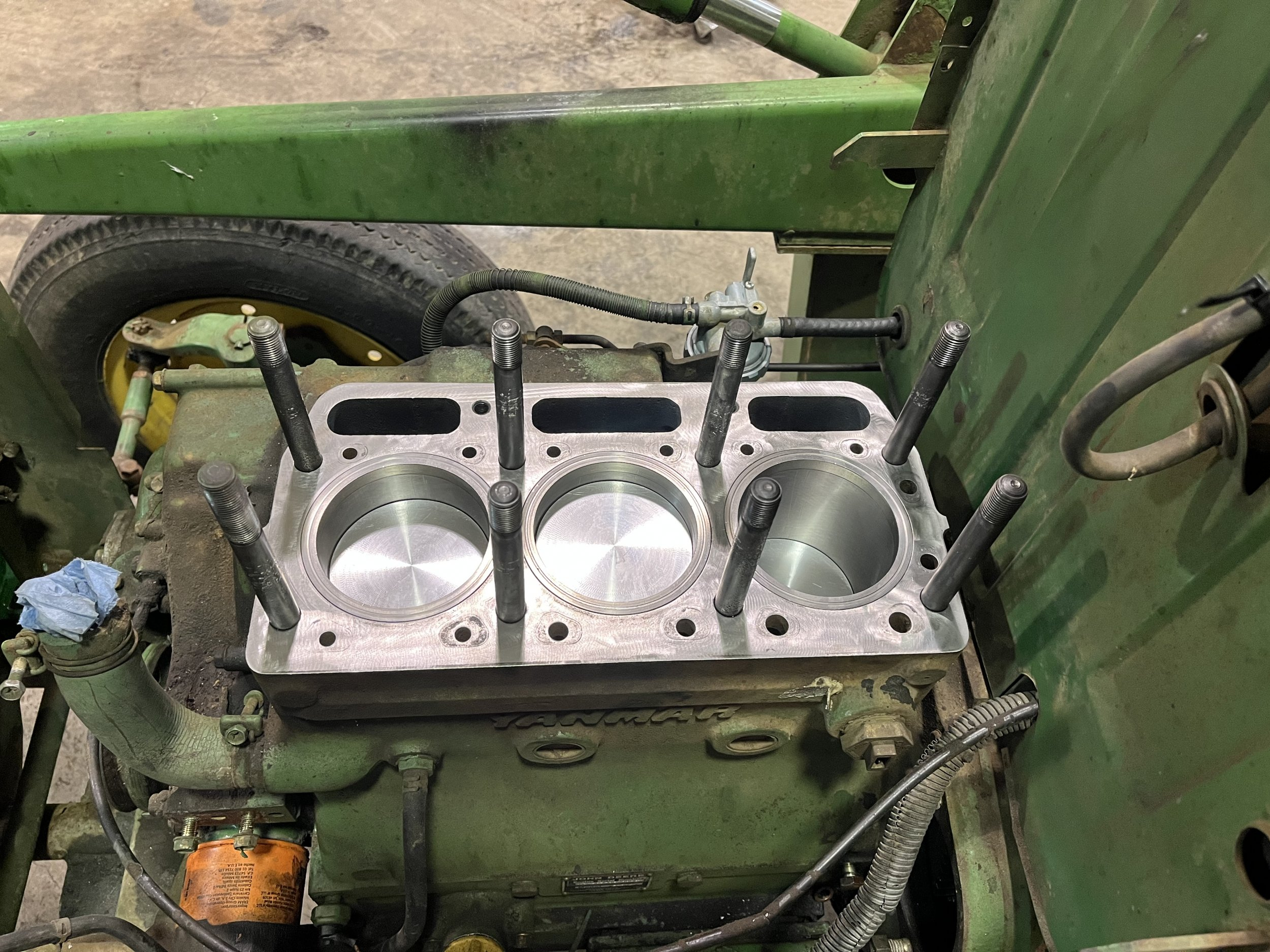

View attachment 725116View attachment 725117
See that SQ plug sticking out where the wire-harness goes to the inside of the dash. That is where the block heater goes. Those run about less than $40.
Oh, that all looks beautiful and clean.
