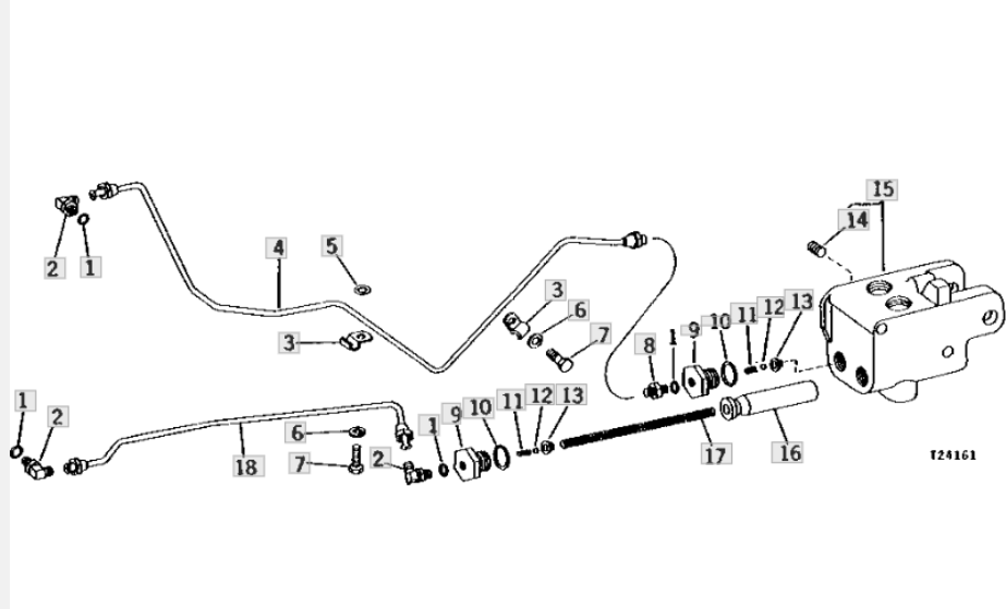

Can look up parts at the jdparts for the 920.
https://partscatalog.deere.com/jdrc/navigation/equipment/58556
Schematic of the screen location and what the hyd oil filter look like..
Note two different filter covers key #8 and #10 depending apparently on s/n
Thanks, that helps. So basically I'll need to drain the system, clean off the filter, then refill it in order to get the loader off the ground. (I realize there's way more involved in making the system actually right, but in terms of getting the thing back to the farm...)

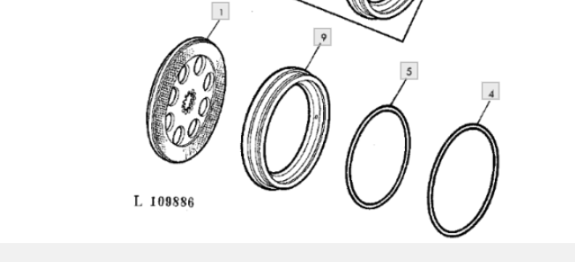

Due to the fact that nearly new JD tractors of this era suffered hyd failures I seriously doubt following the maintenance outlined in operators manual would guarantee tractor wouldn't have a hyd problem.
JD 20-55 series tractors had ""wet brakes IE operated in oil"" no matter if hyd system was open or closed center. To replace rear brake disk if required one must remove rear axle housings which requires draining of hyd oil.

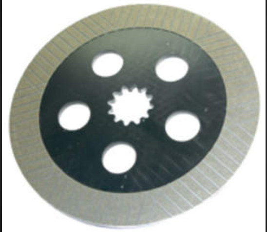

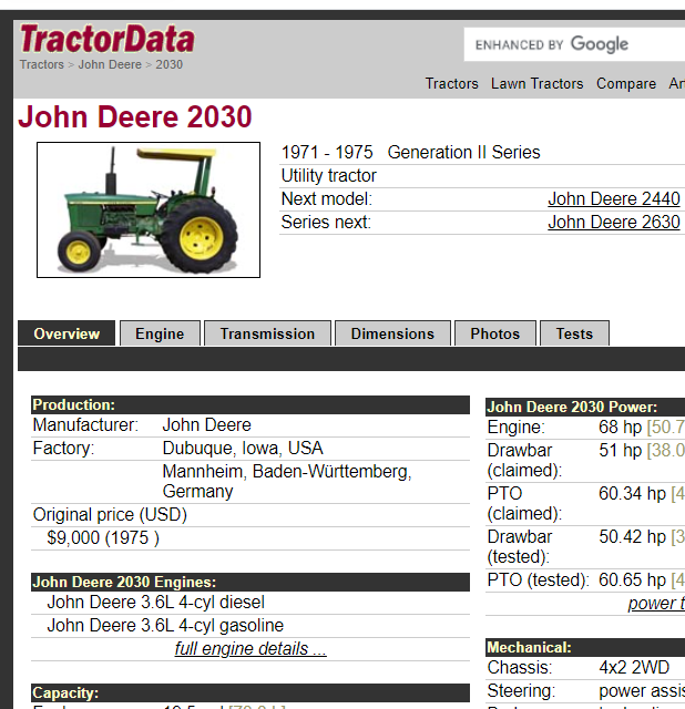

As I previously stated the JD 20-55 series utility tractors built in Dubuque,Ia,Mannheim,Germany or Saltillo,Mexico all have wet hydraulically operated rear brakes. I'm going to guess the bulk of the previous mentioned tractors were built in Dubuque & Mannheim factories with Saltillo coming in a distant 3rd place. Part keys 4 & 5 are designed to hold back oil & key 1 is a brake actuating piston. All models have a similar brake valve with hyd lines leading to each axle housing. There were no smaller lower HP JD 40 series & no 50 & 55 series utility tractors built in Dubuque! Only IIRC the 2 larger models such as 2440 & 2640 were built in Dubuque. Later model 2030 were built in Mannheim not Dubuque.
820,830,920 & early 2040 with 3 cyl engine are all very similar in respect to hyd systems. I was employed by a JD dealer from '66-'87 with 13 of those yrs serving as the service manager & I've never seen a 20-55 series JD utility tractor that was built in Satillo,Mexico & I live within 400 miles of Mexico.
I can guarantee you without a doubt that failed brake linings can be the major cause for hyd system failure on a 20-55 series JD tractor.
