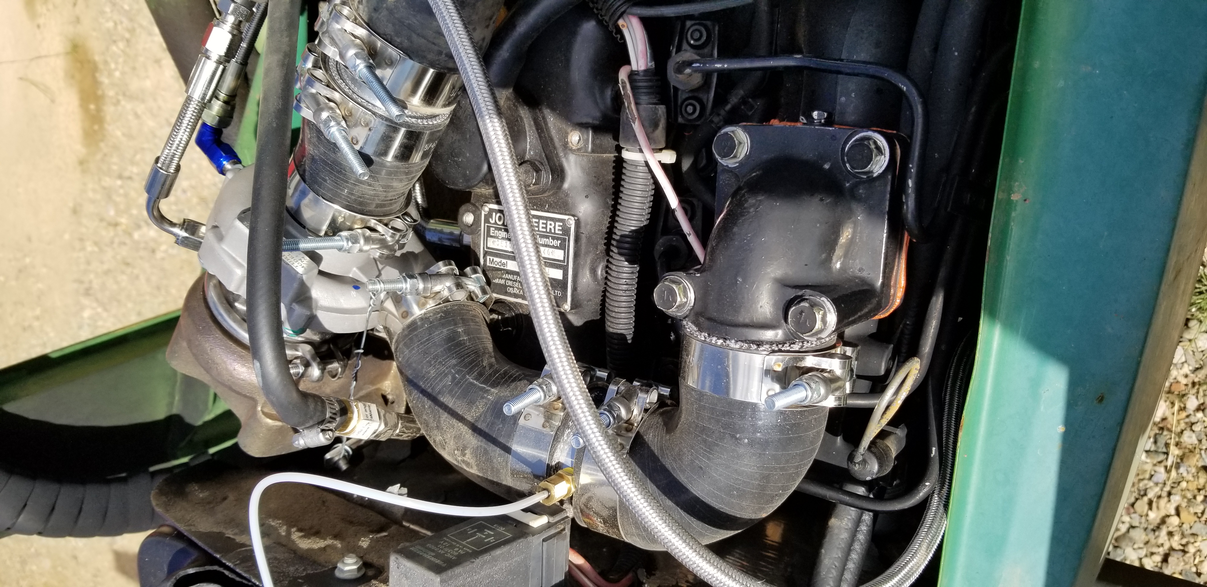

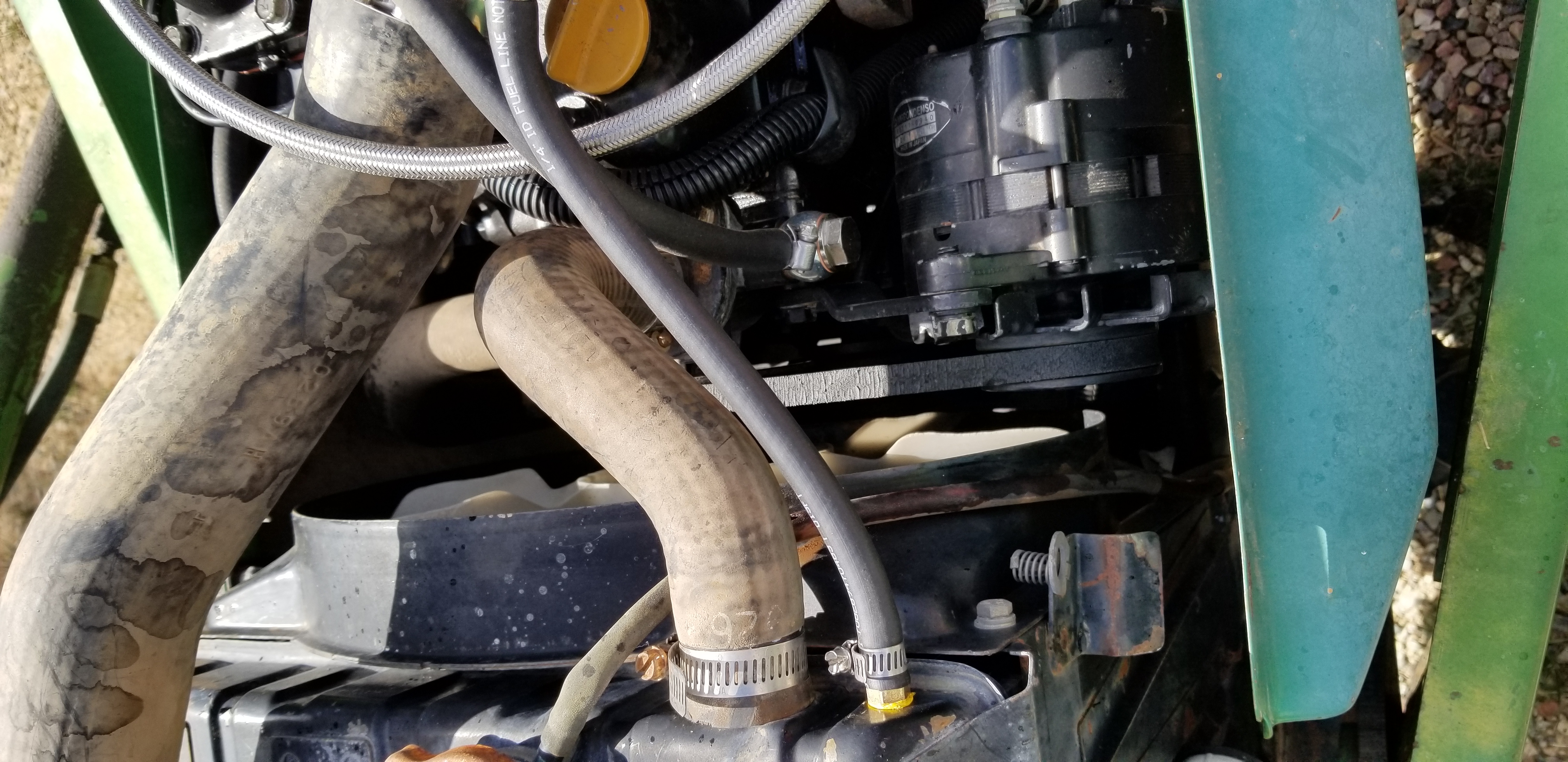

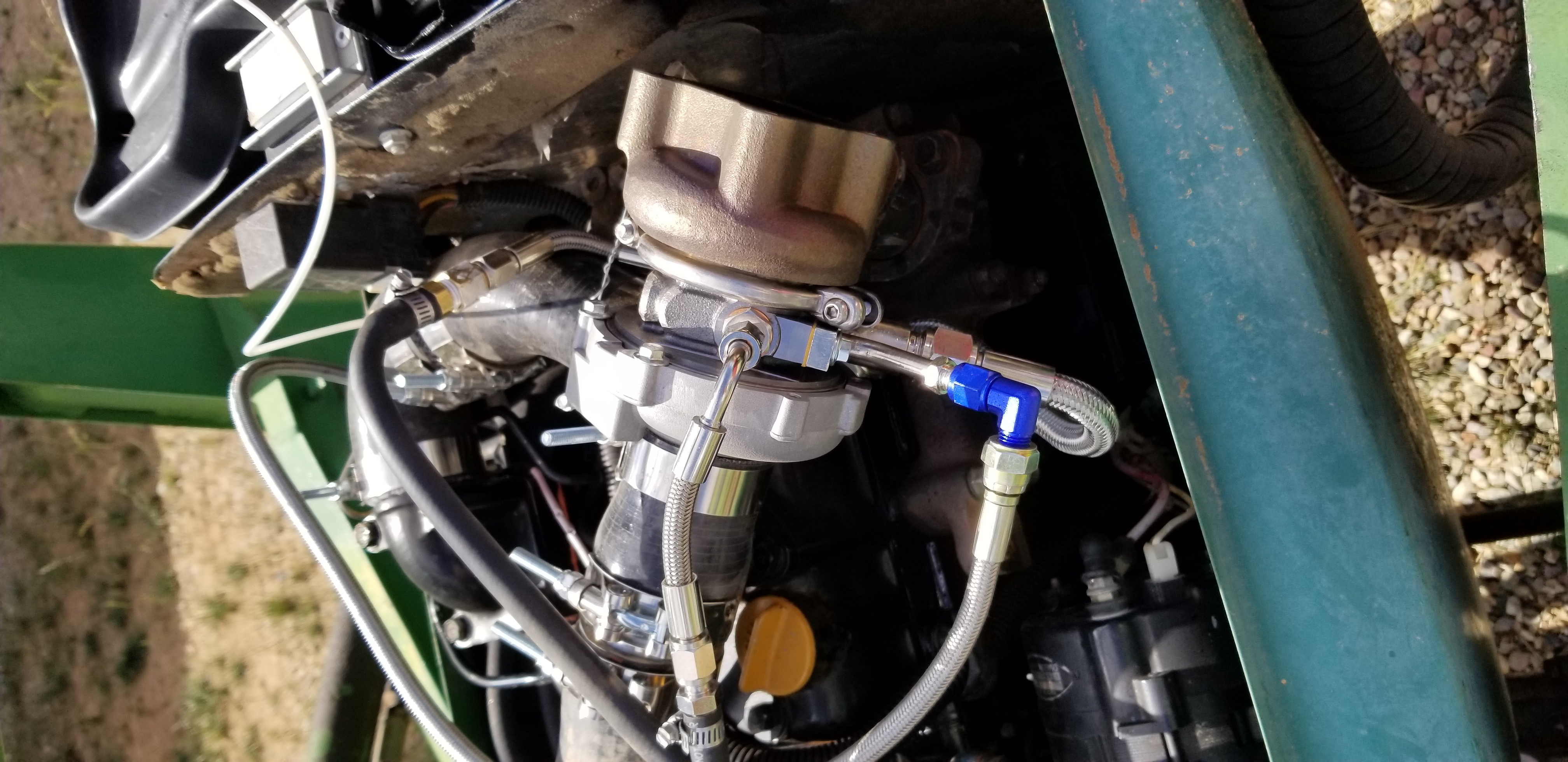

Got the GT12 installed which is nice with the watercooled center. Did a test run and am pulling 10psi boost at 7400ft msl and ambient of 85°. This is double the GT15. Just need to rotate the center housing so the feed lines will fit under the hood/cowlings. Very pleased with this result. Should really perform with a 3pt snowblower and the cool temps this winter.

First test run. Wastegate is safety wired shut. Got over 10 psi boost pulling up my driveway hill.

Wildbear i added a boost gauge last weekend. I am seeing 7-8 psi at full throttle under load.

I'm going to install an egt just out of curiousity.
I'm perfectly happy with the boost....especially since it was an 85degree day at 7500 ft elevation.

When I compare the 955 to my JD4105, I see the engines are virtually identical except the 4105 has a turbo.
The 4105 also has 40% more coolant, So I assume the radiator in the 4105 is way bigger?
Is extra cooling a necessity when you add a turbo?
