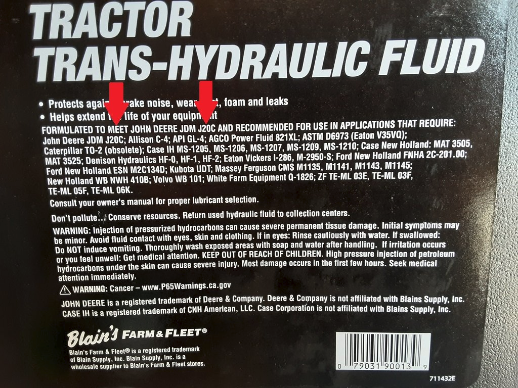

The Hoye video is helpful, however, you will need to DRAIN the hydraulic fluid to split the tractor. Or be very very very fast at plugging the suction pipe under the right side foot rest when you take the rubber hose jumper off.
I would drain the fluid. If you did a fluid change not long ago, then SAVE the fluid. You can filter it, then put back into the JD850.
ONLY use JDM J20C in our machines aka Hy-Gard or Yanmar TF500A. You can use store brand licensed J20C as well. it must state 'meets' and never compatible with.
   / JD 850 (Yanmar) Internal Clutch Linkage Issue
Thanks for the info BMaverick. I've gotten a lot of parts from Hoye over the years and I came up with that video yesterday and gave it a look. I also found one on Youtube of a guy splitting a JD 950. And I will take your advice on the hydraulic oil. I hope to begin the great undoing tomorrow and get down to splitting in the next couple of days.

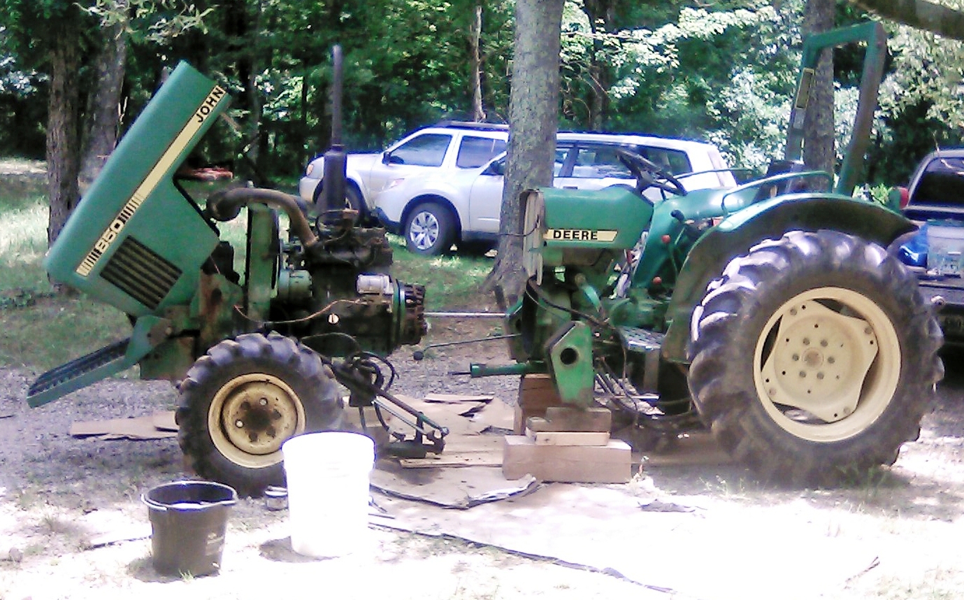

Hey hay! The FEL is off--first time ever. That's a start!

Got the JD 850 split today--it was a WAY easier job than I thought it would be. Very straightfoward. And when I got in there, one spring had come off the gizmo holding the throwout bearing that is attached to the clutch pedal linkage, and one surface of clutch pad had crumbled into oblivian, but I got lucky and all of my rotor surfaces came through unscathed! It seems that this is the original clutch and that the tractor had never been split before--so hey, put in a new clutch and call it good for another 40 years! Ordering parts tomorrow morning, and I think this should be just a regular clutch job at this point.
