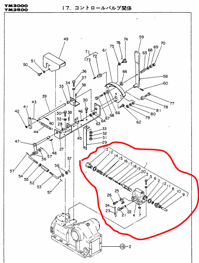

The three point hitch on this little tractor has either all the way up or all the way down positions. The control handle won’t hold at any point in between. Any thoughts for a solution?
/ JD 850 Compact Diesel #2

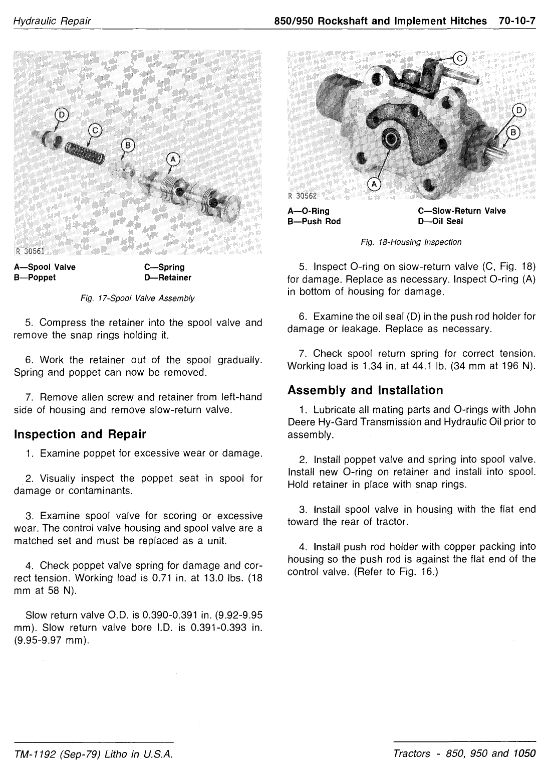

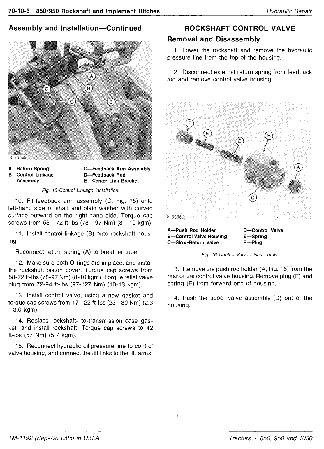

Did you follow the Troubleshooting section in the TM1192 manual? Section 70 & 270 covers this.
Basically, your JD850 in green paint is a Yanmar YM2500. If you can't find anything searching for the JD850, search then for the YM2500.
Under the seat is the hydraulic system. At times a seal, o-ring or gasket could get blow-by.
Those parts in the red circle above are in the TM1192
Then under the seat is the flower looking knob.
