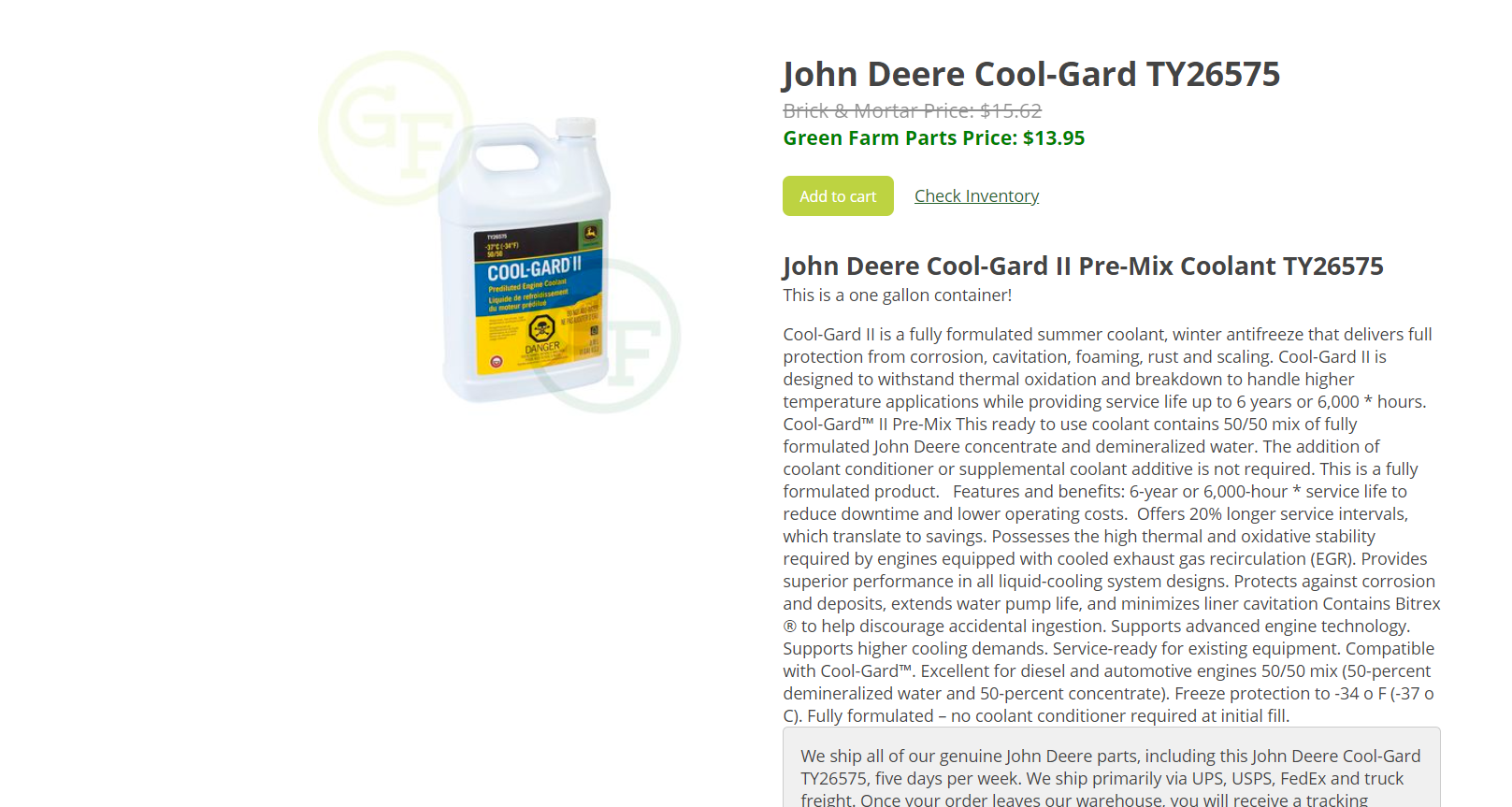

I like AF that meet the Cat EC-1 spec. It's called Extended Life Coolant (ELC) and a bunch of people make it.
Dang some people complain JD parts are high $$$$ but that Rotella AF is 2X as high as JD Cool-gard which is what I utilize in my diesel tractors. Cool-gard is advertised at being good for 6 yrs or 6000 hrs of use
I just picked the first one that showed. Tons of people make Cat EC-1 rated ELC coolant. I usually get mine from the local International dealer.
EC-1 ELC (or Ultra ELC) is the big favorite over on the various diesel boards I've been a member of over the years.
