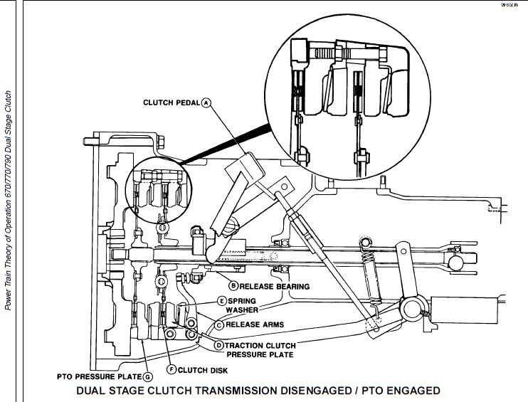

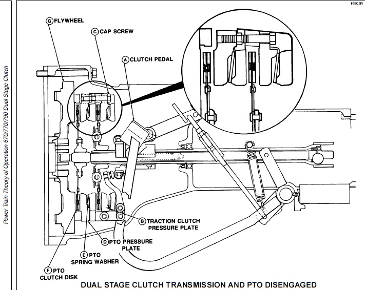

Looked up a schematic of the dual clutch engaged and disengaged on the tech manual and will post the two. Hope it helps your figuring. Now that you can get the tractor started with PTO engaged, maybe put some attachment on the PTO to try to break loose the PTO clutch. May not take much. I assume a tool (long screw driver?) can't be pushed through where you see the PTO clutch plate tight together?

beenthere - Thanks for these diagrams. They do help me understand what's going on. I did poke around with a screwdriver, but I was a concerned I might cause a biggrer problem. I tried breaking loose the clutch by clamping the clutch down, engine off and rear PTO engaged. I grabbed a hold of my snow blower second stage impeller and tried turning the PTO. I could turn the PTO shaft a little, and I could see through the access hole in the bell housing that I was turning the whole clutch/flywheel assembly. But I could not break the clutch free. I could just turn it back and forth a few degrees. I may try a longer lever on the PTO if I can think how to make one up. Thanks for your ideas.

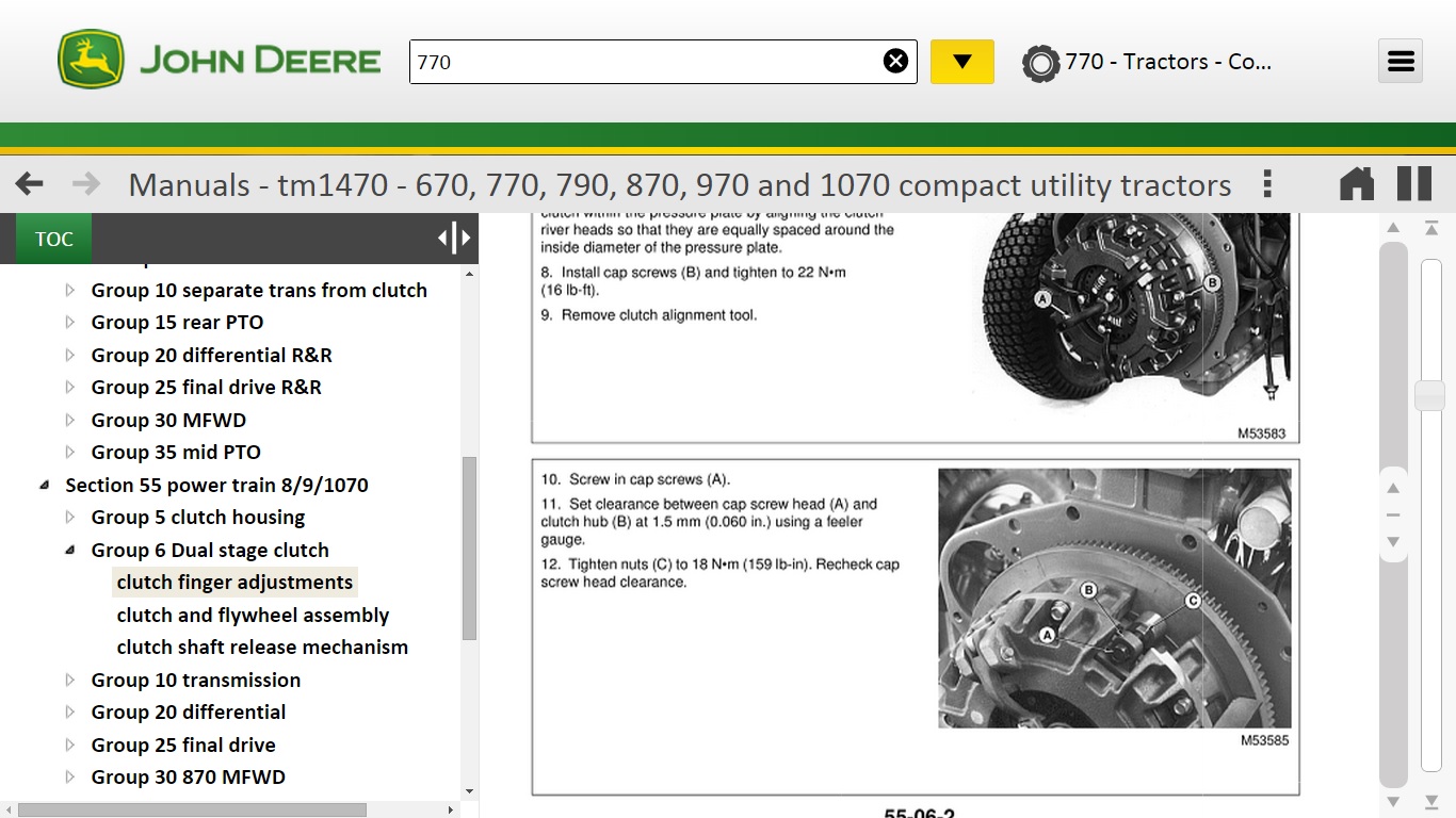

I770 clutch.jpg had forgotten there is a screen on clutch housing on the 770. On the 870, 970, and 1070 I have adjusted The pto though the holes in the clutch housing. I am attaching the picture of the adjusting screws. If you can see theses screws (3 of them) through the hole and can get wrenches on them to adjust them, you can get it fixed without splitting the tractor. Adjust these three screws to .060" under the head of the bolt. You will probably find this clearance now more than that.

IView attachment 405426 had forgotten there is a screen on clutch housing on the 770. On the 870, 970, and 1070 I have adjusted The pto though the holes in the clutch housing. I am attaching the picture of the adjusting screws. If you can see theses screws (3 of them) through the hole and can get wrenches on them to adjust them, you can get it fixed without splitting the tractor. Adjust these three screws to .060" under the head of the bolt. You will probably find this clearance now more than that.
jd110 - Thanks for the photos. Very helpful. I might be able to get to those bolts. I haven't figured out how to turn the assembly more than just a little using the PTO. If it were a gas tractor, I'd take out the plugs, but with the diesel, hand-turning the engine is a problem. We're going to have a few days of very cold, bad weather, and I'm working outside. When the weather improves a little, I'll give this a try. I might be able to "bump" the engine around with the starter. I saw that your photo is from the TM1470 manual. I went ahead and ordered the manual on CD from John Deere. Thanks.
