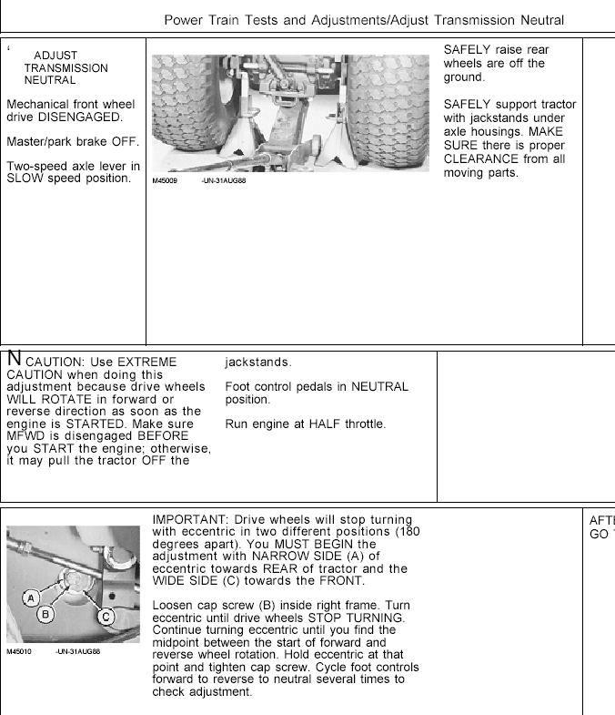

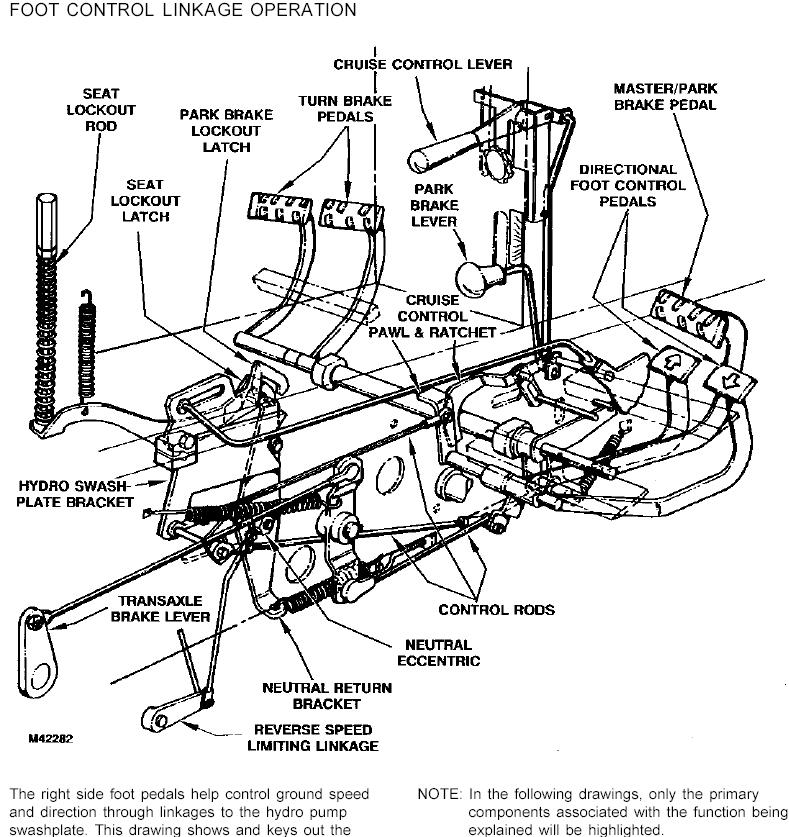

I hope this helps. This is from the tech man'l and what it says about the eccentric. I included a second one of the linkages that may or may not be of any help. I don't know how you are to turn the eccentric after loosening the cap screw (apparently by hand) and then hold it while tightening the cap screw. If you find out, let us know. ;)

The eccentric is a large hex nut. You simply put a wrench on it (between the inside of the frame rail and the transmission) and turn it. It's a simple procedure... I've done it several times.

Mine wasn't.... I had to hold the eccentric with a wrench exactly where I wanted it while tightening down the lock bolt.
/ JD 755 slow creep forward #10
Ok, so there are two hex "nuts"...a large to turn the eccentric and a small to lock it down. Prolly both are metric.

Then I would suspect sticking control rods, etc. Maybe time for a pressure cleaning, and some light oiling?
/ JD 755 slow creep forward #13
Usually when I can't get one adjusted, it is because the bolt holding the cam on the hydro has come loose. It allows enough slop in the adjustment that it creeps either forward or reverse. Bolt #22 goes through cam#21. tighten this bolt and see if that helps.
