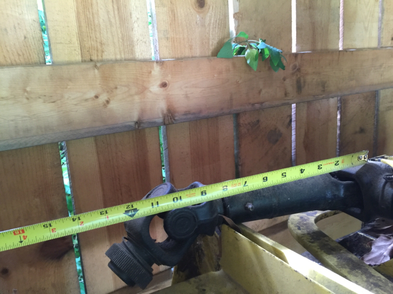

Fully collapsed, 10" yoke center to yoke center. The inner(shaft) portion protrudes about 1", suggesting extended length that dimension would grow to about 18" if only 1" of engagement.

Thank you Jerry. I will let you know how it goes when I cut the shaft down.
Thank you for all of your help.
