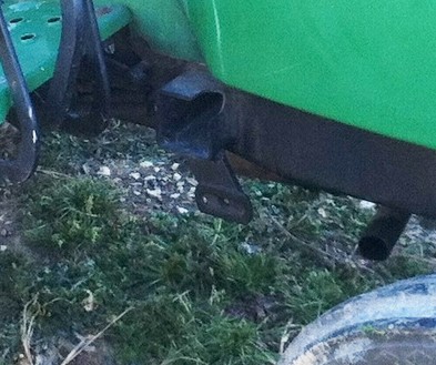

I am in search of a little advice and probably some dimensions. I purchased a 60" belly mower for my 755 and upon installing the mower I have found I am missing the rear draft arm mounts. I thought this to be weird and uncommon. Has anybody seen this? I am assuming I will need to fab up my own brackets and weld them on as it looks like there were supposed to be welded on at the factory and is probably not a purchase able item. If I could get a little help with some dimensions on location and for the bracket that would be great. I have attached a couple of pictures of what I am missing.

I will try to help you. My 755 looks just like the closeup photo you attached. Does your machine have the square tubing stubs shown (which are used for the FEL rear mounts) or are those missing too?
/ JD 755 Mid Mower Mount Missing
Jerry thank you for the help. I do have the square stubs as I do have a FEL attached to the machine. After closer inspection it looks like someone cut them off. I am not sure why someone would do this but who knows.

I still need to get you the side-to-side spacing, and I will try to measure the angle between the down strut and the horizontal slot. Let me know if there's more details that would be helpful to you.

Thanks for the PDF file that helped a lot. I drew it up on CAD and add a couple of comments. Let me know what you think.

Your CAD drawing looks good to me, and accurately captures the dimensions I reported. Just several thoughts to add:
The side-to-side spacing, measured between the outboard sides of what I labeled as piece "B" is 16 1/16, plus or minus 1/16. I think there's room for some slop in this measurement due to the length of the draft arms.
The angle which you show as 32 degrees I "measured" as 28 to 30 degrees using a protractor. There wasn't enough room to firmly place the protractor against the hanger, so I was eyeballing parallel to estimate the angle. Obviously, that angle is not critical so long as the through hole for the pin is in the right location.
I recommend you measure the diameter of the pins on your mower and use that that set the width of the slot in piece "B" and the diameter of the through hole. My mower is currently high on the wall in my barn where I can't easily measure my pins.
I suspect that pieces "A" and "B" were fabricated from metric bar stock, since their measured thicknesses are close to 10 mm and 5 mm, and the width of piece "A" is close to 50 mm.
Good luck with your build, and let me know if I can be of additional help.

I did get the parts fabricated and welded into position. I have slight problem but I do not know if it is the brackets I welded on or there are different length draft arms. When I attach the drive shaft to the PTO the I am unable to attache the rear draft arms. Looks like the drive shaft is too long. But if I don't attach the drive shaft and attach the rear draft arms to the new mounts I am unable to attach the front draft arms to the deck mount as they are to long. Something is a miss. Any suggestions? Do you know if there are different front draft arm mounts? I do believe there are different PTO drive shafts. The unit I bought came off an 855 but from what I understood the mounting position on the frame changed.
