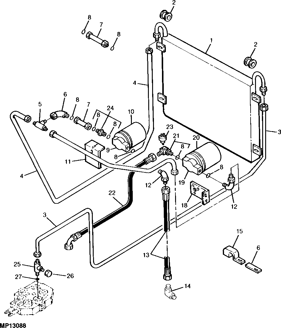

Did you also change both hyd filters when you cleaned sump screen?
MG9800098 FILTER ADD 16.29 USD
PMHF28810 HYD. FILTER ADD 20.81 USD
