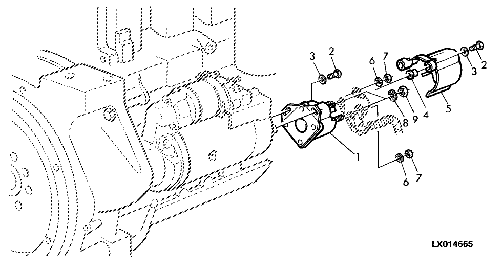

I've thought of something else that could give starting problem. The starter relay(parts key 1) as in sometimes they loose their ground(earth) connection.
Its worth looking at tx jim. Thanks for the input, it all helps 👍
