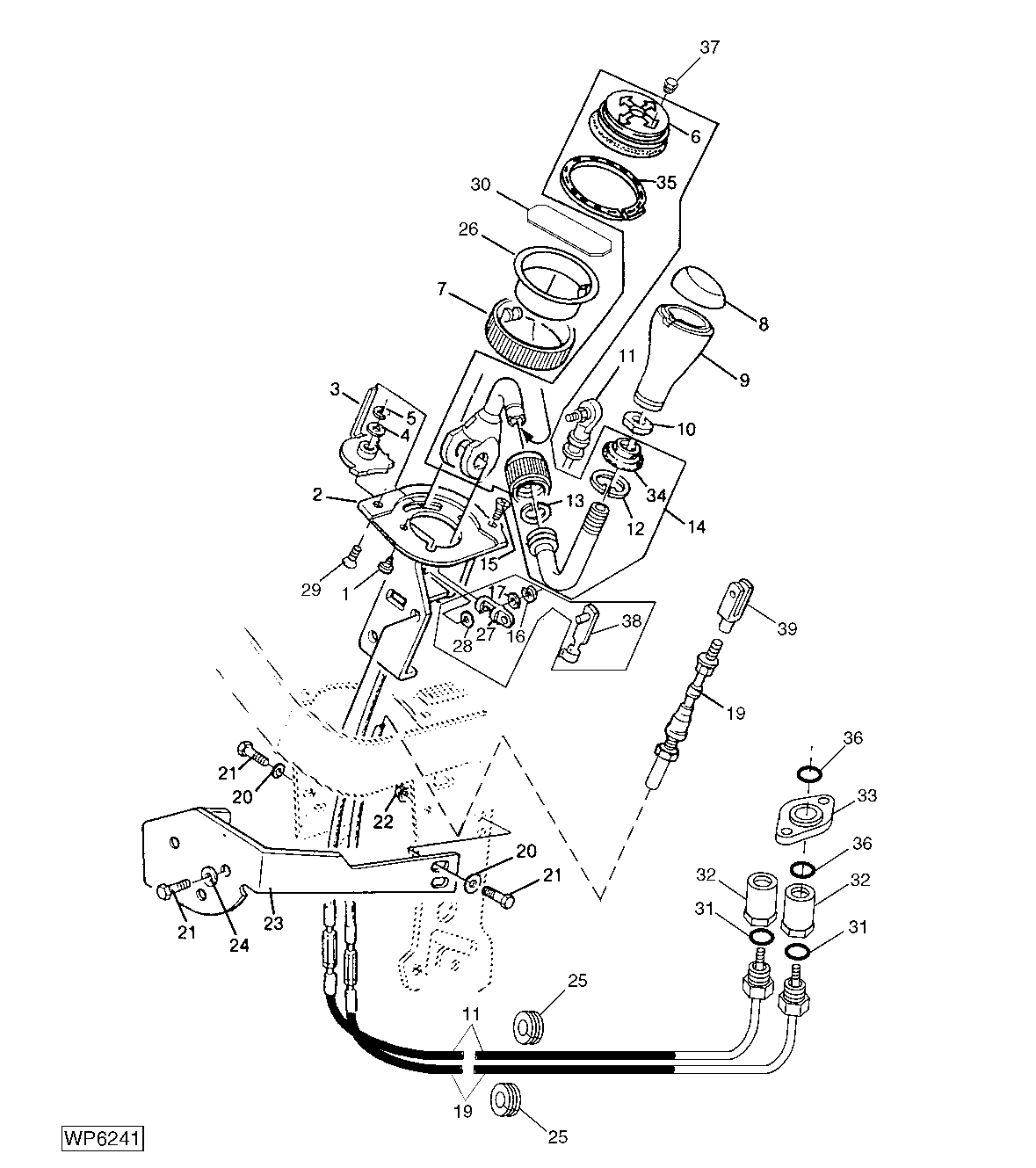

I am using a 1999 JD 640 with no operators manual and have found myself in a predicament that may just be finger trouble, the up and down and dump and scoop joystick will not let me operate the controls and is stuck in bucket dumped and down position turning on the engine causes the front wheels to come off the ground (scarey)pushing forward gets it to ground level but no more control. It was working for a day(all controls) then I was told to press the joystick forward and right and the plastic knurled ring under the joystick boot to where a pad lock is visible . I did this and it wont come out of that position and the tractor is stuck in this mode (useless) to continue. I may have inadvertently pushed pressed or switched something to make the joy stick un responsive """""HELP""""" Please

You need to work with the plastic ring below the lever boot. It can be hard to turn and get the gates in the proper places so the joystick will respond. It can lock out all functions, lock the boom and allow the bucket to operate, lockout the bucket and allow the boom to operate, or allow everything to operate.
Try moving the joystick and at the same time turnng the lock ring. Tractor need not be running to do this.
My 640 loader is a 2006 and it (lock ring) does not work properly, so I leave it for all functions to work. Poor design in my opinion :mad:

Is your loaders joystick "in console style" or out of console?? I downloaded a schematic of the parts of the out of console style JS(I was guessing). Maybe that will help you unlock it.
/ JD 640 front loader 1999 help
I believe it's in console and is similar to the great schematic u sent but there is no rubber boot which leads me to believe there may be some subtle changes between in and out console type , if you had one of the inside that would be greatly appreciated.
Thx Wayne
/ JD 640 front loader 1999 help #8
Here's the other photo.

/ JD 640 front loader 1999 help #12
Zebra5,
Do you know which way it should turn if the boom is currently locked out but the bucket curl and dum still function? That's where I am right now and can't tell what the pictures on the ring are supposed to line up with...
/ JD 640 front loader 1999 help #13
Zebra5,
Counterclockwise. You are at the last position if only the bucket operates. Next will be only boom, then all, then all locked. Poor design
