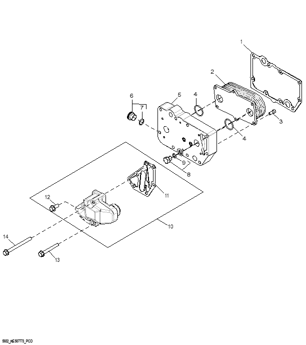

JD 5603, 6815 , Kubota L5740
We have A John Deere 5603 and upon checking the oil this past Friday found it to be 4 1/2 qts low. Filled it, blamed the operator for not checking the oil and sent it out . A couple hours later it was running hot. found oil in the cooling system. I suspect maybe engine oil cooler seals leaking but haven't made it to that part of my research. Any one have any thoughts or experienced this ?

I agree that engine oil cooler is the place to start diagnostics.
   / JD 5603 OIL IN RADIATOR
I haven't found in the manual that it has an engine oil cooler, only hydraulic oil cooler and that's external in front of the radiator. I have A feeling the heads coming off !
   / JD 5603 OIL IN RADIATOR #7
My neighbors 5603 had a leaking engine oil cooler. They resemble this parts photo.
Thanks so much. I located where its at and Ill be pulling it tomorrow. Easier than pulling the top end , hopefully that's as far as I need to go.

Update, removed the cooler and took it to our local radiator shop. Held 50 lbs. with no leaks. Didn't want that outcome ! I guess its head time !
