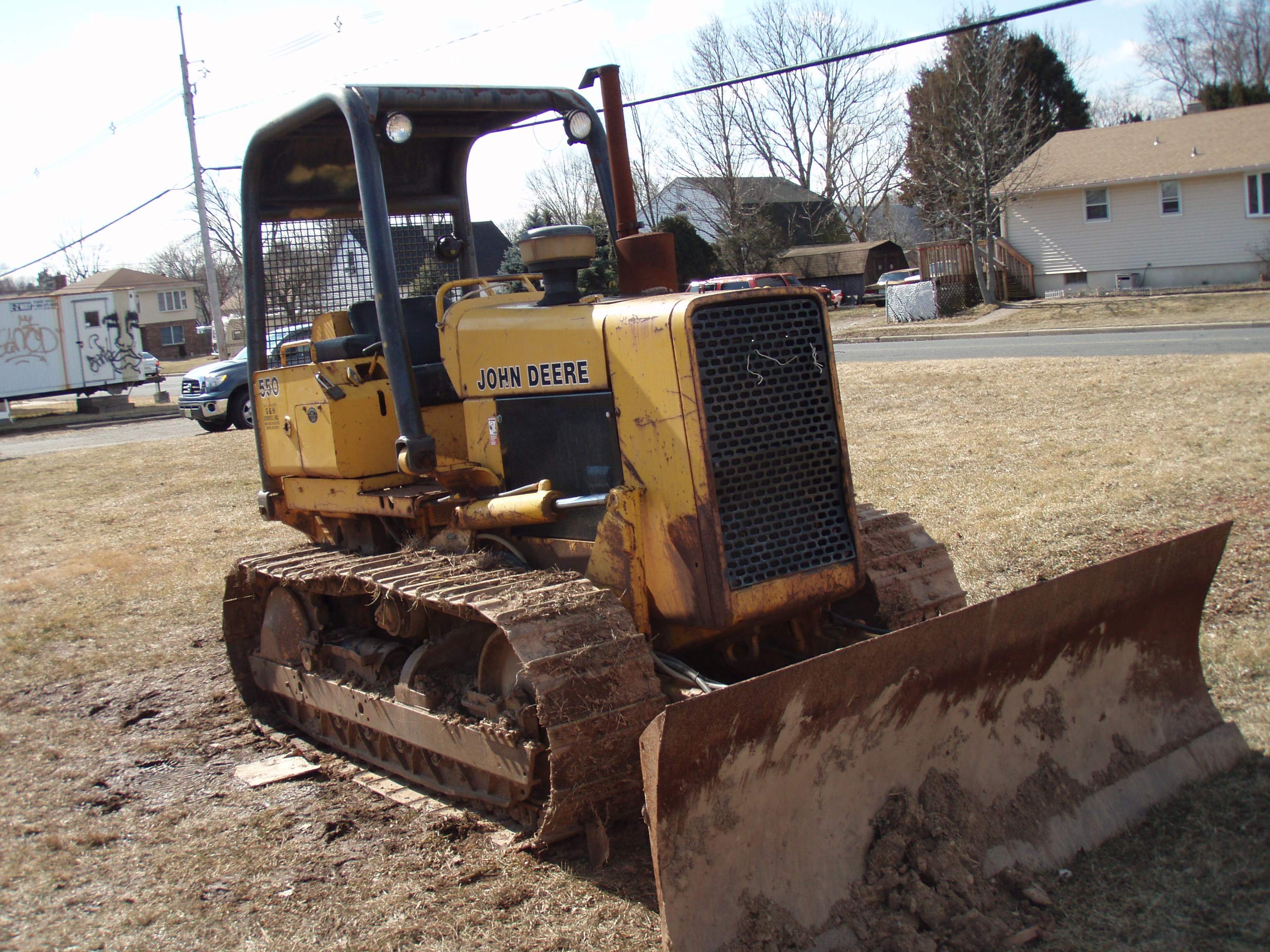

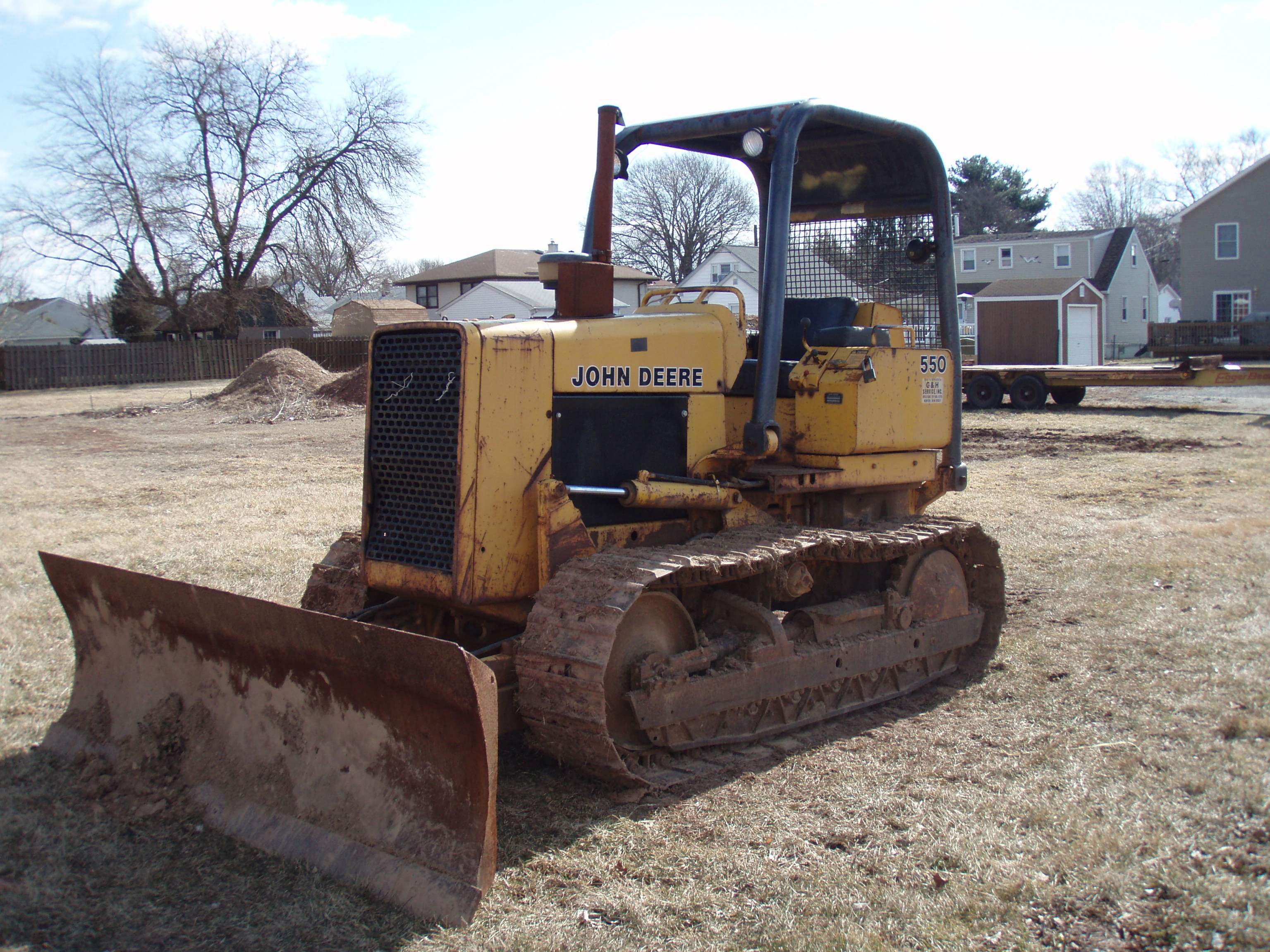

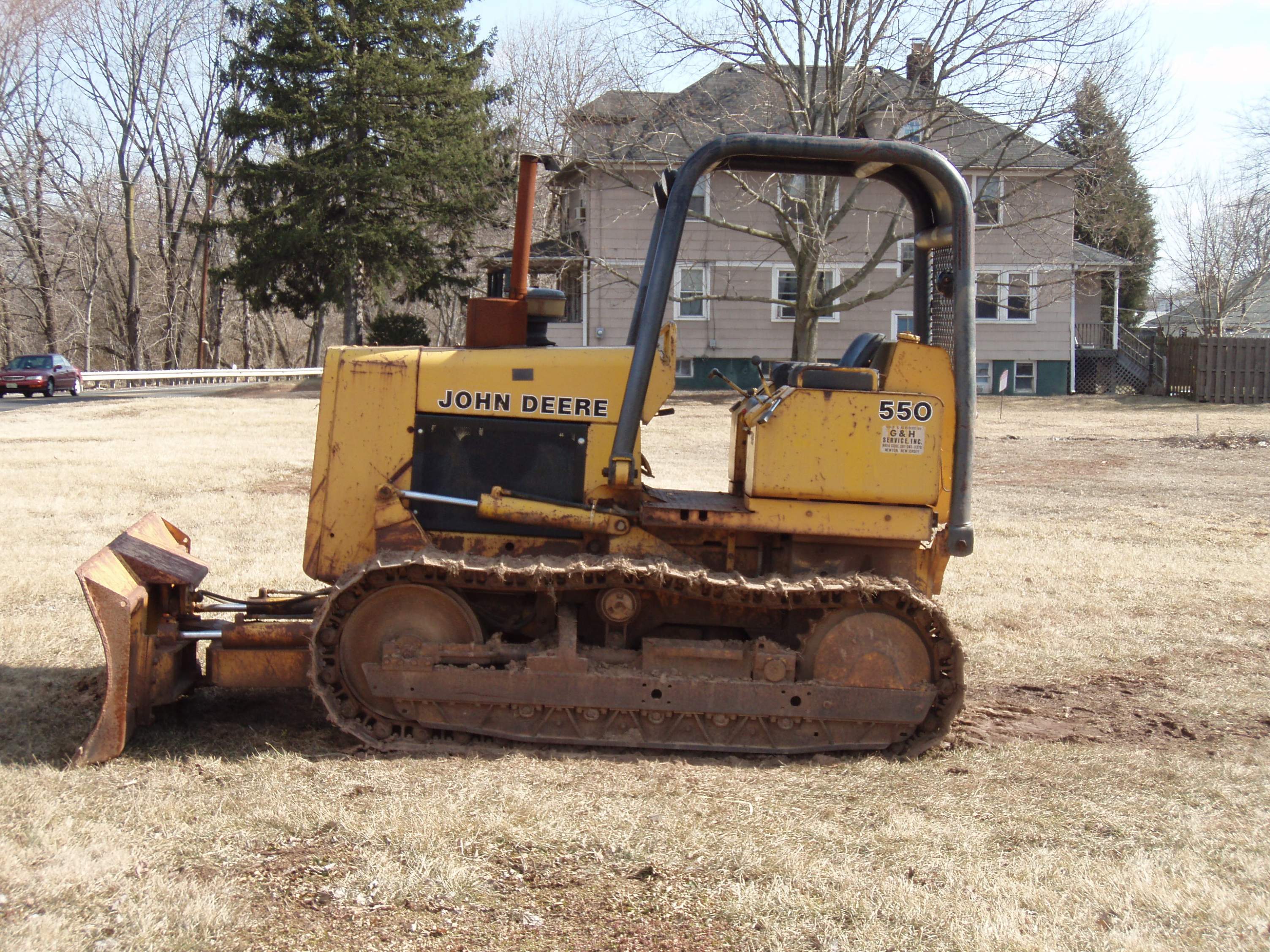

For those of you that are interested I snapped a few pictures of the JD 550 for your viewing pleasure, enjoy. I will keep you all posted as this all gets sorted out.

The machine looks to be in good shape. Track wear/drive gear - good to go; lot's of hours left.
