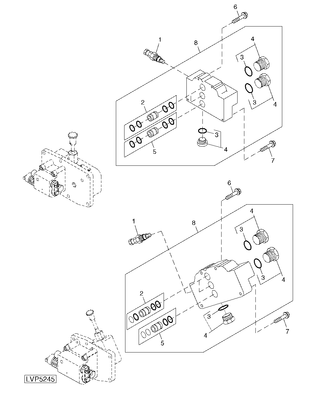

Found this from a older
Post 1996 year tractor number one is relief valve
