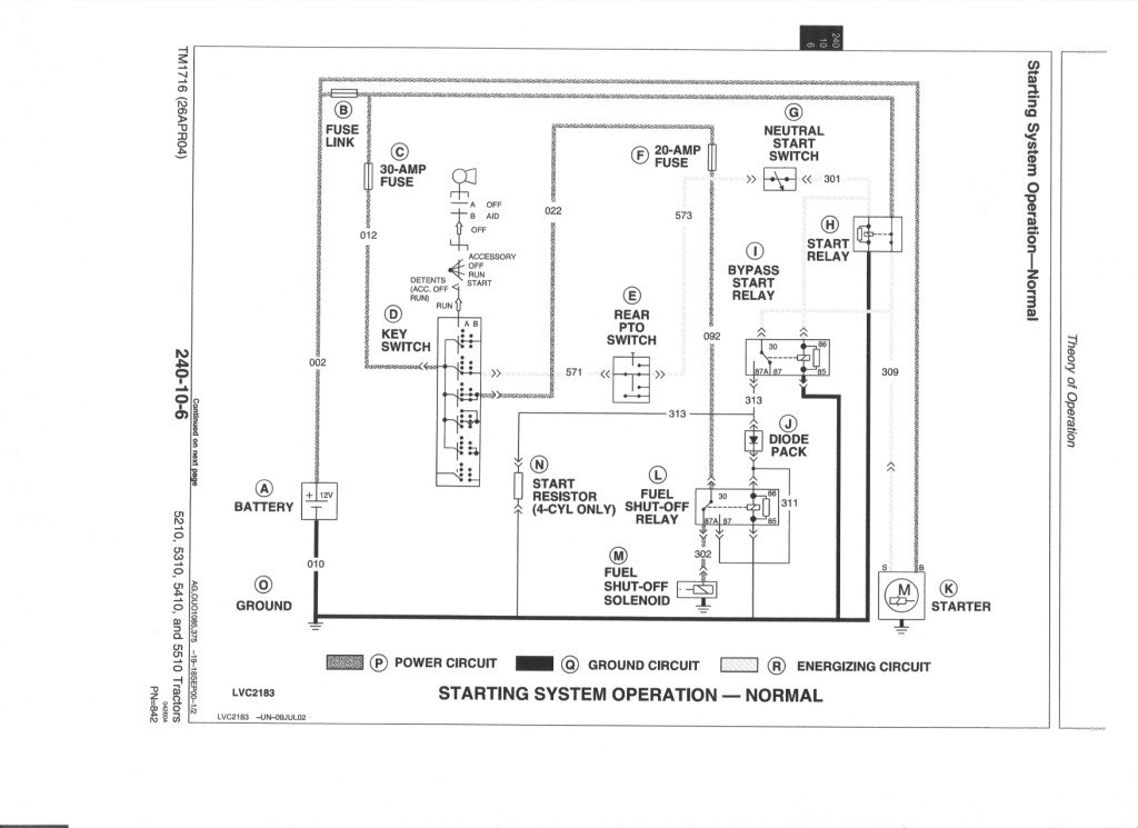

+1 to TX Jim advice. I would also check the fuses mainly the 30 amp (link to manual included if needed). Since you had left it in gear, could be the neutral switch got stuck, I would check that.
http://manuals.deere.com/omview/OMRE199128_19/?tM=FR
I have attached the starting system for the 5X10, should be close to yours.

Check if voltage is making it to the solenoid's coil when you turn the key. If not, there's probably a problem upstream (key switch, interlocks (pto switch, neutral position switch, etc...) etc...).
