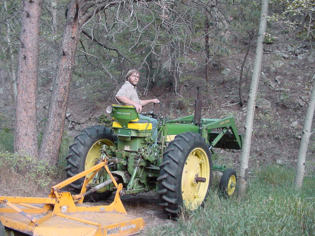

Well, it finally happened. The old JD 530 needs a repair. Runs just fine, but leaving a trail of gassy oil behind so I checked it and found that the crankcase was overflowing with gas in the oil!
I swapped out the needle and float, changed the oil and filter, replaced the aftermarket manual gas shut off valve I had added to the fuel line to the carb 20 years ago, - all to the tune of about $125 - and then drove it around to see what happened. Everything worked like it has for the past 30 years, so I shut it down, closed the aux. gas tap and left it. A few days later I for no good reason went over and to check the oil and it was gassy and the crankcase full to nearly overflowing again!
Wonder what's going on here? I think I know, but thought I'd ask first.

You mention that you installed an auxiliary gas shut off valve, but does it still have the original sediment bowl? If so, most of the later two-cylinders had an automatic shut off for low oil pressure. As part of the sediment bowl there is a diaphragm where oil pressure turns on the flow of fuel.
Over the years those two rubber disks wear out. Any JD dealer that has two-cylinders in the area should stock them. You might also want to get the flat o-ring that goes on the automatic shutoff as well.
To replace is quite simple. Drain the tank of fuel. Remove the oil lines. Take off the glass bowl for clearance. Unscrew from the tank. With a pencil mark the orientation of the center cast disk that the oil line attaches to. Take out the screws holding the stamped steel top onto the cast body. Take the clip off the fuel shut off plunger and remove the spring.
Replace the flat o-ring and reassemble with the two new rubber disks. Make sure to include the small button that goes between the two rubber disks in the hole of the cast piece that the oil line attaches to. If yours is missing, replace it. Then matching up the mark you made earlier finish putting back on the tractor.

Yes, I've still got the original sediment bowl with the oil pressure-controlled diaphragms. I added the inline manual shutoff about 30 years ago twhen the auto shutoff feature failed in a way that kept pressure on the carb float. Yes, rubber parts do have to be replaced periodically, and I've wondered if it's just me or is the time interval becoming shorter between replacement? Possibly today's gasoline is different from the older type. Anyway, it's much better to be able to shut off the gasoline feed when it's not needed.
Thanks for the very complete post on replacing the diaphragm. I agree that's a good bet about what is going on. I'll be replacing those parts when the weather clears up. It's -22F today.

I thought I'd take a moment to close out this thread. Yes, you were entirely correct. Gasoline was leaking internally in the OEM sediment bowl.....that's the sediment bowl peculiar to the last of the two cylinders and it features an set of internal oil-pressure driven diaphrams to automatically open or close the fuel feed to the carb. It saves the operator from remembering to manually turn the gas flow on/off.
One of those diaphrams had a split in it which allowed gasoline to backflow through the oil pressure pipe and down into the sump when the engine wasn't operating. That's a slow process, but give it a few weeks and it will fill up the sump.
The fix was simple: new diaphragms and a sediment bowl rebuild. Which I did. Then I took my dealer's advise and replaced the entire fuel sediment bowl assembly with JD's manual replacement featuring a good old finger-operated on/off switch. The rebuilt OEM unit is now on the shelf in the barn!
