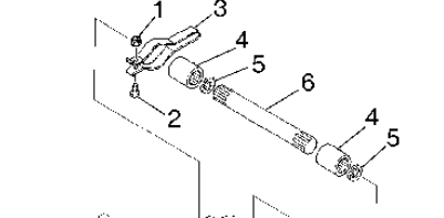

According to JD parts one needs tractor serial number & trans type to order correct clutch parts. Function of hyd's has no bearing on pto operation. Pto shaft spinning while disengaged is probably due to worn brake spring(parts key 3)

Kind of figured I would start with Clutch assy and then if it is the brake then work on that. I just need to get my PTO up and going so I can mow.
