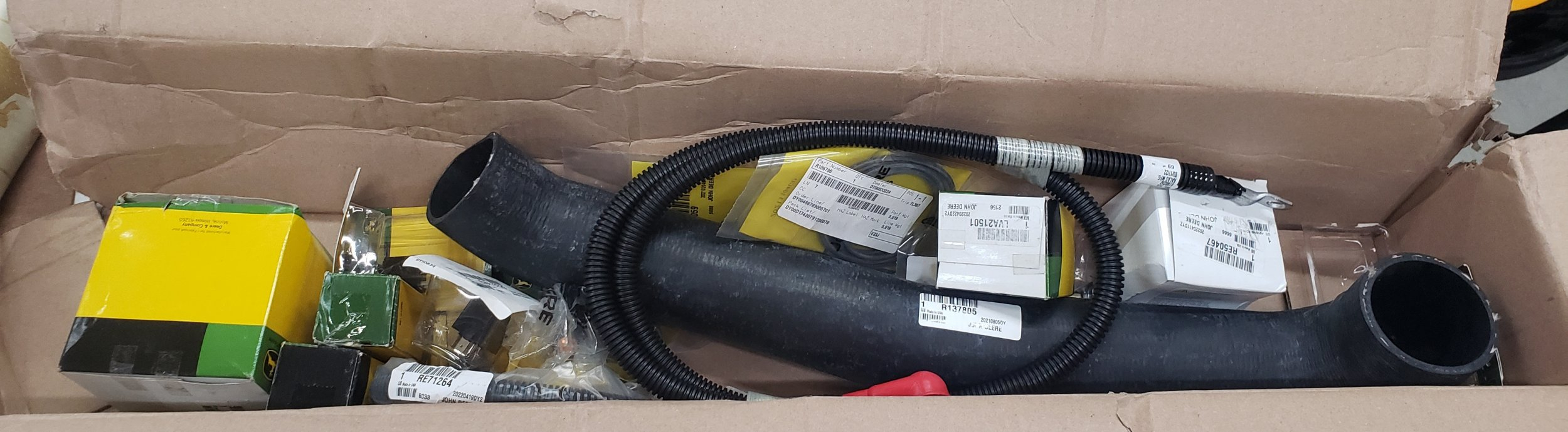

Got a few simple things fixed. I also started building the new fuel head. I'm waiting for my filter order to arrive though.
My box of parts lost a couple of things along the way, but the company is shipping out replacements.

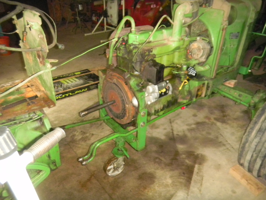

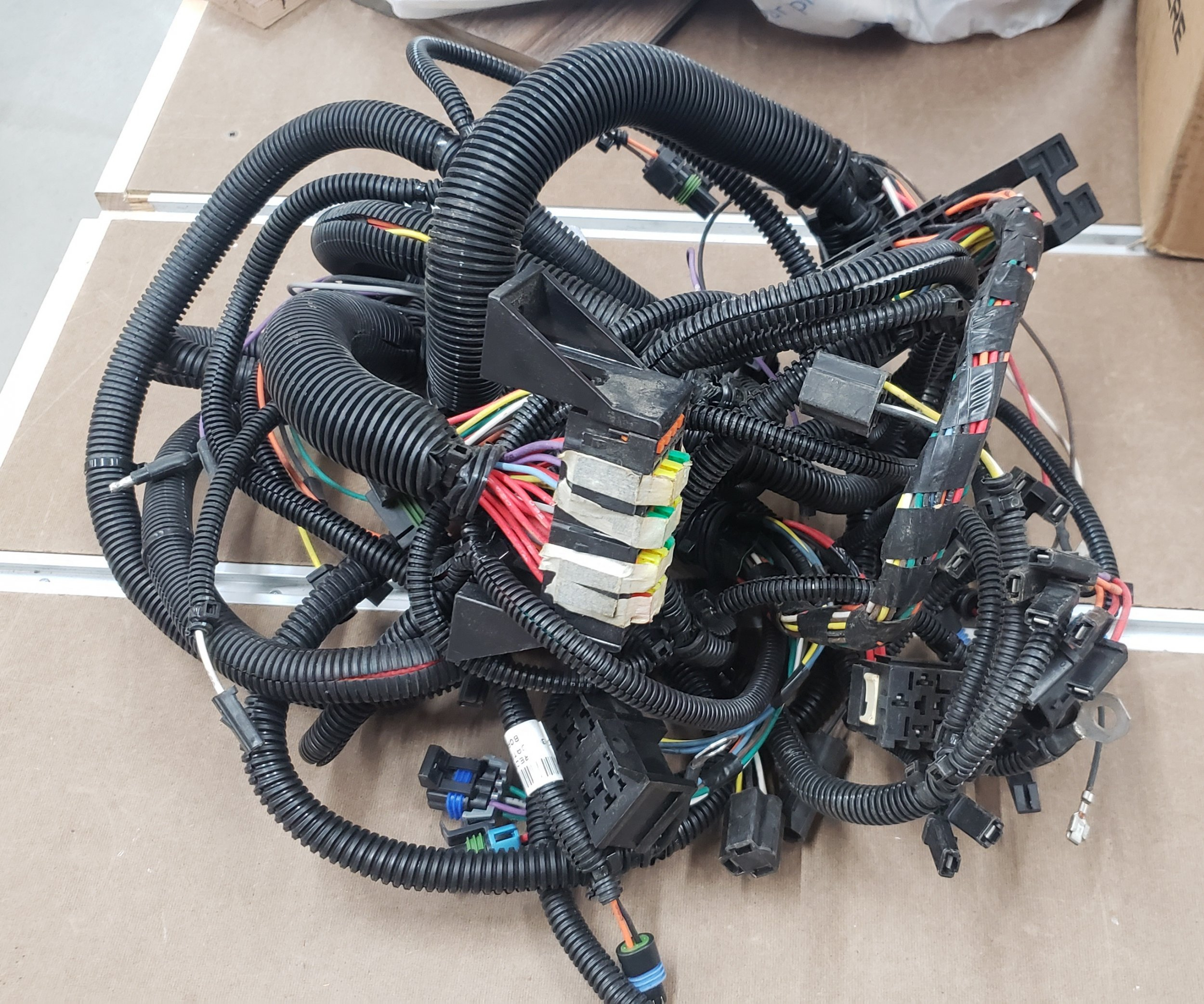

Got it fired up for a few seconds last night. I had just barely enough of the new harness connected to crank and run it. I still have to put the new fuel head and lines on, but I ran it for a second off of what was still in the injection pump and shut it off. I'll get the fuel system done before I do so again.

Still waiting on a couple of adapters to get it running on its own fuel. I also started cleaning up the center console support and other metal pieces that need cleaning/painting.

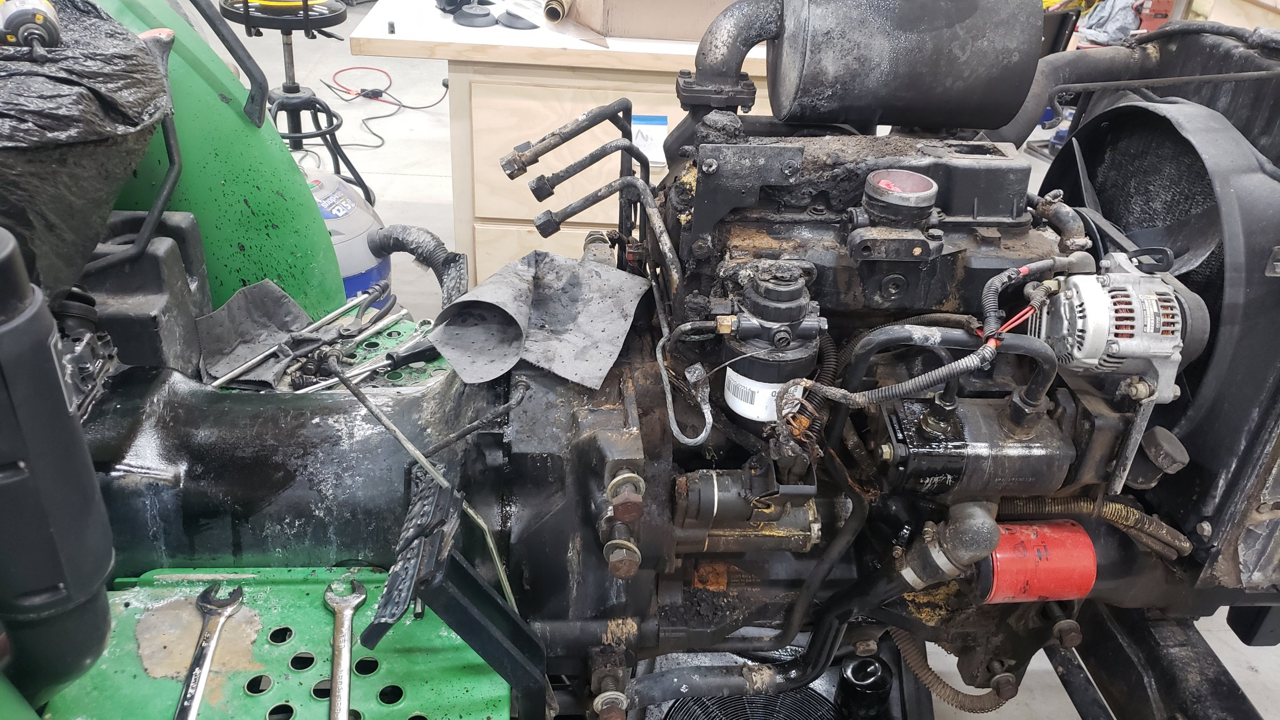

Ugh, thought I had everything I need to run it on its own fuel, but there's a seal on the line to the injector pump that has a seal that is bad. It's not surprising with the heat, but I'm just annoyed at myself for not checking it. I had to pause for a few other things in The house.

Fuel line fixed up and I was able to fire it up under its own fuel and the new cluster works as well. After that, I pulled off the temporarily placed harness and installed the console support. Now I just have to get the wiring harness laid into place properly. Getting the main part in the console support will be the challenge. I only have parts diagrams and manual diagrams for reference.

It's amazing how everything works right away when you have a brand new wiring harness.
