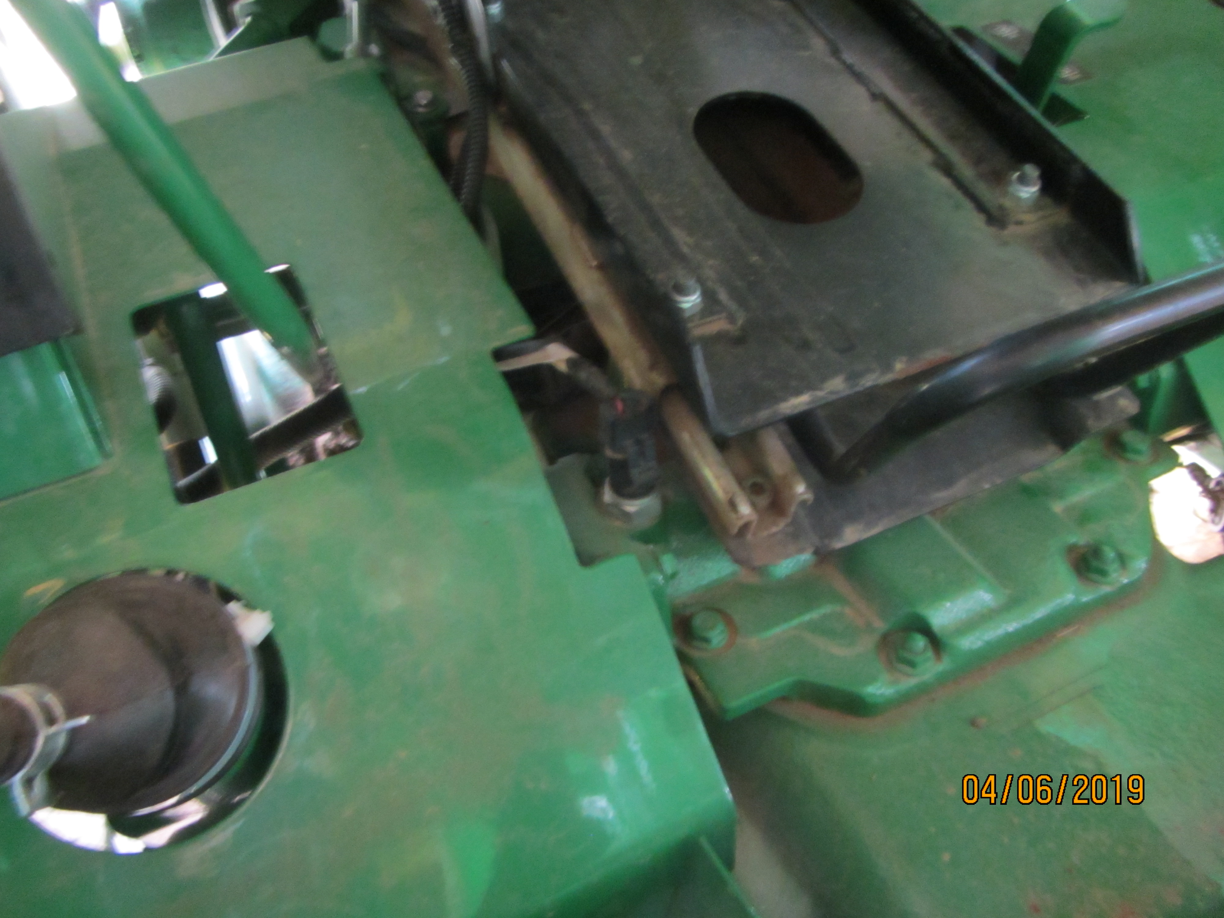

Next to the seat rail?

Is this the neutral sensor?View attachment 599069
I have a different model and mine has a cab, but that looks exactly like the Park safety switch, I believe the only thing it does if it is good and you unplug it is your tractor will start with the gear shift out of park, if it is bad it will blow a 20 amp ignition fuse every time you try to start it , unplug the connector on top of it and see if the tractor starts out of park and you will know for sure. Charlie.
